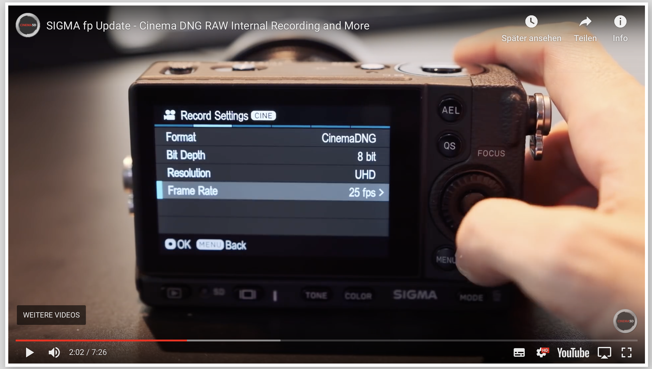

Michael Steiner Posted September 18, 2019 Share Posted September 18, 2019 I so hope this camera will come out as good as it sounds. In the Cinema5D-Interview the Sigma-CEO said they still plan a 2019 release. And since Mr. Smith said they're interested in our feedback: please please please don't wait to long to implement a Log-format for those shoots where the mov-format is sufficient. And please don't limit recordings to 30min. (if the battery even holds that long in this little beast). Link to comment Share on other sites More sharing options...
thephoenix Posted September 18, 2019 Share Posted September 18, 2019 still people tend to forget that 12 but 4k will only be 24fps Link to comment Share on other sites More sharing options...
Michael Steiner Posted September 18, 2019 Share Posted September 18, 2019 42 minutes ago, thephoenix said: still people tend to forget that 12 but 4k will only be 24fps from the cinema5d-video it seems at least 25p will also be possible just not 30p and higher (but it's 8bit not 12bit)... Link to comment Share on other sites More sharing options...
