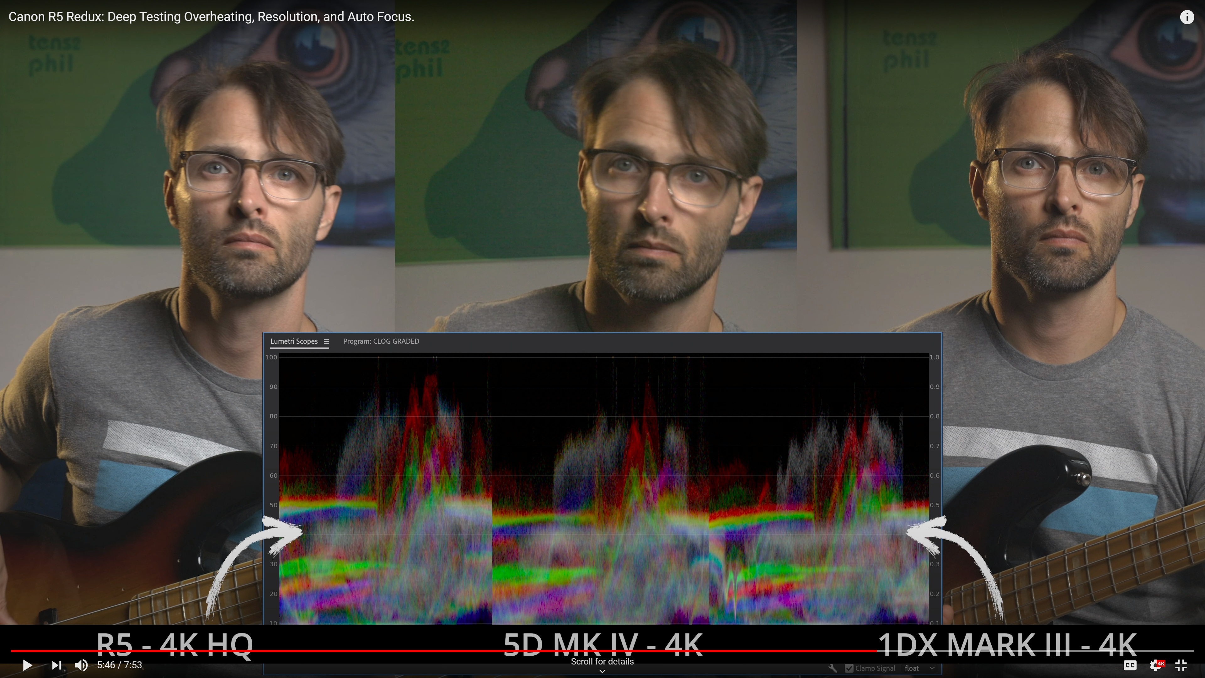

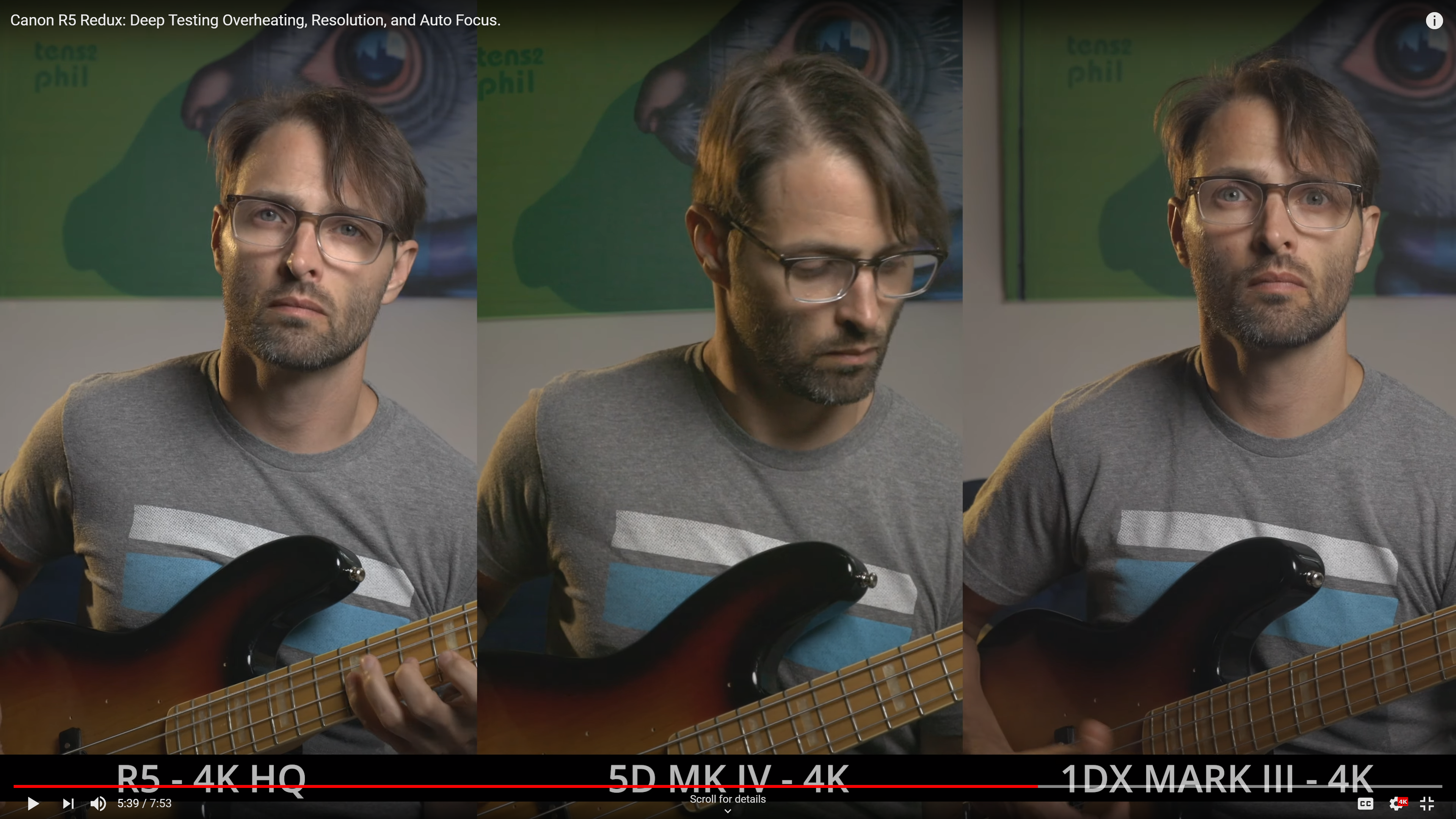

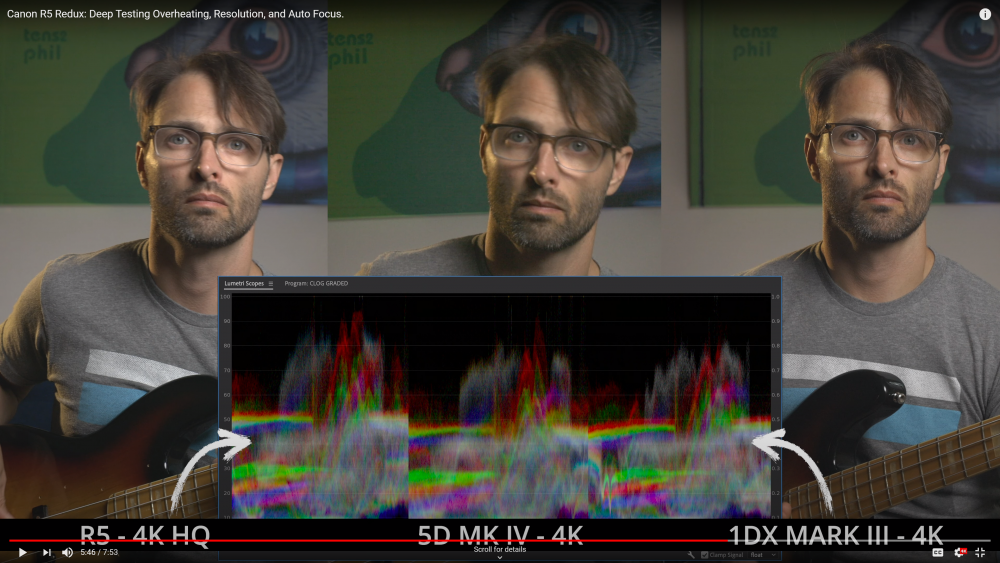

SteveV4D Posted August 10, 2020 Share Posted August 10, 2020 25 minutes ago, hijodeibn said: Same guy made a comparison between 4K and 4KHQ and looks like 4K is totally usable. So I will be waiting for Andrew's feedback about it, we could get several workarounds to use this camera in most of the situations. Some thoughts. Is line skipped from an 8K sensor yielding better 4K than one line skipped from a 6K sensor? Does the AA filter mean the downsampled 4K from 8K isn't as sharp and therefore easily matched? Why is everyone raving how wonderful HQ 4K is, if sharpened line skipped 4K looks as good? To my eyes though, I could see the difference even on my phone. HQ 4K looked naturally detailed, whereas standard looked sharp, which can give that video look. Also he was using his face as a test, which can disguise lack of detail better; he should have tried a landscape view with a whole load of small detail. Or something where moiré would be likely to show. So it feels biased and his over the top reactions were annoying too. As if sharpening a soft image wouldn't be comparable to a detailed image with minimum sharpening. Its not rocket science. Link to comment Share on other sites More sharing options...
hijodeibn Posted August 10, 2020 Share Posted August 10, 2020 2 minutes ago, SteveV4D said: Some thoughts. Is line skipped from an 8K sensor yielding better 4K than one line skipped from a 6K sensor? Does the AA filter mean the downsampled 4K from 8K isn't as sharp and therefore easily matched? Why is everyone raving how wonderful HQ 4K is, if sharpened line skipped 4K looks as good? To my eyes though, I could see the difference even on my phone. HQ 4K looked naturally detailed, whereas standard looked sharp, which can give that video look. Also he was using his face as a test, which can disguise lack of detail better; he should have tried a landscape view with a whole load of small detail. Or something where moiré would be likely to show. So it feels biased and his over the top reactions were annoying too. As if sharpening a soft image wouldn't be comparable to a detailed image with minimum sharpening. Its not rocket science. Agree, his overreactions were really out of the place, we need a trustable review to see if 4K will be usable at the end. Soon we will see it from Andrew so better wait and decide with the facts on the table. Link to comment Share on other sites More sharing options...

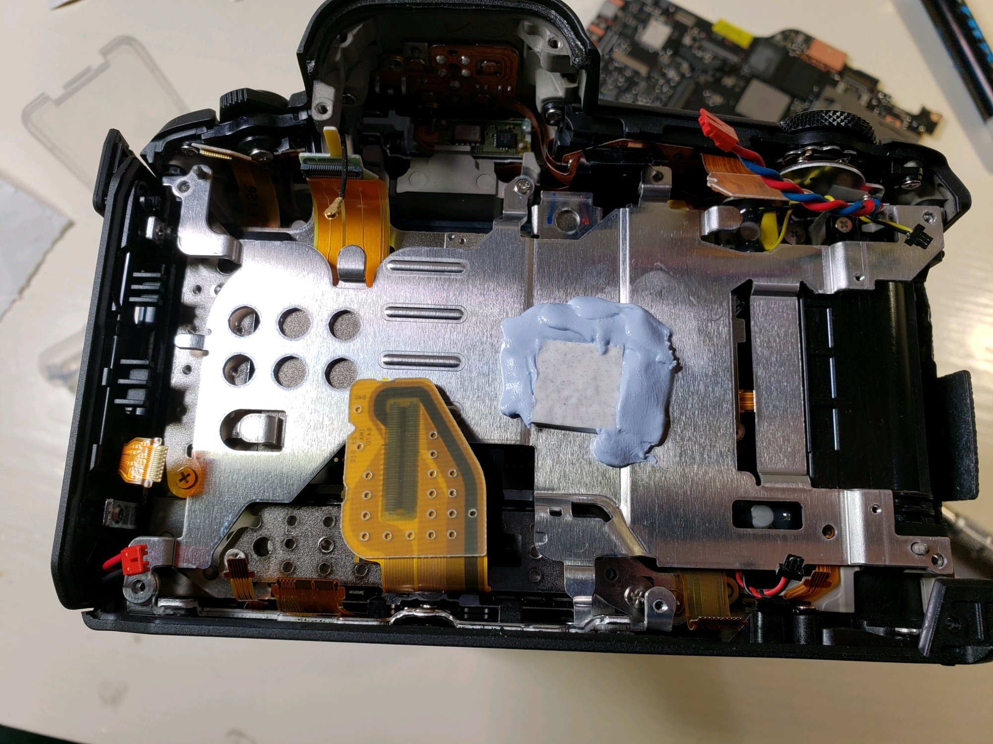

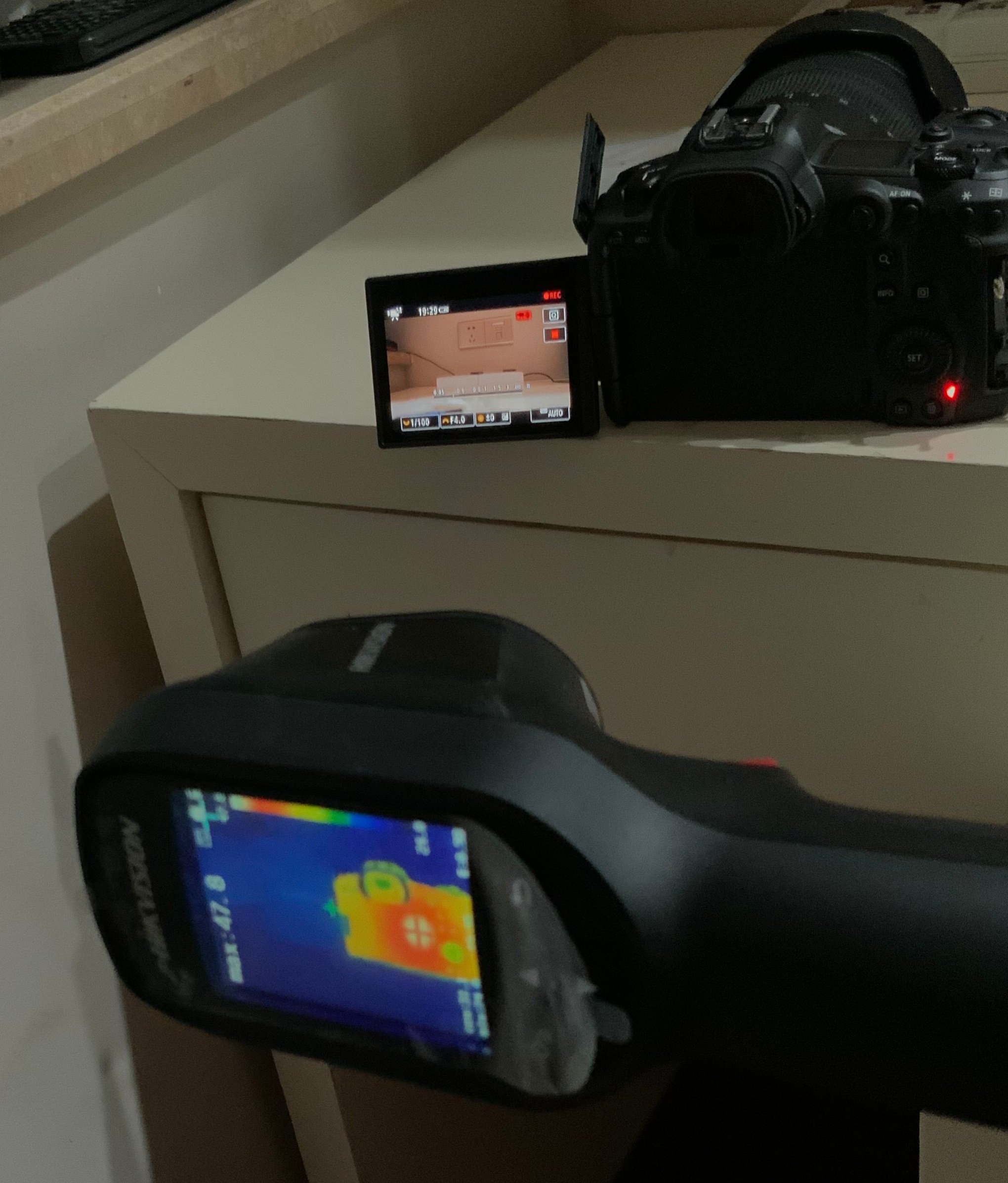

Popular Post androidlad Posted August 10, 2020 Popular Post Share Posted August 10, 2020 This thread details the teardown process, modifications made and some important findings: http://c.tieba.baidu.com/p/6848700307?pn=1 He replaced the two thermal pads that did not fully cover the CPU with a dollop of thermal paste and noticed significantly better and more even heat dissipation. Most important finding: despite the temperature drop and improved heat dissipation, 8K/4K HQ still cut off at 20min mark, suggesting a firmware limit is also in place. zerocool22, Andrew - EOSHD, kaylee and 11 others 13 1 Link to comment Share on other sites More sharing options...
ajay Posted August 10, 2020 Share Posted August 10, 2020 Is there any mention of improved recovery time? That's the other factor. Is the crazy recovery times due to temperature or firmware? If it's firmware, there's no hope other than Canon to fix it. Link to comment Share on other sites More sharing options...
Wild Ranger Posted August 10, 2020 Share Posted August 10, 2020 "It seems as soon as there is a card inserted, an overheating countdown timer starts, but doesn’t apply when an HDMI device is attached and the card removed" 21 minutes ago, androidlad said: Most important finding: despite the temperature drop and improved heat dissipation, 8K/4K HQ still cut off at 20min mark, suggesting a firmware limit is also in place. These get very fishy. I had commented in another post about suspicion and my crazy paraonic theory that the overheating limit is only a limit made by firmware, nobody believed me... Now I believe it more firmly, but we still have to wait for the truth to come out. For me, Canon's credibility is at stake in all of this. Daai, ntblowz and andrgl 3 Link to comment Share on other sites More sharing options...
Administrators Andrew - EOSHD Posted August 10, 2020 Author Administrators Share Posted August 10, 2020 Thanks @androidlad This is the kind of post we need more of. Daai, Geoff_L, zerocool22 and 3 others 6 Link to comment Share on other sites More sharing options...
Leica50mm Posted August 10, 2020 Share Posted August 10, 2020 Looks like an easy fix . newfoundmass 1 Link to comment Share on other sites More sharing options...
