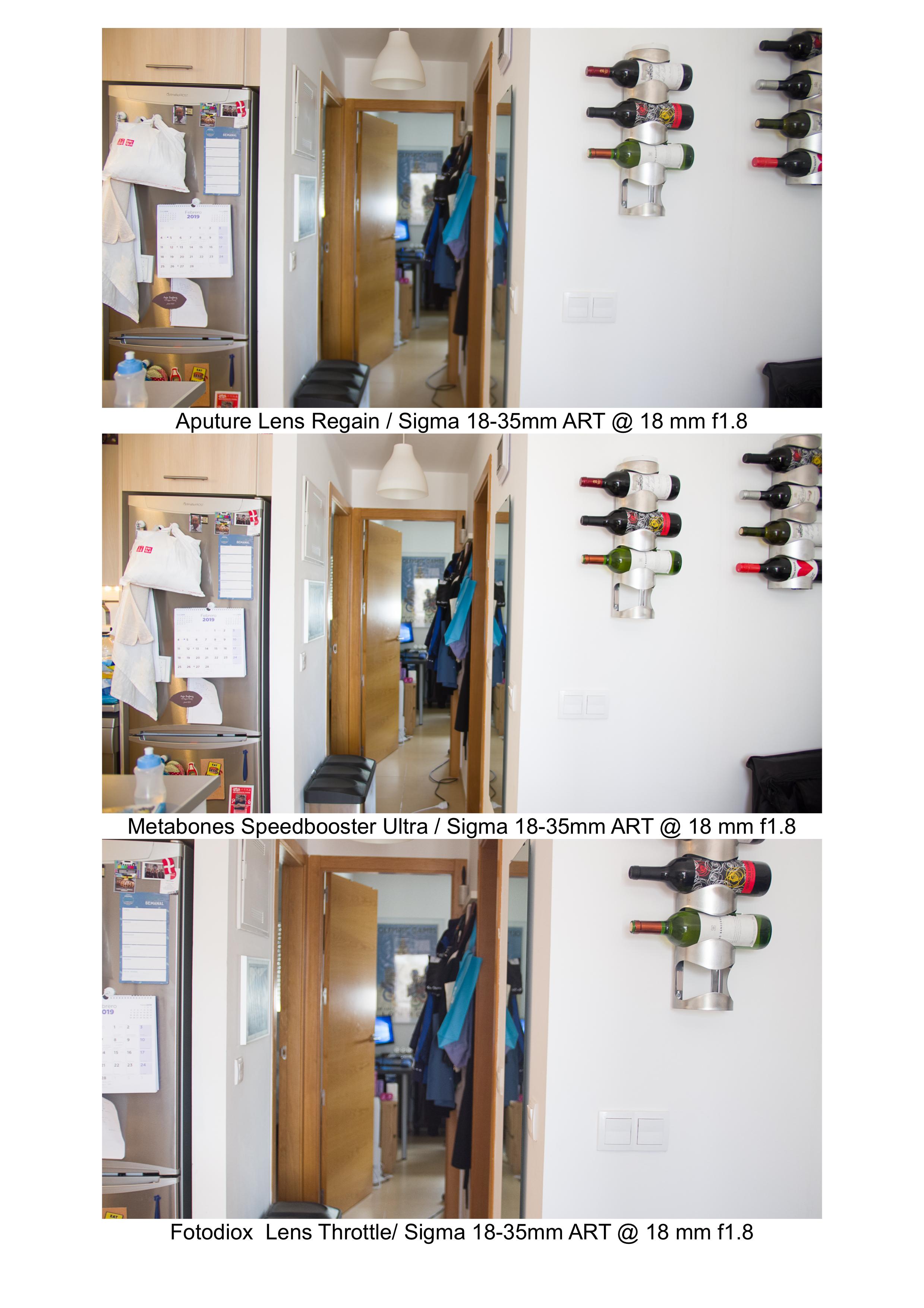

Super Members BTM_Pix Posted February 15, 2019 Super Members Share Posted February 15, 2019 7 hours ago, xzobinx said: I can't ask for more. Please take your time. If it's possible could please you shoot something with white colour? I found white subject seems to suffer the most. OK, a bit quick and dirty but here we are. Slightly complicated by the only non-reducing EF>MFT adapter that I have on hand being a Fotodiox Lens Throttle which always has a certain amount of ND even when set to clear which, coupled with the light advantages of the focal reducers, means a bit of an exposure modification for that one. No big deal really as its only there for reference anyway. I shot this so view that you would have plenty of white wall and with focus set on the wine bottles so you also get some detail into the edge of the frame with white surrounding it and some potentially glowable stuff on the fridge. Obviously the Metabones 0.71x reduction to 0.75x of the Aputure gives a wider FOV but its also got a very slight sharpness edge. The RAW dng files are here for you https://mega.nz/#!x35lUQYI!P8oS55N-z2xvfjzesoSEEsjcIPIt4e-lKGYpUdVO7jsBM4K Focal Reducers.zip xzobinx, deezid, anonim and 2 others 2 3 Link to comment Share on other sites More sharing options...

wyrlyn Posted February 15, 2019 Share Posted February 15, 2019 why there is a shadow noise in the black areas? Link to comment Share on other sites More sharing options...
xzobinx Posted February 15, 2019 Share Posted February 15, 2019 9 hours ago, BTM_Pix said: OK, a bit quick and dirty but here we are. Obviously the Metabones 0.71x reduction to 0.75x of the Aputure gives a wider FOV but its also got a very slight sharpness edge. The RAW dng files are here for you https://mega.nz/#!x35lUQYI!P8oS55N-z2xvfjzesoSEEsjcIPIt4e-lKGYpUdVO7jsBM4K Focal Reducers.zip thank you so much I will have a look at the dng file when I get home. But at first glance I haven't notice any nasty glowing effect like my viltrox Link to comment Share on other sites More sharing options...
Super Members BTM_Pix Posted February 15, 2019 Super Members Share Posted February 15, 2019 3 minutes ago, xzobinx said: thank you so much I will have a look at the dng file when I get home. But at first glance I haven't notice any nasty glowing effect like my viltrox No problem. I've never really done an A/B between the LensRegain and the Metabones as I use them for different things so it was useful for me too Link to comment Share on other sites More sharing options...
Kisaha Posted February 16, 2019 Share Posted February 16, 2019 10 hours ago, BTM_Pix said: No problem. I've never really done an A/B between the LensRegain and the Metabones as I use them for different things so it was useful for me too Is the Metabones noticeably sharper? Maybe the best solution is to have all of 3 options (Regain-Metabones-dumb adapter) for various circumstances, which is a plus - for having the options and a minus - especially for people like me that detest adaptors. Link to comment Share on other sites More sharing options...

Shirozina Posted February 16, 2019 Share Posted February 16, 2019 14 hours ago, wyrlyn said: why there is a shadow noise in the black areas? Plenty of possible reasons; The footage is underexposed, the contrast range of the scene exceeds that DR of the camera, the shadows have been pushed too far in post, it's shot in RAW with no NR applied. Link to comment Share on other sites More sharing options...
Super Members BTM_Pix Posted February 16, 2019 Super Members Share Posted February 16, 2019 3 hours ago, Kisaha said: Is the Metabones noticeably sharper? Maybe the best solution is to have all of 3 options (Regain-Metabones-dumb adapter) for various circumstances, which is a plus - for having the options and a minus - especially for people like me that detest adaptors. I think its fractionally sharper but nothing to write home about. The only problem with dumb adapters with EF lenses is that they are a bit too dumb in the sense you can't control the aperture or power the IS. I'm not sure if there actually is any smart adapters from EF to MFT that aren't also focal reducers? The solution would be to buy the very cheapest smart focal reducer one and take the glass out of it. Kisaha 1 Link to comment Share on other sites More sharing options...
xzobinx Posted February 16, 2019 Share Posted February 16, 2019 54 minutes ago, BTM_Pix said: I think its fractionally sharper but nothing to write home about. The only problem with dumb adapters with EF lenses is that they are a bit too dumb in the sense you can't control the aperture or power the IS. I'm not sure if there actually is any smart adapters from EF to MFT that aren't also focal reducers? The solution would be to buy the very cheapest smart focal reducer one and take the glass out of it. the Viltrox EF-M1 is one such thing. it's a smart adapter without the focal reducer. As per your solution, I tried to remove the focal reducer optic from my Viltrox EF-M2 once and I could not focus my 18-35 at all. The minimum focus distance seems to be pushed to really far away. I have not figured out the reason why. BTM_Pix and Kisaha 2 Link to comment Share on other sites More sharing options...
Kisaha Posted February 16, 2019 Share Posted February 16, 2019 30 minutes ago, xzobinx said: the Viltrox EF-M1 is one such thing. it's a smart adapter without the focal reducer. As per your solution, I tried to remove the focal reducer optic from my Viltrox EF-M2 once and I could not focus my 18-35 at all. The minimum focus distance seems to be pushed to really far away. I have not figured out the reason why. Οκ. So one needs the Regain/Metabones/Viltrox M1. So one zoom, changing the adapters, could practically become 3 different ones. That is not a bad option to have, considering how cheap the Regain/Viltrox adapters are. I mean, I already have bought the Regain without even having the camera yet! I am in the market for a camera system since Samsung abandoned us. I am seriously considering my options here, and I seriously can not justify paying FS5/FS7/C200/C300/EVA/UMP money, when the Pocket offers all that I need for a portion of the cost. My only issue with all these smaller cameras is the internal ND of course, but should I pay 3 and 4 and 5 and 6 and 7 times the money for the convenience of i-ND and 1 or 2 more advantages? With the likes of P4K/X-T3/GH5S/Z6 a dedicated video camera as a solution seems less appealing to me. The price is not justifiable anymore. The market is changing so quickly now.. Just thinking out loud now! Link to comment Share on other sites More sharing options...

Shirozina Posted February 17, 2019 Share Posted February 17, 2019 20 hours ago, BTM_Pix said: I'm not sure if there actually is any smart adapters from EF to MFT that aren't also focal reducers? The solution would be to buy the very cheapest smart focal reducer one and take the glass out of it. Metabones and Viltrox make non focal reducer EF-MFT smart adapters. Removing the optics from a focal reducer adapter won't work as they are different thicknesses. Link to comment Share on other sites More sharing options...
xzobinx Posted February 17, 2019 Share Posted February 17, 2019 47 minutes ago, Shirozina said: Metabones and Viltrox make non focal reducer EF-MFT smart adapters. Removing the optics from a focal reducer adapter won't work as they are different thicknesses. my guess is the same. the principal is similar to how adding extension tube gives your lens marco capability. I've just bought some marco extension tube to play around with. Link to comment Share on other sites More sharing options...
Super Members BTM_Pix Posted February 17, 2019 Super Members Share Posted February 17, 2019 1 hour ago, Shirozina said: Metabones and Viltrox make non focal reducer EF-MFT smart adapters. Removing the optics from a focal reducer adapter won't work as they are different thicknesses. As I said, I wasn't aware that anyone made one so thanks to you and @xzobinx for the clarification. Link to comment Share on other sites More sharing options...
