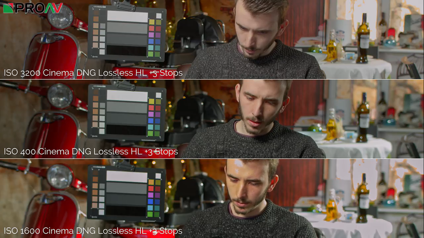

4 hours ago, Emanuel said:
Indeed... nuff said, Dual ISO talks : -)
This is a stupid test. DR goes down ( quite significantly) as you ramp up gain from zero ( Ramp up ISO from base) so any overexposure is going to hit highlight clipping faster - DOH!
Who in any semi-competent use of this or any camera is going to overexpose by 3 stops anyway and expect to recover highlights esp highlights in skintones? In a real world situation the clipping highlights on skintones would have been obvious from the zebras or scopes so the user would have brought the exposure down.
As ISO gain reduces DR the real world test would be a more ETTR based exposure method ( esp with RAW) and the differences between cameras and/ or ISO's would be to look at the shadow recovery.
Repeat - this is not a test that in anyway represents a real world situation to anyone competent or even remotely aware of how to expose footage correctly.
Due to the DR limitations when you move away from base ISO I just avoid it as much as possible - increase you lighting or open up the aperture or use a faster lens. The P4k has very respectable DR at base ISO but start to deviate from it and you are quickly into the kind of DR you get with a mobile phone!
Well with this thing having Dual ISO some of those thoughts are out the window. 3200 is 3 stops over base and it is nearly as good as 400. Whole new beast this camera is to the average person. Going to take a lot of trial and error to figure all of it out.
I understand your point but, I don't find this test useless as matter of fact. ETTR, that is, expose to the right is the way to go with this camera.
Only if what you're shooting is unconnected street or nature scenes and you're using it like a stills camera.  Otherwise, the best practice for this camera is to expose for the subject, as you would with any cinema camera.
No complaints about, circumstances vary. It will also depend on your shooting style and last but not least, subjects to shoot for sure. Obviously. But, if you want to protect your highlights, you'll have enough DR room from your clean shadows to go on ETTR : -)
No the best practice is to relate the brightness range of your scene to DR of the camera and make any necessary compromises to areas that fall outside it with regards to highlight clipping and /or noise floor. You can use ETTR, histogram, false colour etc or all of them. ETTR or 'exposing for the subject' are not correct for every scenario.
