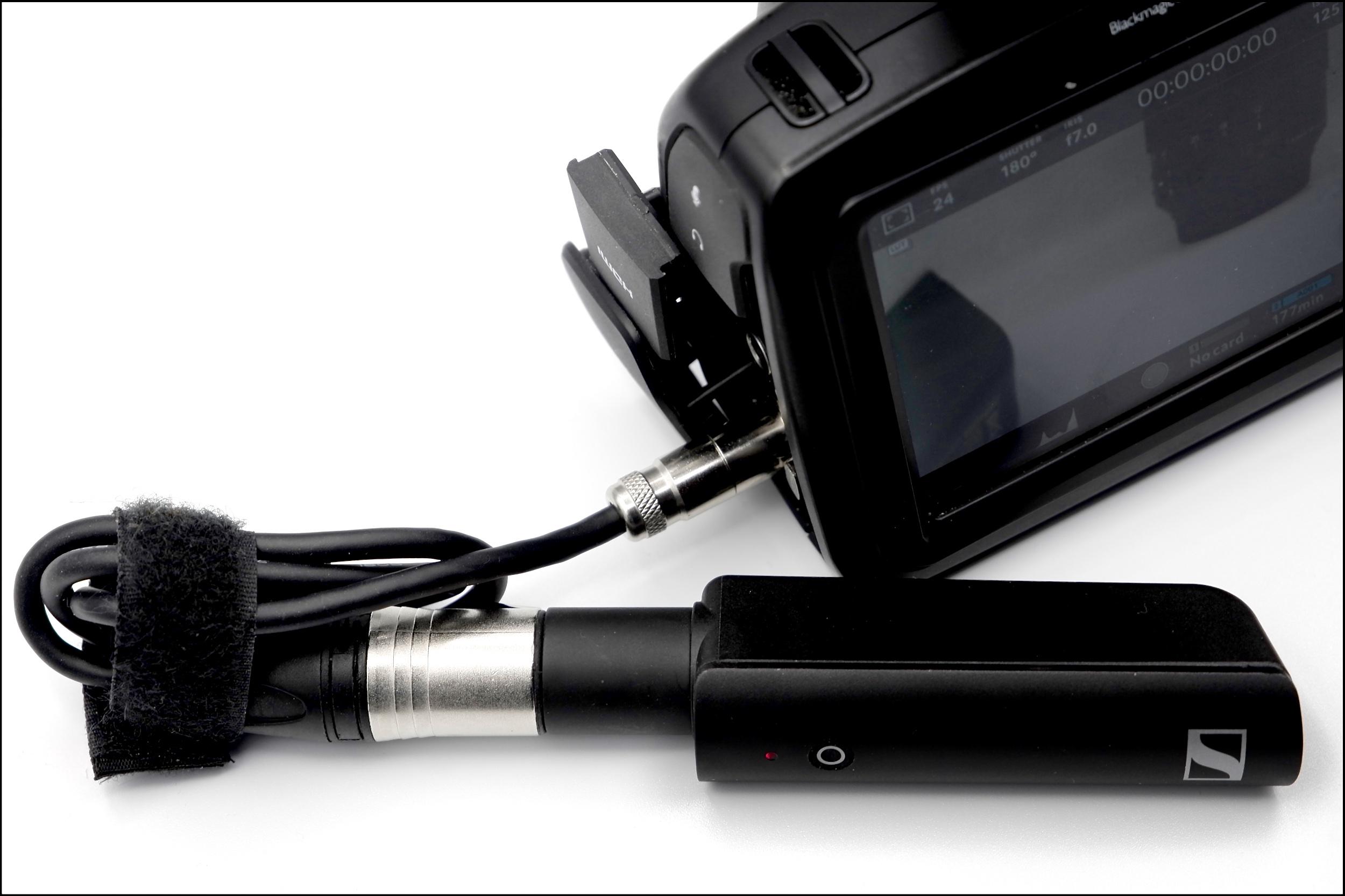

Finally got around to buying and testing these mini-XLR adapters.
They are the official Blackmagic ones that they sell for the VideoAssist but obviously work fine with the Pocket4K as well.
Decent build quality, very practical length of 40cm and they come in a pack of 2 for £30 so a good value as well.
More to the point they are actually available, as mini-XLR to XLR is generally still a tricky cable to track down.
https://cvp.com/product/blackmagic_bmd-hyperdaxlrmini2
+1
These are the ones I have spoted myself. I have a pair for my Zoom F8, but I want to have backupa anyway.
How do they sound? I remember people complaining for weak signal and/or hiss and stuff.
Have you tried a phantomed power mic or any kind of mic?
Well its difficult to say anything definitive about noise and signal loss really as I can't A/B them against anything as these are the only ones I have and the Pocket4K is the only piece of equipment I have that has mini XLR inputs.
Yes, have tried with phantom powered and dynamic mic.
I use the BM mini to XLR cable with phantom powered boom mic ...
Signal is very strong ... if you adjust levels without hiss and no appreciable noise.
Adequate for the weekly blog that I record ... I no longer use an external recorder.
The camera continues to address a wide variety of needs ... it is very well designed and implemented.
I've been happy with the audio through XLR on the P4k as well.
