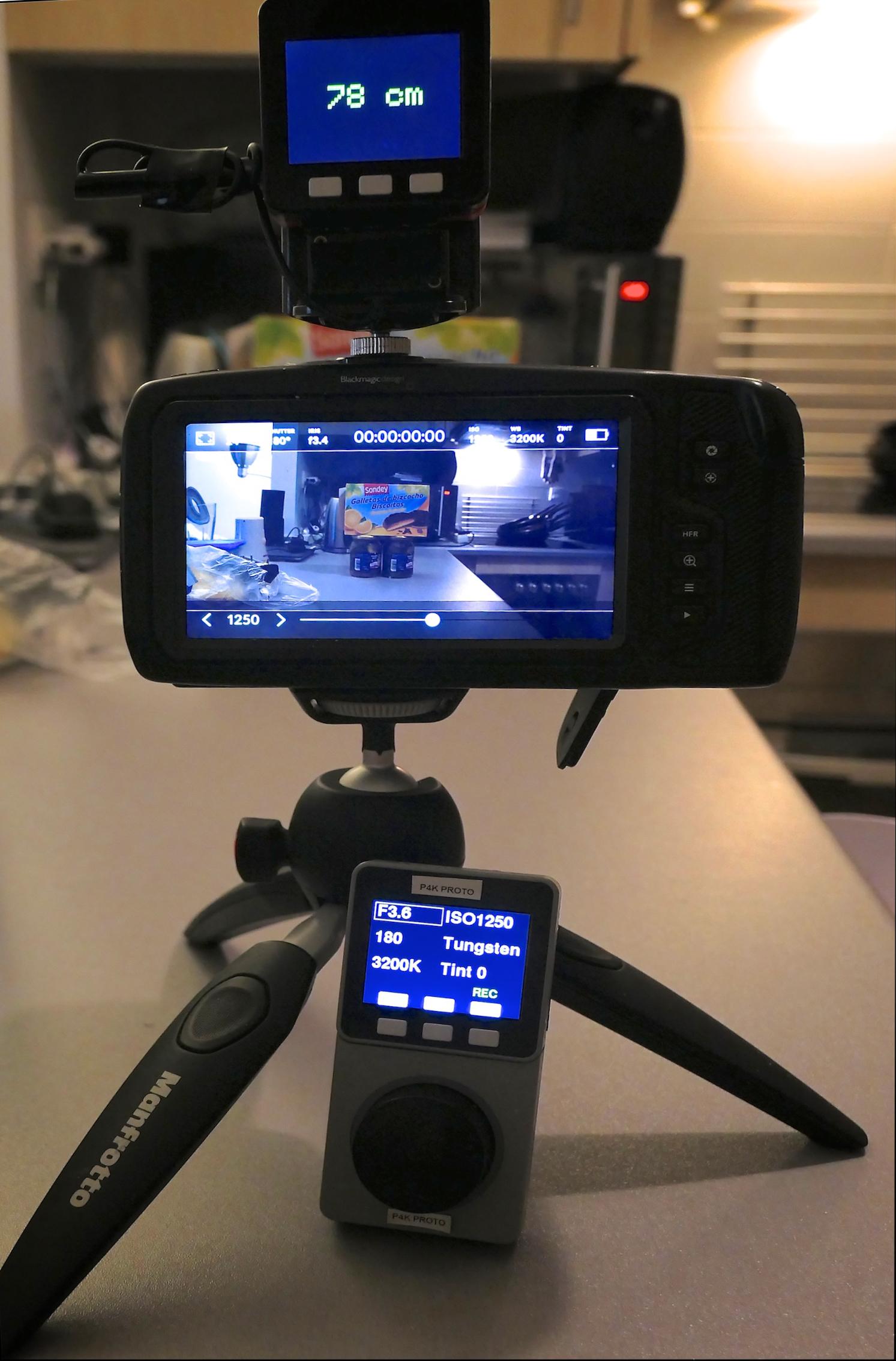

Super Members BTM_Pix Posted July 30, 2019 Super Members Share Posted July 30, 2019 2 hours ago, Kisaha said: That @BTM_Pix guy is getting lazy. He runs only 49 promised projects simultaneously, a hundrend we do not know yet, and another hundrend projects we will never know about! Trust me, its the hundred and first project that you don't know about that will really blow your mind. Meanwhile, unfinished symphony number 49 has had a bit of an upgrade since it was first unveiled last week. Sensor is now integrated into a separate unit that sends the measured distance wirelessly over BLE to the main focus controller which then processes it and sends it on to the camera. And also has a measurement display which will come in useful at a later date........ kye and Kisaha 2 Link to comment Share on other sites More sharing options...
drm Posted July 30, 2019 Share Posted July 30, 2019 48 minutes ago, BTM_Pix said: Sensor is now integrated into a separate unit that sends the measured distance wirelessly over BLE to the main focus controller which then processes it and sends it on to the camera. And also has a measurement display which will come in useful at a later date. Great work! How much lag is there in transmitting like that? I suspect just a few MS, but just wondering. BTM_Pix 1 Link to comment Share on other sites More sharing options...
Super Members BTM_Pix Posted July 30, 2019 Super Members Share Posted July 30, 2019 2 minutes ago, drm said: Great work! How much lag is there in transmitting like that? I suspect just a few MS, but just wondering. Its around 15-20ms for the whole trip. Link to comment Share on other sites More sharing options...
