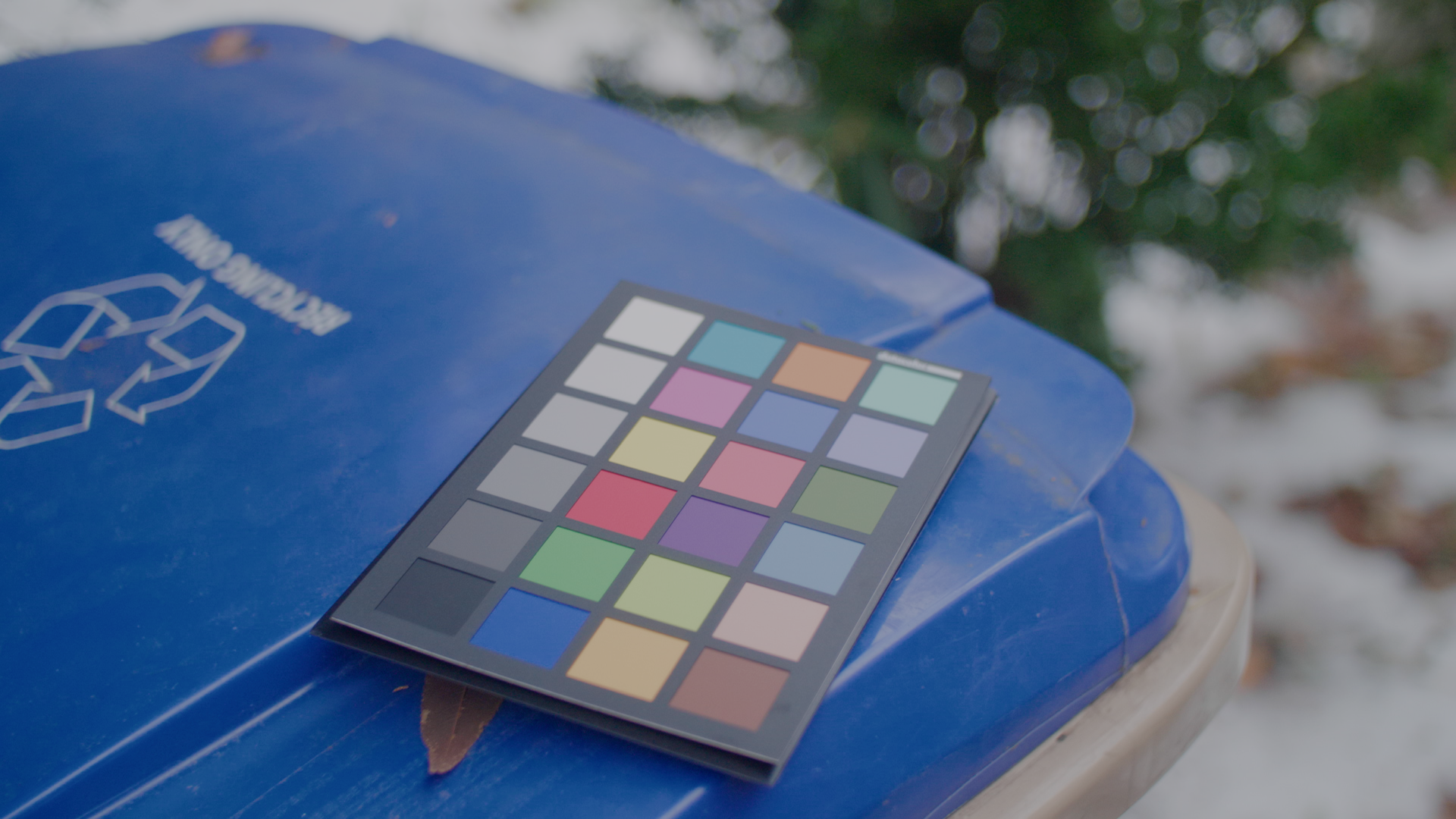

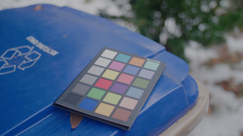

Sage Posted June 16, 2019 Author Share Posted June 16, 2019 36 minutes ago, 4nund said: Hey @Sage Bought GHalex a couple of months ago, really enjoying it so far! Got two questions: 1. Is there any difference between filming in Vlog or filming in CineD and using the pre LUT? 2. Do you have any reccomendations on adjusting whitebalance in FCPX? There is no difference under reference light (halogen or sunlight+FSNDs), but under leds/cfls there will be some degree of variance, depending on the peculiarity of the light spectrum. For an example of how they compare, here is VLog (400) and Cine-D (200) both converted to Main: Here is interim guidance for Fcpx: - To neutralize WB, (before everything else) use the temp/tint controls in the Color Wheels in conjunction with the Vectorscope. Avoid the Basic WB eyedropper (more than just WB). - *For very bright or dark exposure, place the luma here, ahead of the conversion. - Then, if you are shooting to VLog, you only need one Custom LUT Utility (listed under FCPX effects), with Main, Soft, or Linear loaded. For HLG or Cine-D, use 2 Custom Lut Utilities, with the PRE first (if HLG or Cine-D), and Main, Soft, or Linear second. *Avoid the MotionFX mLut plug-in* (incorrect color with PRE combo) - After those, place the luma with your preferred luma tools in FCPX. - The same basic principles and order of operation in Resolve and Premiere apply to FCPX Link to comment Share on other sites More sharing options...
