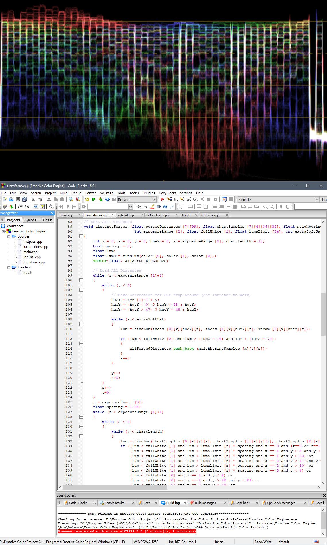

EC was made by filming a large number of color samples with both cameras, and then extracting coordinate data from those samples and supplying that data to a my own c++ program. As channel clipping occurs, the program attempts to straighten hue lines to follow that of the higher DR camera. There is a point at which those hue lines merge during clipping, such that clipped red is identical to yellow, for example. When these regions are detected,  they are reduced to near grayscale data:
Link to post
Oh yes, this is the kind of detail that excites me :)  Keep them coming. Too bad I can't scroll that still image ?
I've chosen not to deal with hue shifts in my own conversions, but in your situation where one camera has way more DR than the other, it seems like something that can't be ignored.

For the c++, there is a problem I'm trying to solve. Giant 4D arrays aren't supposed to be declared on the stack like this, but I haven't figured out how to conveniently pass them to functions any other way yet (vector pointer 'arrays' can only be 2D etc)
Wish I could help with C++. I use Matlab for my stuff and it's pretty convenient. If I didn't have access to it I think I would use Python.
It's been a long time for me, but I remember just passing a pointer and then navigating the data structure as required.  Oh the days of writing double-linked-list databases :)
The part that I'm stuck on is how one would navigate a multi dimensional array from the pointer. For example, is there any way to do something like array * [3][14][7][12]?
Someday, I want to learn Python. I've got to master c++ first though. I just bought Stroustrup's Tour of c++ book

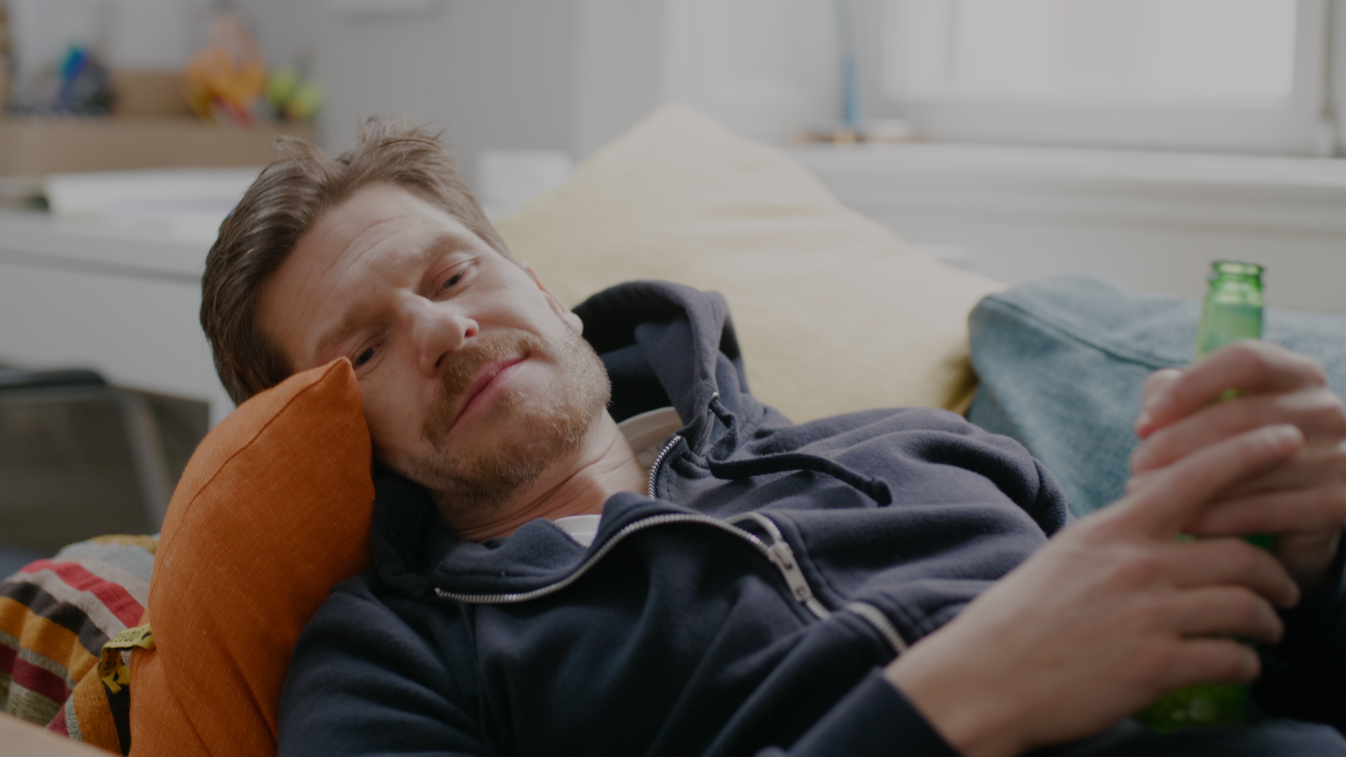

Shot this using GHa for CineD with my G9. Works quite well after some exposure adjustments. Had to bring down the highlights quite a bit since I am more used to ETTR. Doesnt look as good as other examples within this thread, but I currently dont use any diffusion at all.
Stunning! Wouldn't have thought a G9 would look so good, like no G9 I've seen :)

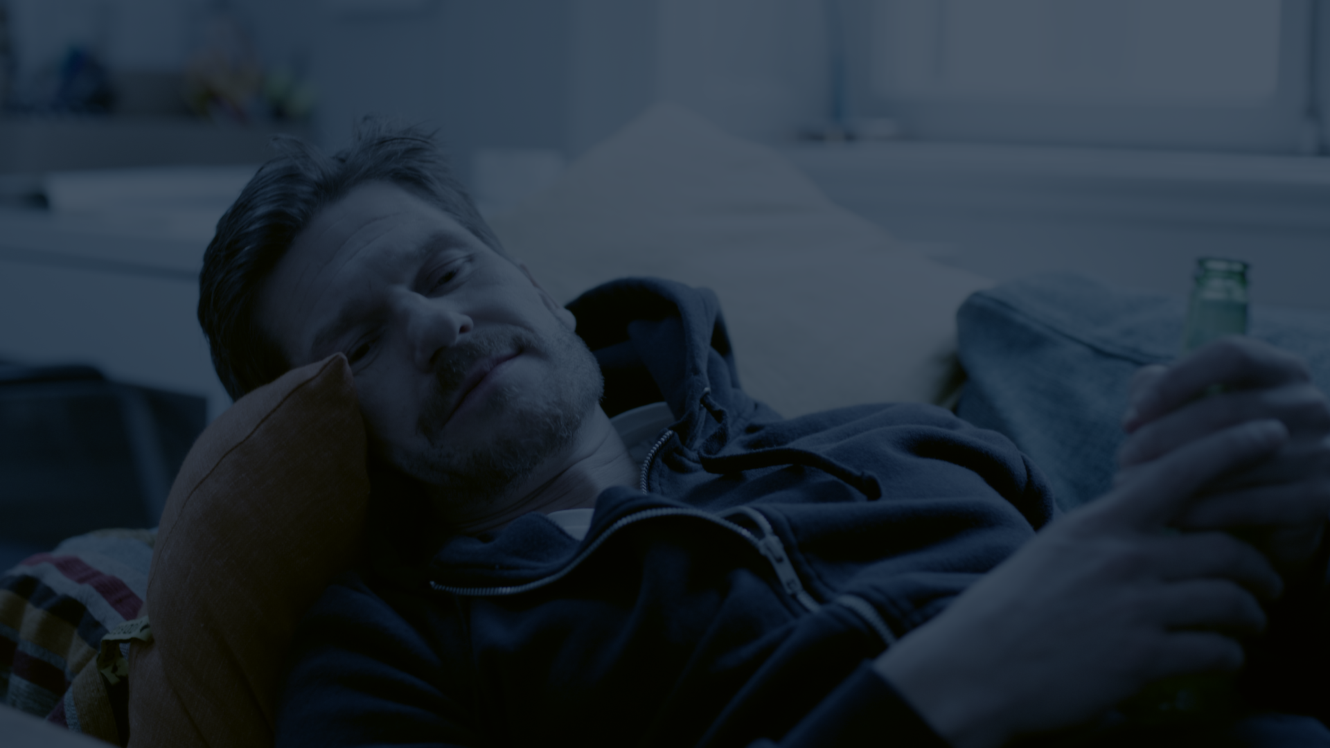

Thanks Sage. I got a question about exposing with CineD. You write:
Quote
"Skin tone should fall roughly between 40 and 55 IRE (HLG 26-55, Cine-D 28-57). Avoid allowing skin tone below 40, or above 60 (HLG 66, Cine-D 72). The rolloff occurs above 65 (HLG 77, Cine-D 84) - this is for over-bright elements."
So what I do is setting my Zebra to 55% and expose for the skintones - secondary I check whether the scene wouldnt be completely blown out. Is this somewhat correct or am I missing something?

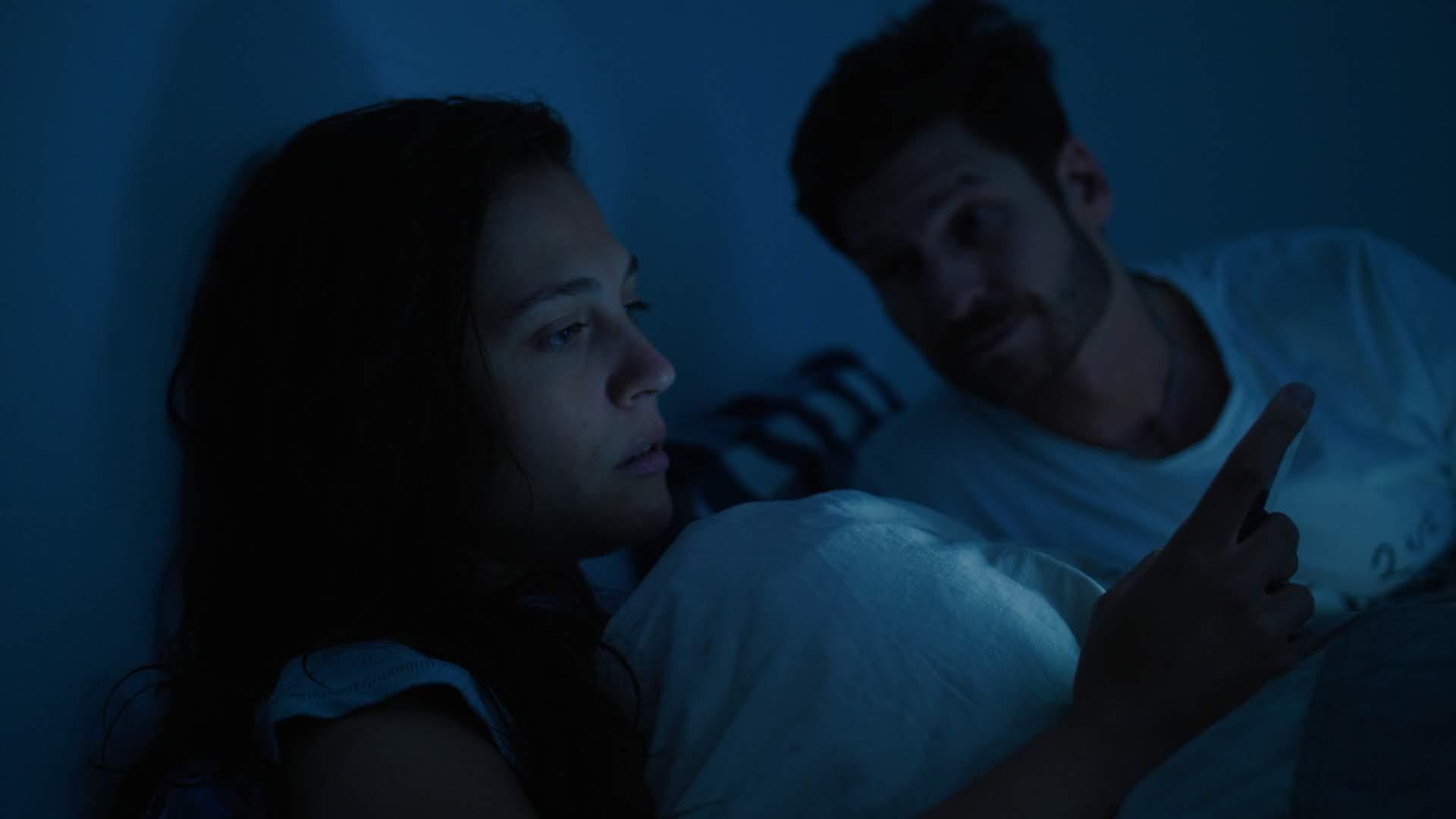

On 3/21/2019 at 6:19 PM, RCV said:
Man! Really great work!!  Im interested in this particular frame! What was the white balance? Is the Blue hue post color work? If so what version of the lut did you use as base?
Thanks! Actually I just ignore a lot of the stuff that Sage writes in the white paper. For example here I had white balance at something like 4000 and a light bulb with 6000k WB, nothing is done to it other than using the excellent GhA-LUT. Mostly this decision is because I seldom get the benefit of grading the things I shoot, and therefore I try to do as many decisions as possible in camera so that the people in post don't do their own version of it.
I'm happy that you took this frame specifically because it is lit only with a cheap e27 LED light bulb from the hardware store for something like 8€ and their phone screens that I made them turn up to maximum. This whole short was done in like 6 hours and I went with a lighting style that was super simple, quite fun to try to figure out different looks in the same room in a short amount of time!
On 3/20/2019 at 3:11 AM, Sage said:
They look great. Could you share the original HLG still of this one?
Thanks! Here you go! I remember now that I added some contrast as well after your LUT. But that's all.
Nice, I recently shot a similar scene with a cheap Neewer LED (blue gelled) bounced off the ceiling and an LED stick inside the window. Face was just lit with the phone! Loving the GH5S, this was shot at 5000 ISO. Grading started with GHAlex and then a bunch of other adjustments as you can see. ?
Sure; from what I've seen, the G7 had a notably higher gamma curve than the GH5 in Cine-D, all things being the same. I corrected this with a hue-locked downward gamma shift in advance of the conversion. I don't know if this is the same for the G9, but your description of working with it seems to suggest this may be the case. Your results are quite good. There were just a few points of rougher rolloff that I would expect from a reference GH5 pipeline.

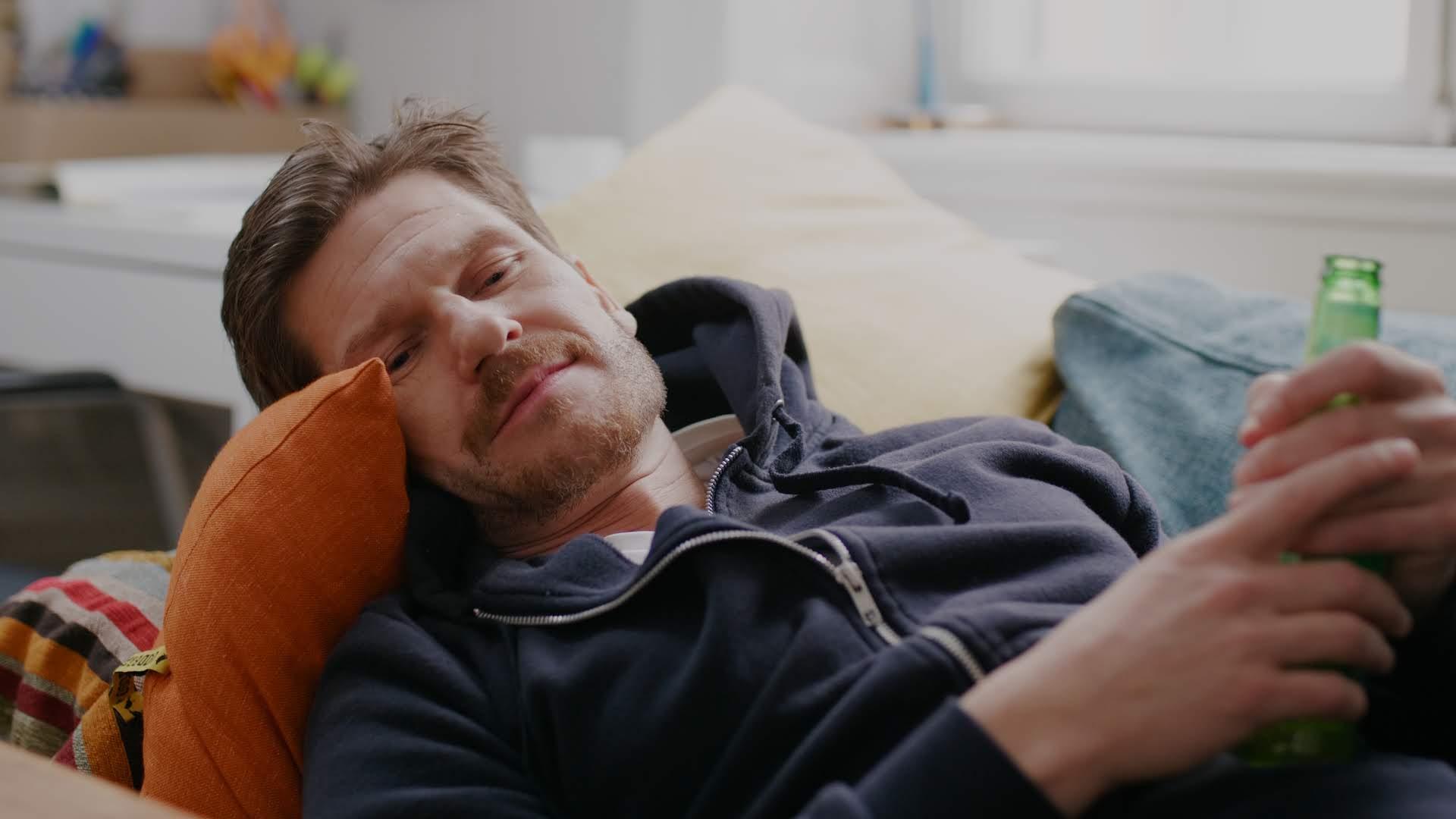

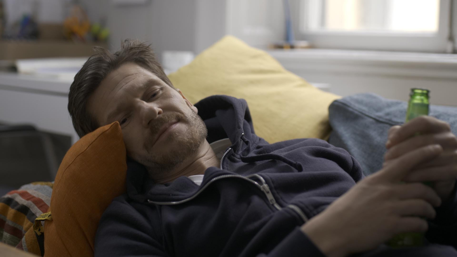

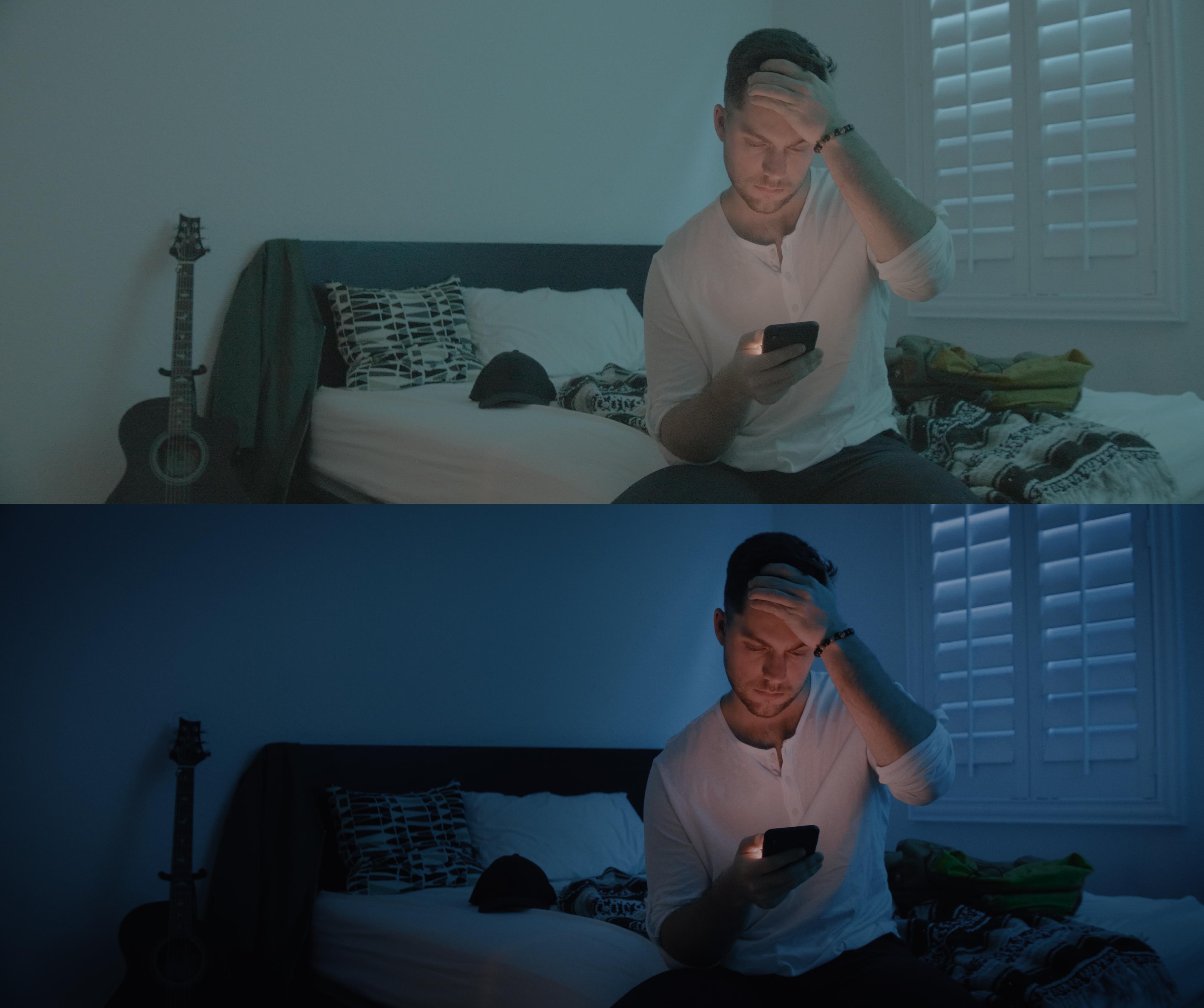

I'd recommend neutralizing the WB ahead of everything (even the Pre now), and then restoring the cast after everything. This will allow 'correct', clean Arri color underneath, and is the optimal route.
I took the dpx and did a slight initial WB from the white window frame in advance of the Pre, and then followed the conversion with a slight luminance drop to conform to day skintone. It was well shot:
By way of a silly example, here is a 'blue restoration':
