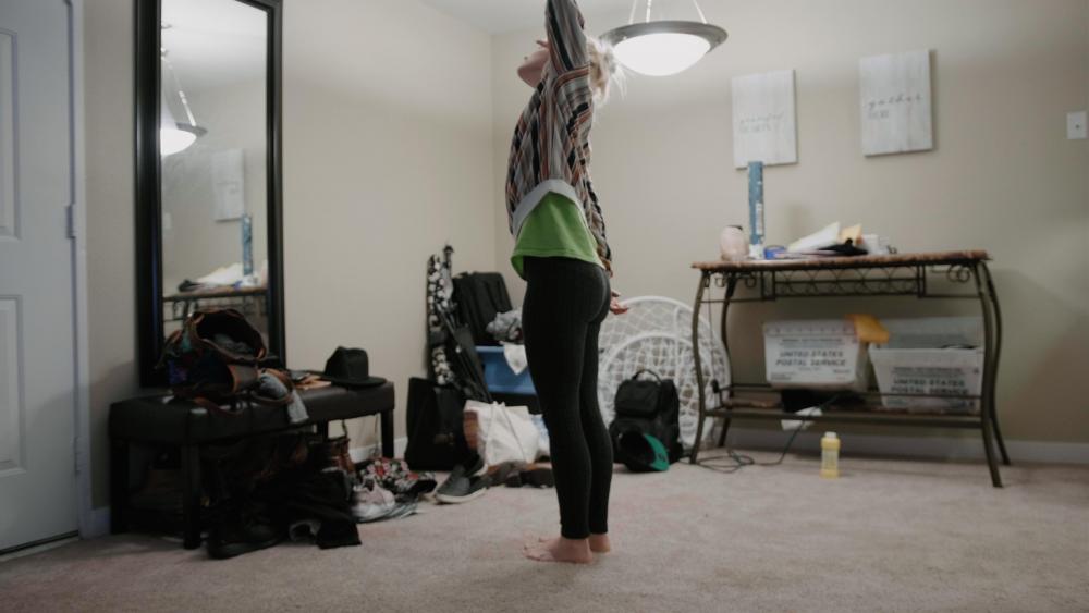

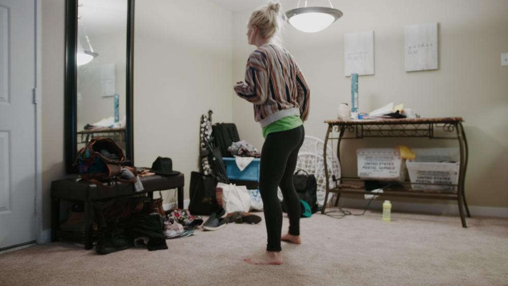

That would be cool. Is there a workaround for now to get a general feel of what it would look like (with the current GH5 version? Basically I'm not sure how to go about turning Blackmagic Film into Vlog). I'm sure the P4K is a better video camera than the Fujis, but I also do stills and if I can get 90% to the P4K without having to have 2 sets of lenses/UIs/batteries/etc. I definitely wouldn't mind.
Couple screenshots as well (from Prores Proxy files nonetheless). Color and contrast is off from what I'm seeing in resolve idk why (they are slightly more contrasty, more saturated, a little warmer IRL).

Those are really impressive. The last time I looked into the idea of an interim solution for the P4K was for Eugenia Loli (she is the one who got me into cameras in 2008, on HV20.com; EC probably wouldn't exist without her). From what I saw, there was only a transform for the original Pocket; the P4K (cs4) wasn't yet supported. Though - you won't have to wait long for P4K support methinks.

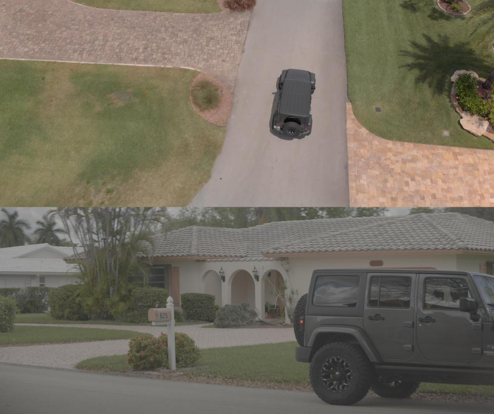

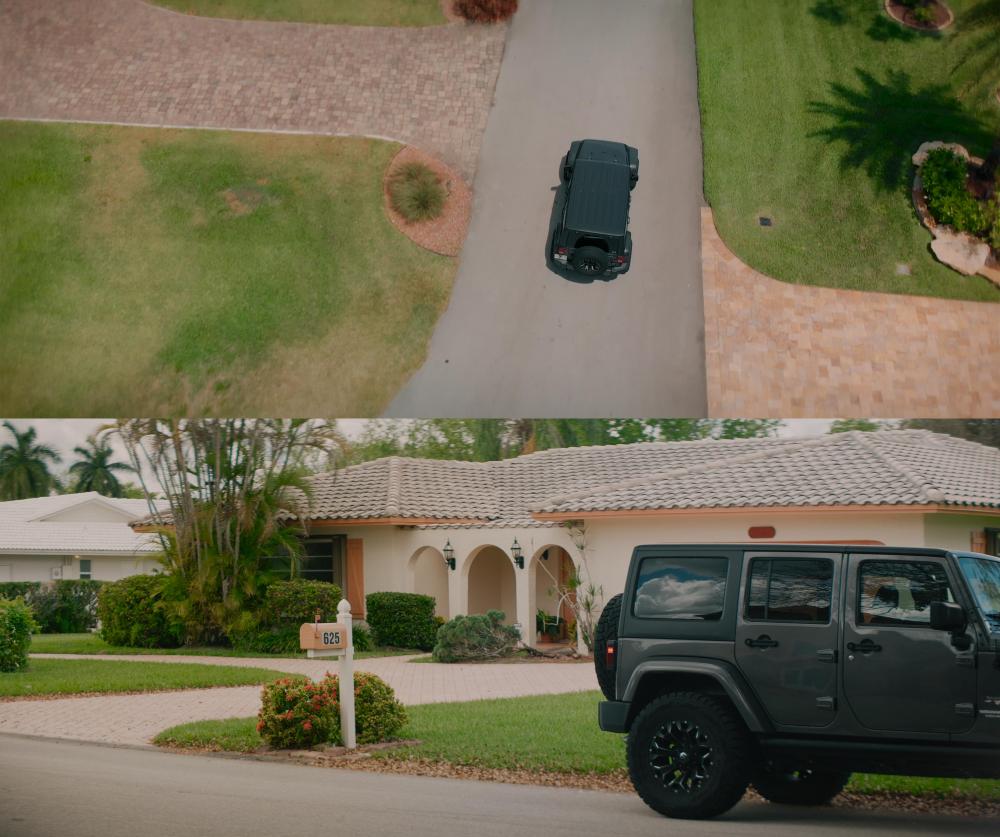

Here's a fun one. Using GHAlex on Mavic Air D-Cinelike to match GH5S V-Log. ? These clips were actually shot on different days too.
Ah very nice
