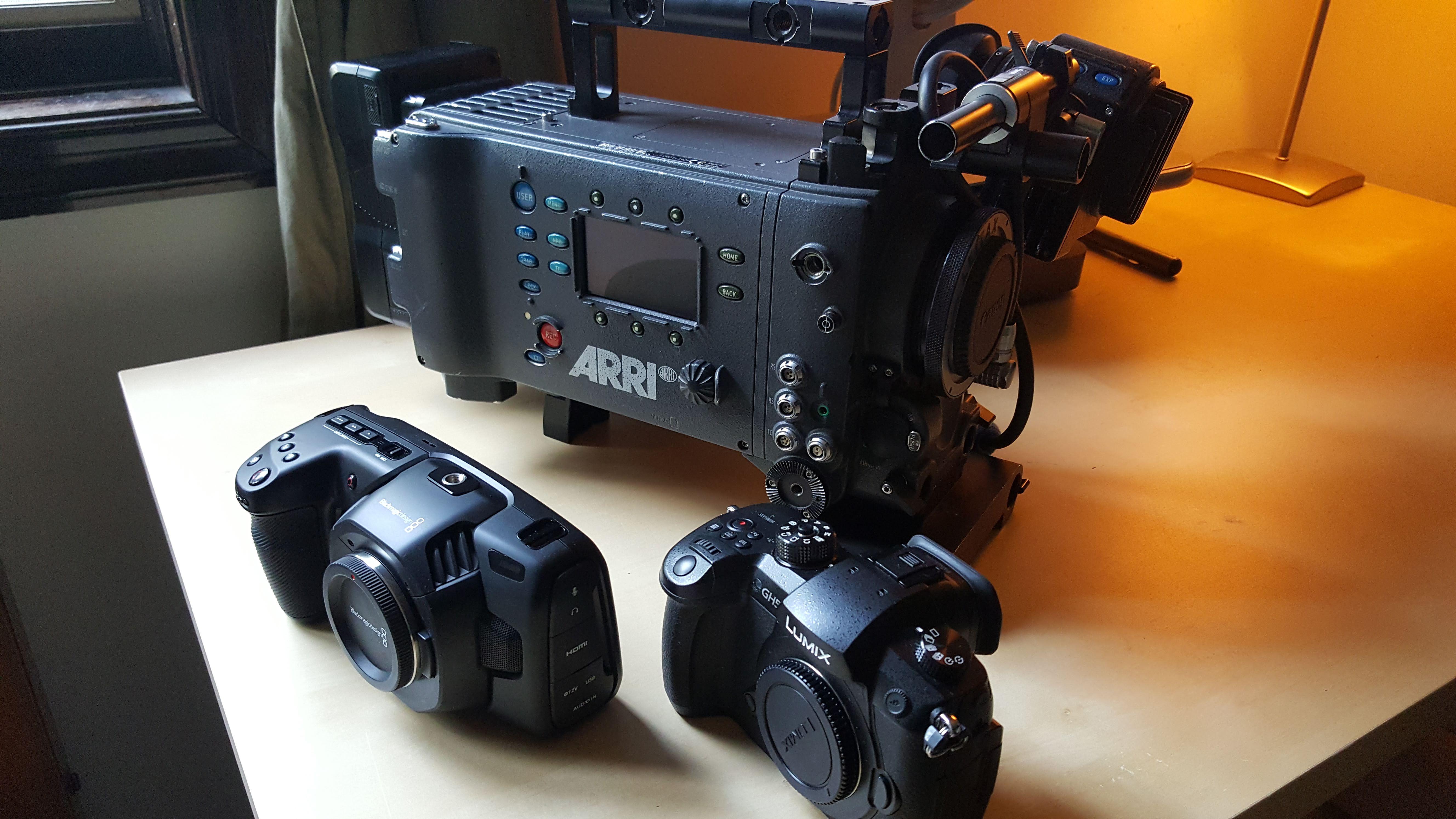

Sage Posted May 13, 2019 Author Share Posted May 13, 2019 5 hours ago, deezid said: looks good. Already received your Pocket 4K? Figured out quite a lot dealing with these nasty red and blue highlights... Yes, that's the one above. Fortunately, the gamut situation won't be as tricky as I thought, as before I was playing with the Ursa footage, which rises above 1.0 floating. That case will require a special Lut command to avoid red clipping in 709 deezid 1 Link to comment Share on other sites More sharing options...

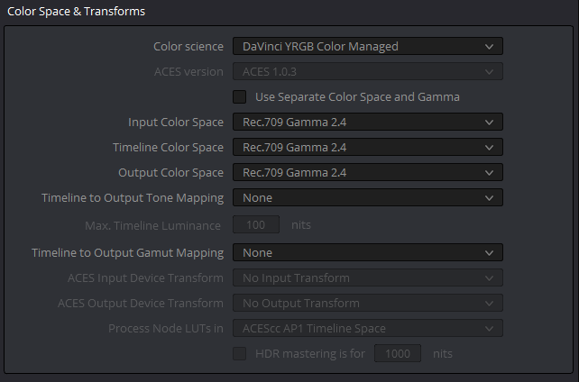

mirekti Posted May 13, 2019 Share Posted May 13, 2019 On 4/17/2019 at 6:19 AM, Sage said: You'll be fine there; the in is the same as the out and timeline (no transform). Here are the defaults (or can set to 'DaVinci YRGB', and Rec709 2.4 Timeline): I see your Input Color Space is set to Rec.709. Is this for CineD or you use it for vlog-l too? My impression was that input color space should match what the original footage was recorded with. BTW Any updates on GH5S profile? Thanks and cheers!! Link to comment Share on other sites More sharing options...

Sage Posted May 13, 2019 Author Share Posted May 13, 2019 1 hour ago, mirekti said: I see your Input Color Space is set to Rec.709. Is this for CineD or you use it for vlog-l too? My impression was that input color space should match what the original footage was recorded with. BTW Any updates on GH5S profile? Thanks and cheers!! Yes, to Rec709 Gamma 2.4 (or simply Davinci YRGB for Color science). The project-level color management settings come into play when you want to conform all footage from one color space to another (with EC, the conversion does the conform). The S will come shortly after the P4K (next up) deezid, mirekti and JeremyDulac 3 Link to comment Share on other sites More sharing options...

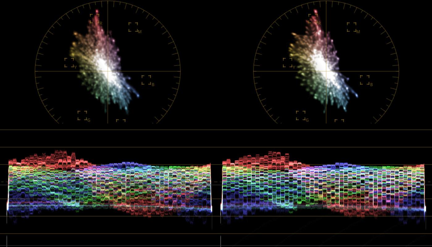

Sage Posted May 23, 2019 Author Share Posted May 23, 2019 12 hours ago, JeremyDulac said: I have been using GHa on my P4k until Alex has the new lut ready. Thought i'd share a few tests - I feel like it is working quite well, and handles over-saturated reds and blues pretty nicely. Looking forward to the official lut Those look pretty amazing as is. I finished the first tungsten conversion today (mostly). Still have some refinement to do. Here is an idea of it, a sample slice from both cams: Meahmut, Jonesy Jones and JeremyDulac 3 Link to comment Share on other sites More sharing options...
