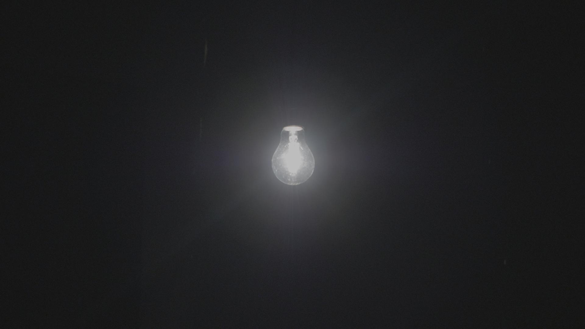

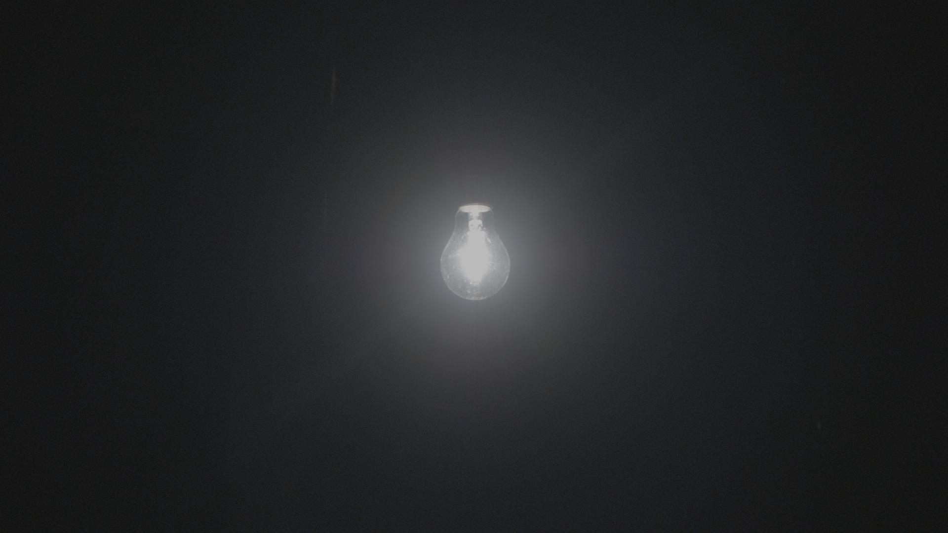

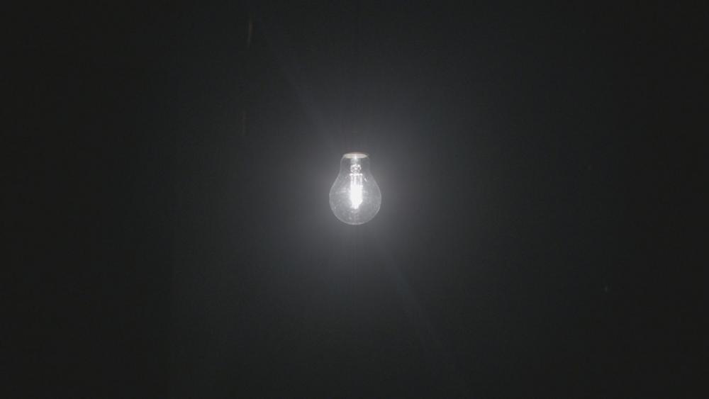

Yes, that's why I didn't even consider filters for so long. Its not specific to Firecrest, those are the reference Full Spectum NDs for EC though (how the Day conversion was made). It needs a minimum of a 2 stop ND to fully cancel out the reflection; the glass also needs to be parallel to the sensor plane, as one ND I have is slightly off axis, resulting in a diverging reflection.
Interestingly, the Alexa doesn't even have this problem, despite having CMOS, as best I can tell. The falloff is silk and there are no ghost reflections, as I believe the filter is 'integrated', and not a stack (that causes 'stair-stepping' falloff):
GH5
GH5 (1/4 LC, DD1, Contrast matched)
Alexa

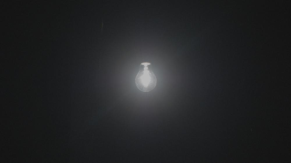

GH5

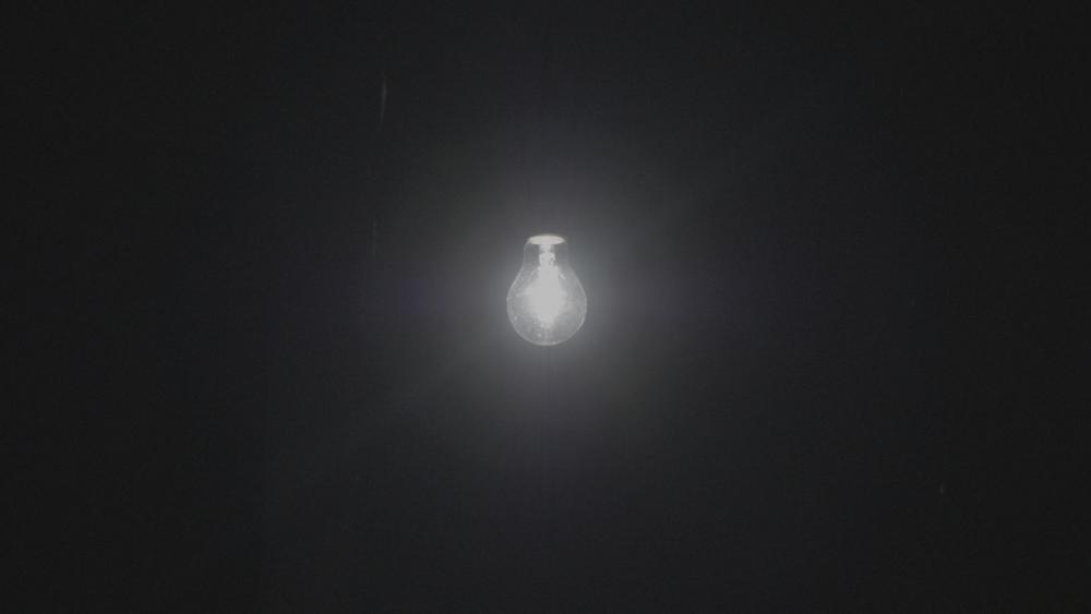

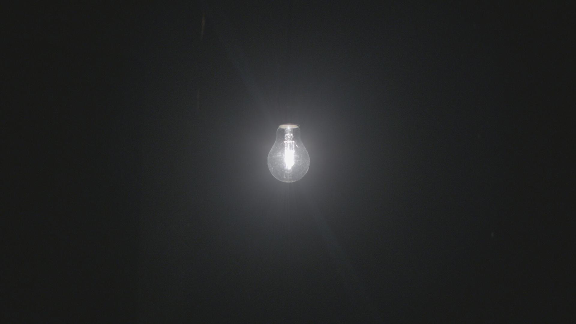

Alexa
Wow the Alexa one still looks amazing even with a filter. You think it can be achieved with a filter and adding a contrast on the GH5? Now I'm rethinking about purchasing a Promist. Looks like it will just look the GH5's shots muddy

That is, the Alexa shot has no filter - nothing can quite match the two in terms of falloff. The GH5 (and I assume most every other CMOS camera) has a reflective 'stack', with no reflection dispersion. The falloff can be smoothed, specifically with a Tiffen Low Contrast 1/8 or 1/4 (but the contrast will be lowered from reference, no LC is closest to AA falloff strength). DD1 is amazing for texture though; in that sense, they can be matched.
*Oh - and the bokeh with this filter stack + light digital Olpf is amazing. It feels like I'm using incredible glass.

I'm looking at those shots on a crappy old laptop, so take this with a grain of salt - but while the GH5 with filters shot looks great in terms of fall-off, it also looks quite soft. Won't all this manipulation make the image too soft (LC, DD1, digital olpf, 1080 upscale)?
I like a detailed, organic filmic image. Not the overly sharp digital look. But I don't want to go too far in the other direction and make it look like it was shot on Betamax with a 35mm adapter :)

Its a combo of compressed contrast because of higher halation than the Alexa (distinctly higher with LC1/4), and a missing top three stops.  DD1 with light Olpf settings (5.2/20) is quite a close match (optical Olpf side-by-side coming)
I shoot to 1080p, as that's all I need (a match to the classic); if you don't mind the data rates, 4K is worthwhile (most are shooting to 3.2k with Alexa Minis today, and some high end productions to Alexa 65/LF)
