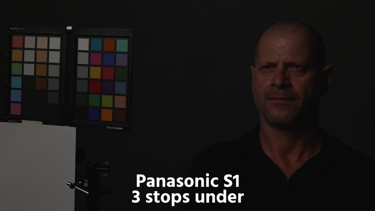

Administrators Andrew - EOSHD Posted July 16, 2019 Author Administrators Share Posted July 16, 2019 Hands up... Who exposes the main subject like this? Answer: NOBODY! heart0less, Geoff_L and Jak234 3 Link to comment Share on other sites More sharing options...
Geoff_L Posted July 16, 2019 Share Posted July 16, 2019 4 minutes ago, Andrew Reid said: Hands up... Who exposes the main subject like this? The directors of Game of Thrones season 8 ? ?? Rinad Amir, sanveer, Andrew - EOSHD and 1 other 1 3 Link to comment Share on other sites More sharing options...
thephoenix Posted July 16, 2019 Share Posted July 16, 2019 28 minutes ago, Geoff_L said: The directors of Game of Thrones season 8 ? ?? or the dp of solo a star wars story glad it is better than the xt3 as it costs the double ? better low light must be because of the bigger sensor. too bad they don't have 400mbps like the fuji but i guess it would require a lot of space and would be tricky to deal with internaly. curious to see how the S1h will be btw i am still amazed by people doing image comparison on youtube and not vimeo, power of marketing and dream of being a yt star i guess Link to comment Share on other sites More sharing options...
Administrators Andrew - EOSHD Posted July 16, 2019 Author Administrators Share Posted July 16, 2019 Even Johnnie looks confused why he exposed his own face 3 stops under Link to comment Share on other sites More sharing options...

TheRenaissanceMan Posted July 16, 2019 Share Posted July 16, 2019 4 hours ago, Andrew Reid said: Hands up... Who exposes the main subject like this? Answer: NOBODY! Who puts test charts in their movie? It's designed to show the malleability of information at low IRE values, which is useful data. webrunner5 and Geoff CB 2 Link to comment Share on other sites More sharing options...
