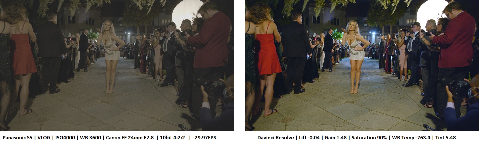

herein2020 266 Posted January 2 Share Posted January 2 Dual Native, Dual Gain, x stops over / y stops under.....I just get out and shoot and I can tell you I couldn't be happier with the S5's ISO performance at both 640 and 4000. I use 4000ISO all the time because I'm usually in situations where I cannot control the lighting and when color grading in Davinci Resolve, as long as the WFM didn't show clipping it grades perfectly fine to my eyes. Below is a shot from a fashion show at 4000ISO. The only two things I wish the S5 had was better CAF and 4K120FPS; better ISO performance is not on that list. In fact the S5's VLOG is so easy to work with I don't bother with ETTR or really any other tools other than the WFM. If the WFM shows everything is in range and I'm shooting in 10bit I know I can recover from pretty much anything. Quote Link to post Share on other sites
