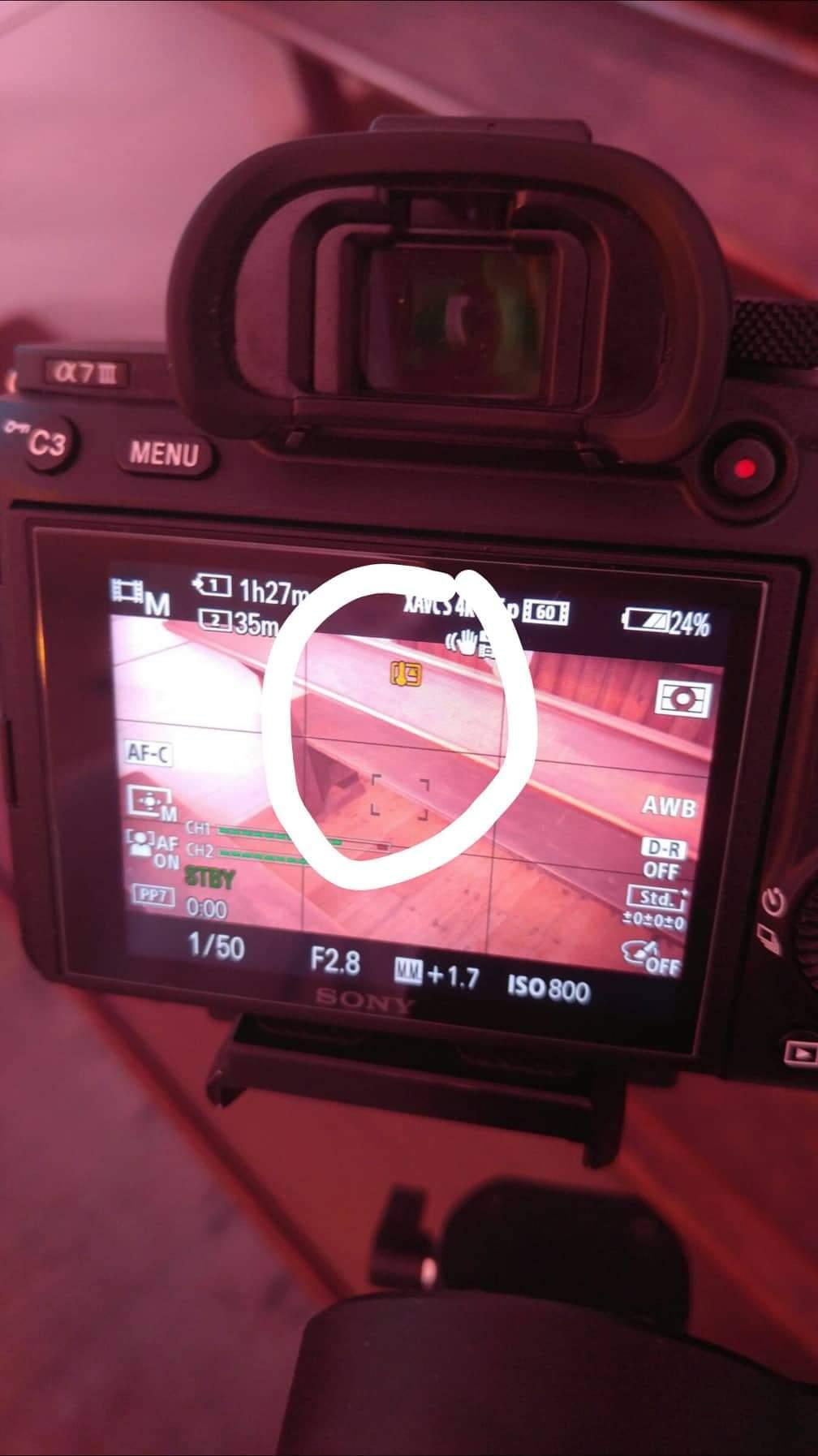

ntblowz Posted July 31, 2019 Share Posted July 31, 2019 Yeah my friend's A7iii got temp warning during a MV shoot recently, and its bloody middle of winter atm! Link to comment Share on other sites More sharing options...
Skip77 Posted July 31, 2019 Share Posted July 31, 2019 And this Is one reason the A7SIII is delayed. How long before Sony takes down his video? And to be fair to Sony if you select 'higher heat level" or whatever that is, it actually makes a big difference. The A7 III would have hit the 30 min record mark. Link to comment Share on other sites More sharing options...

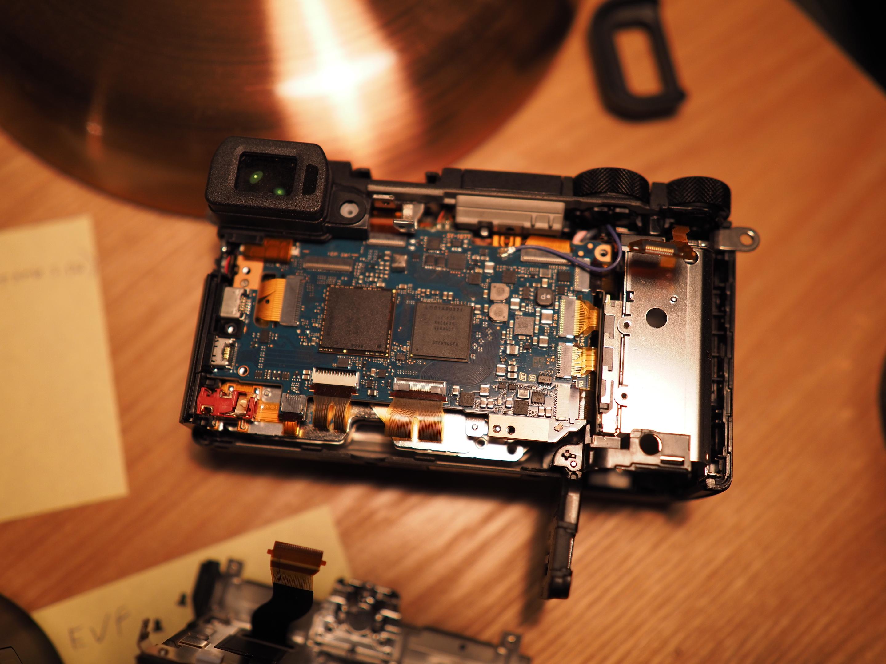

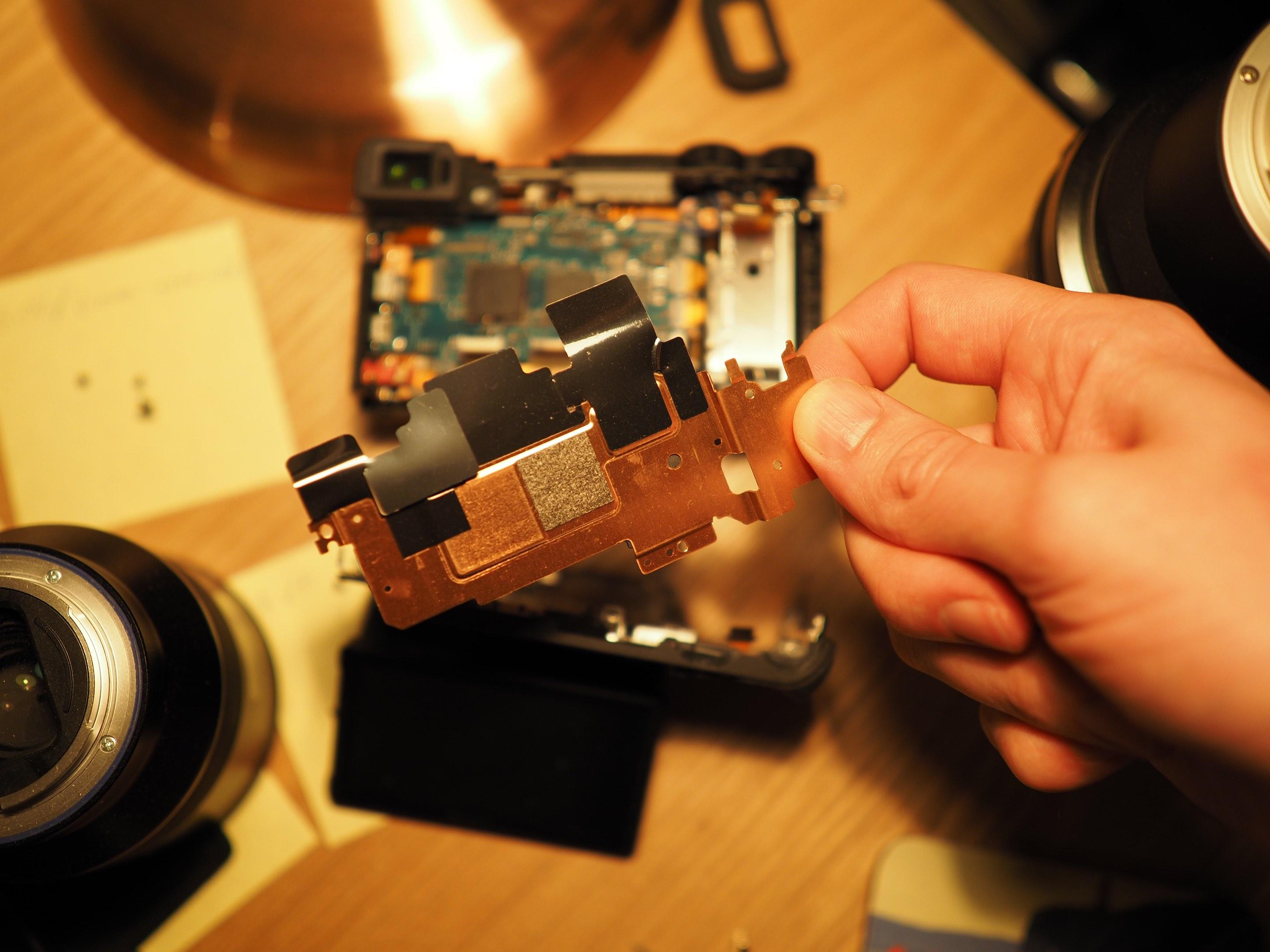

Administrators Andrew - EOSHD Posted July 31, 2019 Administrators Share Posted July 31, 2019 Having taken apart an A6500 before, I can see why Sony have such bad overheating issues. Internal layout is a pile of pants. They need to take a lesson from Panasonic & Sigma. Very thin heat spreader on the processors and RAM. No heat pipes. Heat spreader backs onto the warm rear LCD, trapping the heat. The Sigma Fp solution with proper heat sink sandwiched between the processor and screen but vents at the side in open air, not to the back of the screen, is much cleverer and shows you can still keep a thin, small camera, but manage heat effectively. Laptops show you can have a thin design with heatpipes. Sony just can't be arsed. Cinegain 1 Link to comment Share on other sites More sharing options...

Administrators Andrew - EOSHD Posted August 1, 2019 Administrators Share Posted August 1, 2019 Attaching those A6500 pics again as previous ones vanished! What a masterpiece of thermal engineering ? frontfocus, Video Hummus and PannySVHS 3 Link to comment Share on other sites More sharing options...
Super Members BTM_Pix Posted August 1, 2019 Super Members Share Posted August 1, 2019 28 minutes ago, Andrew Reid said: Attaching those A6500 pics again as previous ones vanished! What a masterpiece of thermal engineering ? I have to say that I'm pretty intrigued about the purpose behind you taking an A6500 apart ! Andrew - EOSHD and PannySVHS 2 Link to comment Share on other sites More sharing options...
