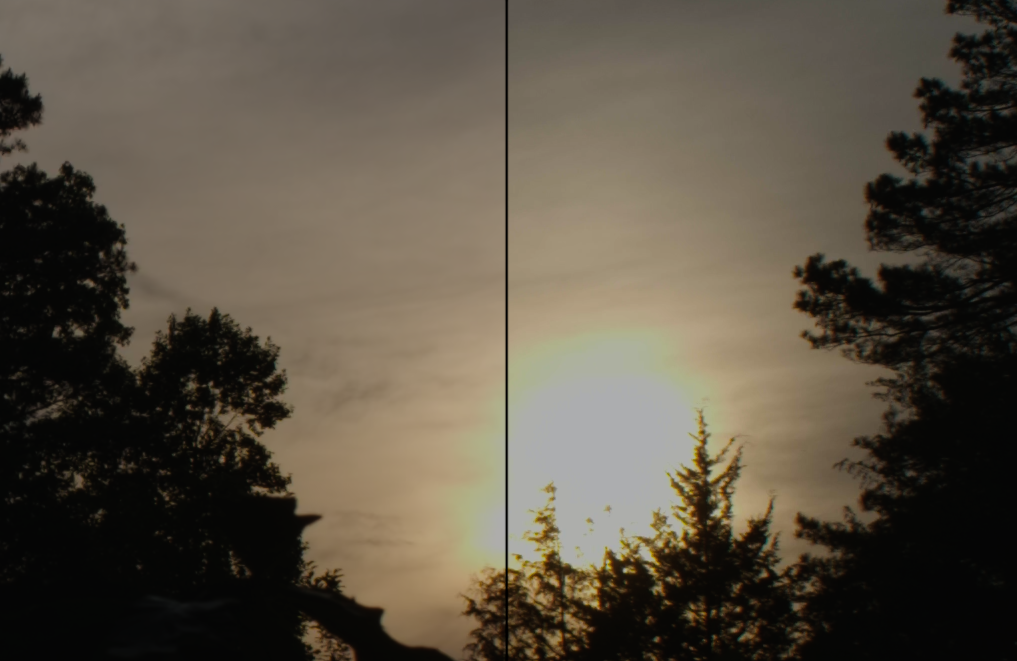

KnightsFan Posted May 18, 2021 Share Posted May 18, 2021 I'm always glad to see people doing actual tests on these things! Thanks Andrew. I don't really see any difference in the pictures you posted. I did quickly grab some images with my Z Cam. I can't do the same format in 8 and 10 bit, so I compared 8 bit H.264 at 120 mbps vs. 10 bit H.265 at 60 mpbs. Big difference there... here's a 1:1 crop of the sky dropped 4 stops in post and no other color adjustment. 4 stops is a lot, but not unreasonable for exposing a Zlog2 image particularly with high dynamic range. Lots of very ugly colored bands on the H.264 and actually it looks worse with the full image. It might be worth comparing your highlights as well as shadows, especially in log footage. I don't see any banding in the shadows in my image when pushed, just in the highlights. So I will agree with @jghardingthat it will vary camera to camera, and encoder to encoder. kye and ntblowz 2 Link to comment Share on other sites More sharing options...
