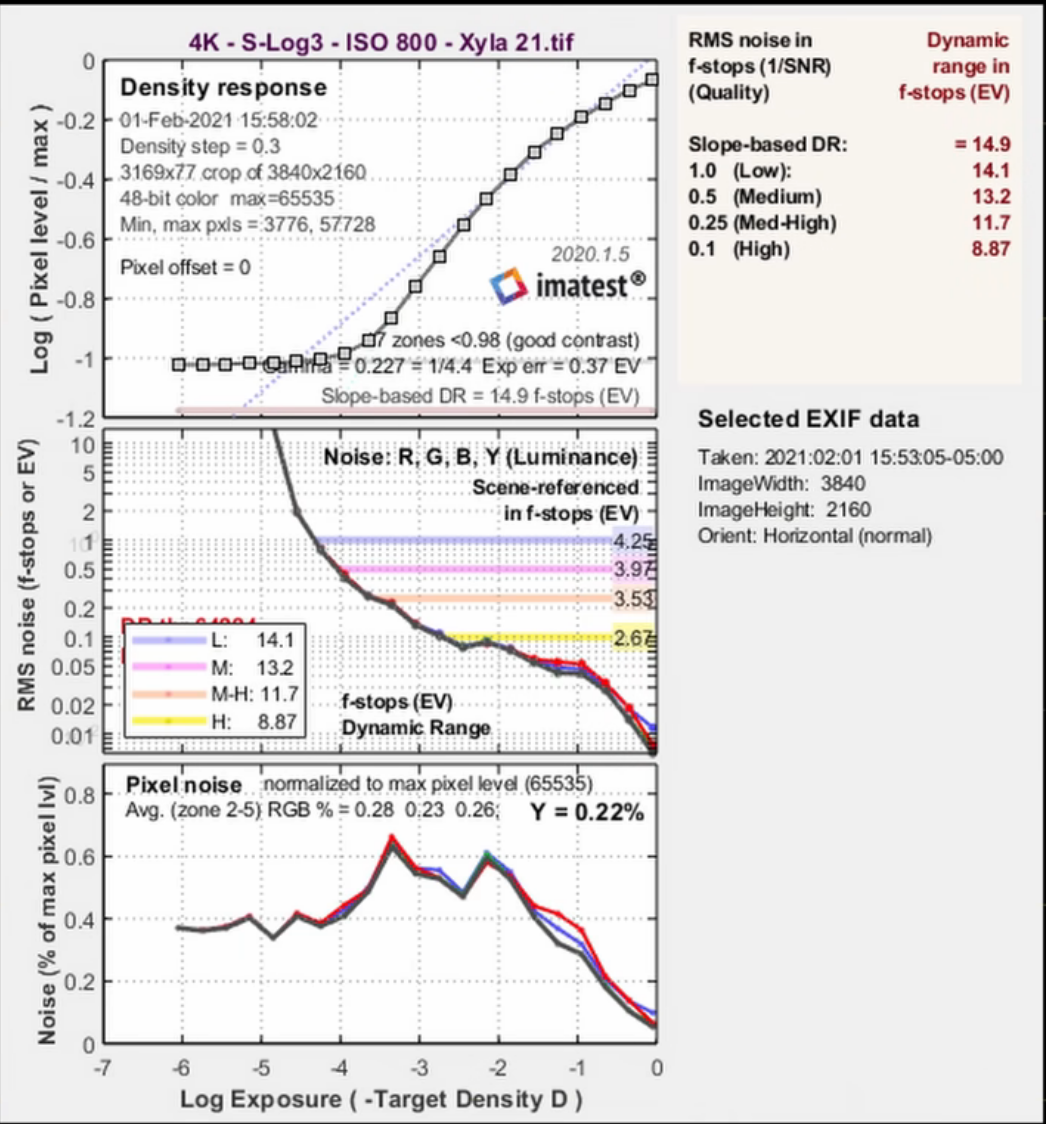

ntblowz Posted May 8, 2021 Share Posted May 8, 2021 So CineD finally tested the DR on Alexa Classics, and the test came out 13.8 which is really close to Arri's stated 14 stop DR, while all other camera state high DR but actual result is much more tame. They should really use Arri's DR test as standard. DR claim is a wild west out there atm it is ridculous! https://www.cined.com/arri-alexa-classic-mini-lf-lab-test-rolling-shutter-dynamic-range-and-latitude/ Link to comment Share on other sites More sharing options...

androidlad Posted May 8, 2021 Share Posted May 8, 2021 Sony A1 scores 13.2 stops, not that far behind. Link to comment Share on other sites More sharing options...
kye Posted May 8, 2021 Share Posted May 8, 2021 3 hours ago, androidlad said: Sony A1 scores 13.2 stops, not that far behind. The C500ii gets 13.1 stops, also not that far behind: https://www.cined.com/canon-c500-markii-lab-test-dynamic-range-latitude-rolling-shutter/ Of course, combined with the Alexas colour science and that incredible latitude, the total package is really something else. Perhaps the biggest challenge in the camera market is that each camera that has a significant strength is marred by being absolutely terrible in four other ways. It's rare for a camera to be the best, or even in the top-tier, in every category. Although I suppose that the Alexa has its share of flaws - size, weight, and price being a few that quickly come to mind! Link to comment Share on other sites More sharing options...

BrooklynDan Posted May 8, 2021 Share Posted May 8, 2021 Other cameras have rivaled the Alexa for dynamic range. Even though Red loves to exaggerate its DR figures (18 stops my ass!), the Monstro has a comfortable 13.5 stops in the right hands. The Venice also rocks at least 14 stops in X-OCN Raw. What the Alexa has that no other manufacturer seems to get right is the highlight roll-off. Every camera, no matter how many stops of dynamic range it has, will eventually have to photograph pure white. Whether it's the harsh glare of a set of headlights or the shimmering heat of a desert at noon, at some point, the image will burn out. The Alexa does it better than anyone. Highlights are a clean white, no tints, no fringing. That's really Arri's real achievement, even above the dynamic range. That's why people keep shooting Alexa Minis, even at 2K despite all the choices available. IronFilm 1 Link to comment Share on other sites More sharing options...
noone Posted May 8, 2021 Share Posted May 8, 2021 Which coat pocket do you keep your Alexa in? As long as there is ENOUGH DR for the job does it really matter? I just looked at the A7siii test they did and it is not too bad at lower ISOs but they got 12 usable stops of DR at ISO 16000! Link to comment Share on other sites More sharing options...
