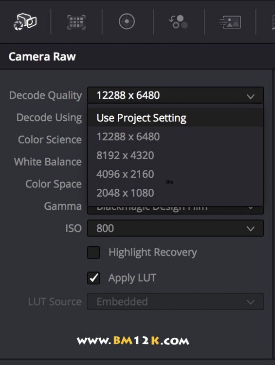

majoraxis Posted July 21, 2020 Share Posted July 21, 2020 8 hours ago, androidlad said: In the Camera RAW settings in Resolve, you can do the subsampling from 12k to 8k, 4k or even 2k. Is Blackmagic doing Oversampling in the Resolve and in camera it is a different type of math? We may see a quality difference when comparing the two methods (in Camera and in Resolve). Subsampling to 2k looks to be straight averaging so that should look about the same in camera or in Resolve. Because it is not an even ratio of RGB pixels when going from 12k to 4k, the subsampling conversion should benefit from doing advanced math to get the most out of the subsampling process as you are turning a 36 pixel 6 x 6 group of pixels in to 4 pixels. There is a lot of data to work with and maybe simple math, if that’s all that is available in camera, won’t be a big difference when going from 12K to 4k in camera vs in Resolve, if the math is different in camera vs in Resolve. For the 12k to 8k subsampling coversion it is a 2.25 ratio so you are going from 36 to 16 pixels. I would expect to see the most difference between capturing at 12k and subsampling to 8k in Resolve vs subsampling to 8k in camera and creating a 8k BRAW file, if the math is different in camera vs in Resolve. If the subsampling math is simpler in camera, I expect the 12k to 8k in Resolve subsampling to look better. It is possible that they may look very similar now and eventually look better in Resolve when higher math options are available. Testing and time will tell. TheRenaissanceMan 1 Link to comment Share on other sites More sharing options...
