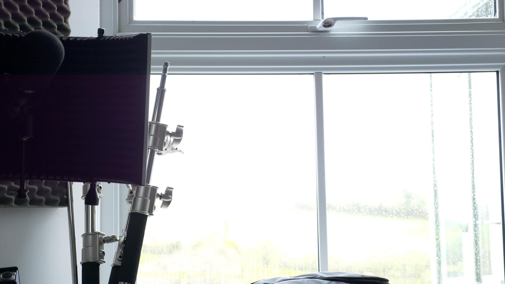

Mmmbeats Posted March 11, 2022 Share Posted March 11, 2022 8 hours ago, kye said: Are you able to provide any examples? I've seen a number of tests that don't have these issues, so interested in seeing how people are testing this. This is from Facebook (from a reliable source). The streaking runs across the flag upper left. As others have pointed out this is a pretty extreme situation, but i do still think its a concern. Stuff like this catches you out when you're not expecting it. Mark Romero 2 and PannySVHS 1 1 Link to comment Share on other sites More sharing options...
kye Posted March 11, 2022 Author Share Posted March 11, 2022 25 minutes ago, Mmmbeats said: This is from Facebook (from a reliable source). The streaking runs across the flag upper left. As others have pointed out this is a pretty extreme situation, but i do still think its a concern. Stuff like this catches you out when you're not expecting it. Yes, it is noteworthy, but it would be good to see some tests where the magnitude of the streaks is known. ie, are the streaks 10-stops below the bright part of the image? 20-stops? 30-stops? If we knew that then it would be easier to know which situations you might encounter a problem and which you wouldn't. This is the GH6 XYLA21 chart from CineD, and the curve from the brightest patch to the noise floor (the curve on its left) looks like it drops away into the noise floor pretty quickly, so I'd imagine that for the streaks to be visible above the noise floor maybe 1/4 of the width of the frame from the brightest areas (as in the image you showed) then the highlighted areas must be well above 13 stops or so above the flag. That seems obvious considering the flag is pretty dark and the windows are completely blown to hell, so who knows how bright they actually are. Mmmbeats and Juank 2 Link to comment Share on other sites More sharing options...
sanveer Posted March 13, 2022 Share Posted March 13, 2022 On 3/11/2022 at 6:23 PM, Mmmbeats said: This is from Facebook (from a reliable source). The streaking runs across the flag upper left. As others have pointed out this is a pretty extreme situation, but i do still think its a concern. Stuff like this catches you out when you're not expecting it. Interesting. Is it also simply a mismatch in refresh rates between the lighting in the shot setup, and the video frame rate setting of the camera? I read somewhere that this is visible in Sony and Fuji cameras too. So maybe this could be compared. Maybe its visible across many digital camera, regardless of dual gain signal or the regular signal circuitry. Link to comment Share on other sites More sharing options...

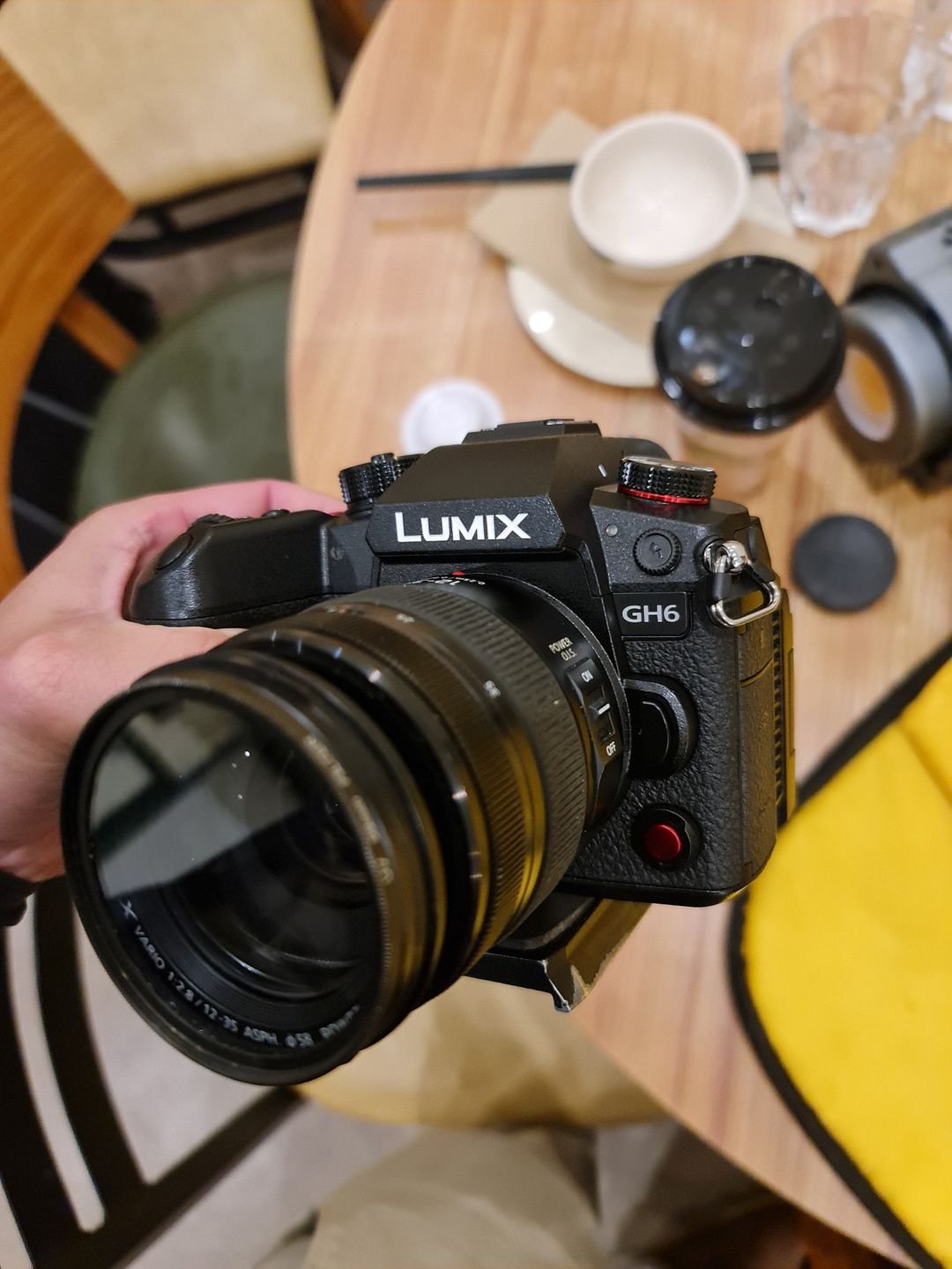

ntblowz Posted April 8, 2022 Share Posted April 8, 2022 My friend's new GH6 just arrived! Juank and kye 2 Link to comment Share on other sites More sharing options...
kye Posted April 10, 2022 Author Share Posted April 10, 2022 On 4/9/2022 at 6:04 AM, ntblowz said: My friend's new GH6 just arrived! Please share more! Link to comment Share on other sites More sharing options...
Matt G Posted April 12, 2022 Share Posted April 12, 2022 I’ve been experiencing the high contrast streaks described in this thread on the GH6 I just purchased. very strange. Link to comment Share on other sites More sharing options...
Administrators Andrew - EOSHD Posted April 13, 2022 Administrators Share Posted April 13, 2022 Try it in HDR mode, it greatly reduces it. Link to comment Share on other sites More sharing options...
