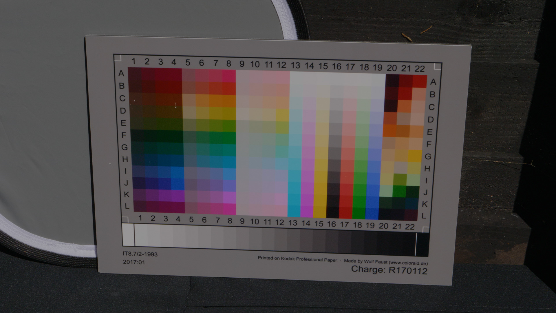

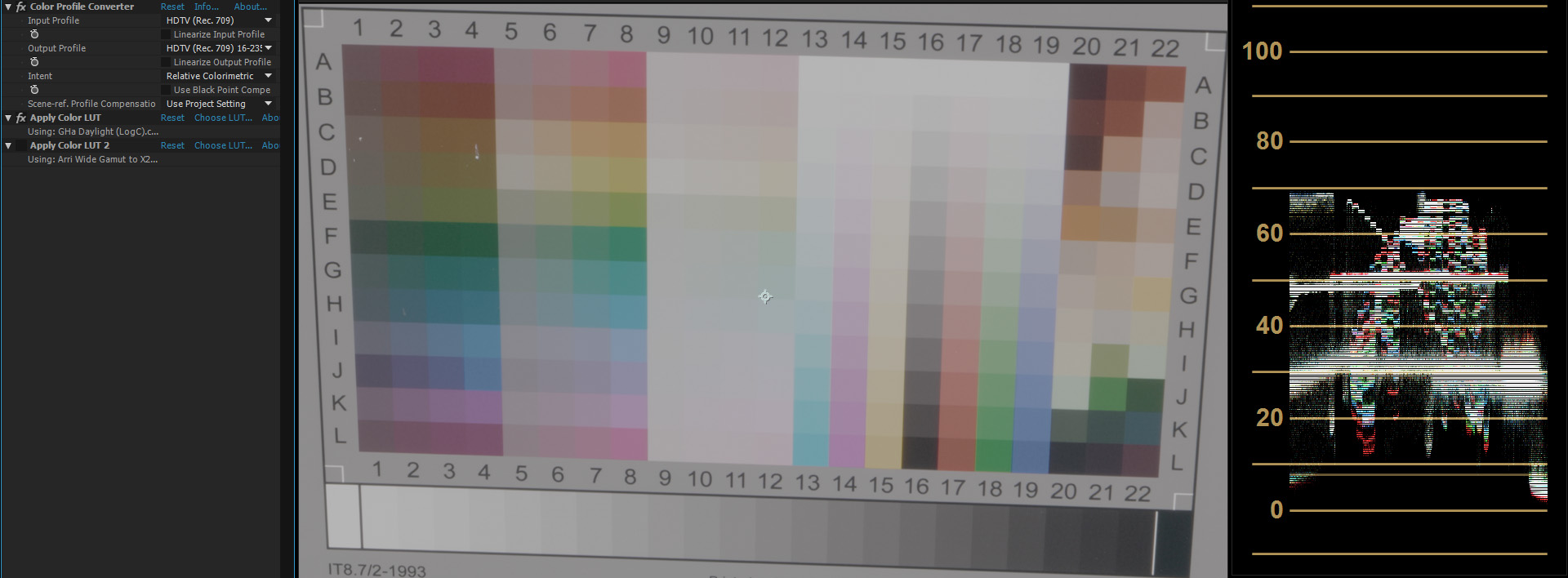

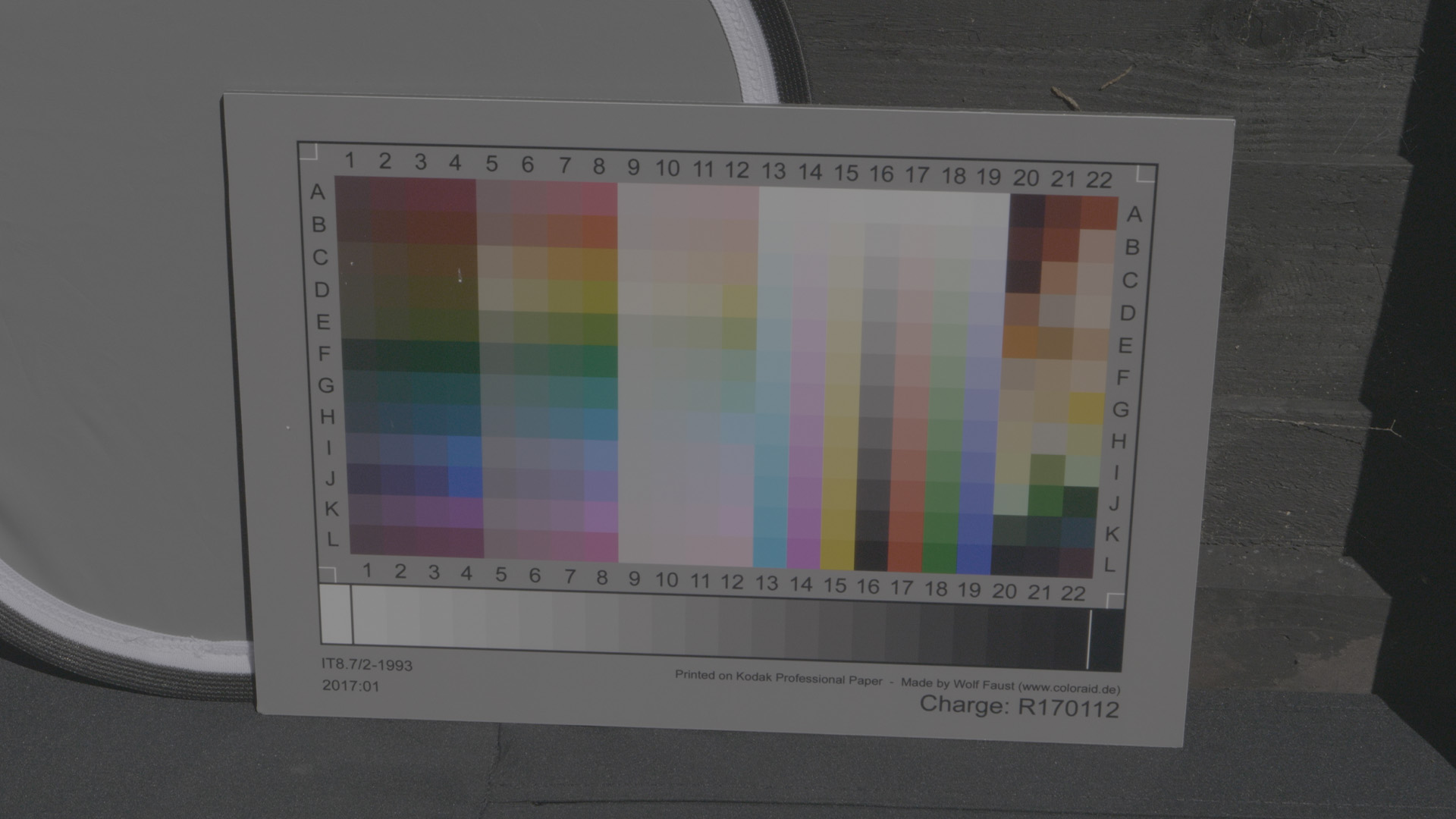

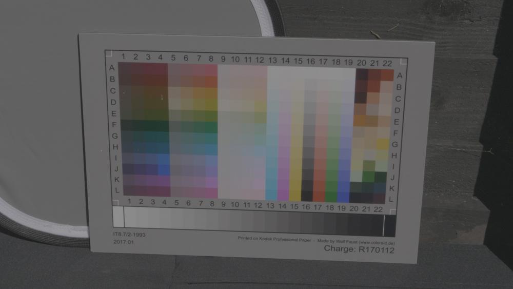

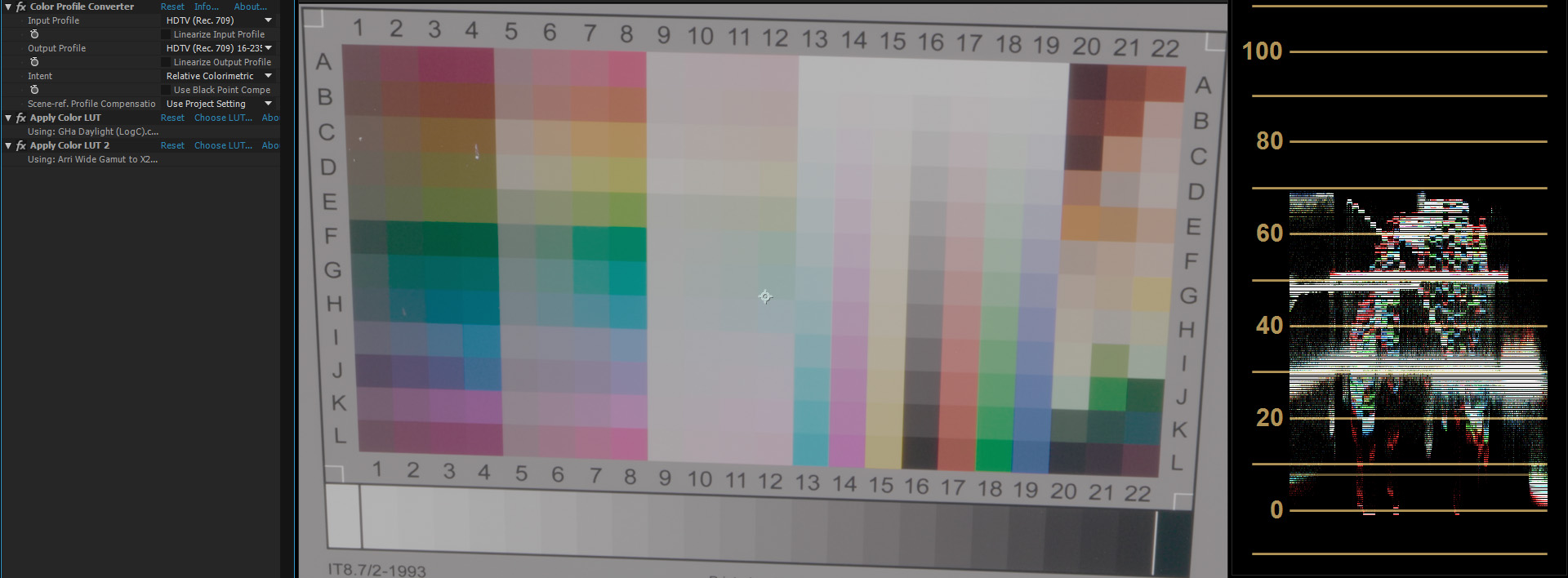

hyalinejim Posted February 17, 2018 Share Posted February 17, 2018 @Sage Am I right in understanding that your lut converts GH5 VGamut to Alexa Wide gamut? If so, the "correct" way to use your luts would be to use GHa LogC with an Alexa Wide Gamut to Alexa X-2 conversion. When I do this, colours look more correct - not too saturated and skintones are not too magenta. Here's a comparison with actual X-Rite colorchecker values from BabelColor in the centre as a reference. I've added a curve to each to match to the chart's gamma. (VLog to GHa LogC) + (LogC Gamma & Alexa Wide Gamut to Alexa-X-2 Gamma & Alexa-X-2 Gamut) BEST MATCH (VLog to GHa Main) - too saturated (VLog to Varicam V709) - better, but not as good as the first one So as far as I can see, the colours that GHa gives should (technically) be transformed by using them with a LUT that expects Alexa Wide Gamut. So I'm curious as to what you see is the role of GHa Main and Soft? I understand your reasoning for the curves you chose for each, but what about the colour? Adept 1 Link to comment Share on other sites More sharing options...
Sage Posted February 17, 2018 Author Share Posted February 17, 2018 That's right, the result of using GHa LogC is a stand in for Alexa LogC. Going from there, it may be treated as LogC from an Alexa (it can accept Arri's Rec 709 or other transforms intended for LogC). GHa Main and Soft are alternatives to Arri's Rec709; they all handle saturation in a way that is reminiscent of film (and is not in Alexa LogC natively), but place overall saturation and contrast differently as a grade base: Main - Most Saturation, Middle Contrast (Mostly linear) Soft - Middle Saturation, Lowest Contrast (Mostly linear) Arri's Rec709 - Least Saturation, Most Contrast (S-emphasized) hyalinejim 1 Link to comment Share on other sites More sharing options...
hyalinejim Posted February 17, 2018 Share Posted February 17, 2018 But Main and Soft don't perform the transformation from Alexa Wide Gamut to Rec709 primaries. So the hues are "wrong" - the are the colours of an acquisition colour space. GHa LogC to Alexa X 2 gamut gives colour as Arri intended, I'm thinking. But Main and Soft are simply slightly more contrasty and more saturated versions of Log C (with saturation roll-off?). Now, this might be of interest as a look in itself, especially if people are grading Arri LogC directly and leaving the colour space untouched. But I would suggest to you that if Main and Soft are your interpretation of a film-like Rec709 look with saturation roll off and other good things, then you should transform the primaries. The ColorChecker shots above demonstrate just how far out Main is. The hue, saturation and value of colours are significantly skewed as they haven't been transformed to Rec709 primaries. So am I right in saying that if I want to match Alexa colour, GHa LogC plus a LogC to Alexa X 2 gamut lut is the way to go? seku 1 Link to comment Share on other sites More sharing options...
Sage Posted February 17, 2018 Author Share Posted February 17, 2018 32 minutes ago, hyalinejim said: So am I right in saying that if I want to match Alexa colour, GHa LogC plus a LogC to Alexa X 2 gamut lut is the way to go? Yes, that will work well. Per that project I messaged you about, there will be a solid reference match (core focus) Link to comment Share on other sites More sharing options...

hyalinejim Posted February 20, 2018 Share Posted February 20, 2018 3 hours ago, seku said: @hyalinejimhave you tried to apply a color space transform from Arri ... to let's say Rec.709 on the Main LUT yet? I don't have Arri reference material to try it out I just tried it now. The results are not so good. Adding the Arri colour space transform to GHa Main pushes a lot of the reds into negative clipping. This is especially noticeable in dark and deeply saturated reds, blues and purples. Lowering the saturation of GHa Main by a lot prevents this clipping. However, the issue is still evident (although not to the same extent) in GHa LogC. This means you might see some unnatural colours when using GHa LogC with LUTs that expect an Arri input. I would not use Soft or Main with Arri Luts at all. VLog - chart exposed for middle grey Add GHa Daylight Main Add Arri LogC to X 2 gamut only If you look at the bottom of the waveform you can clearly see the red channel going AWOL in this step from GHa LogC to the Arri X 2 gamut (this chart shot was ETTR, and has no clipping) GHa LogC: Now add transform to Arri gamut: webrunner5 1 Link to comment Share on other sites More sharing options...
