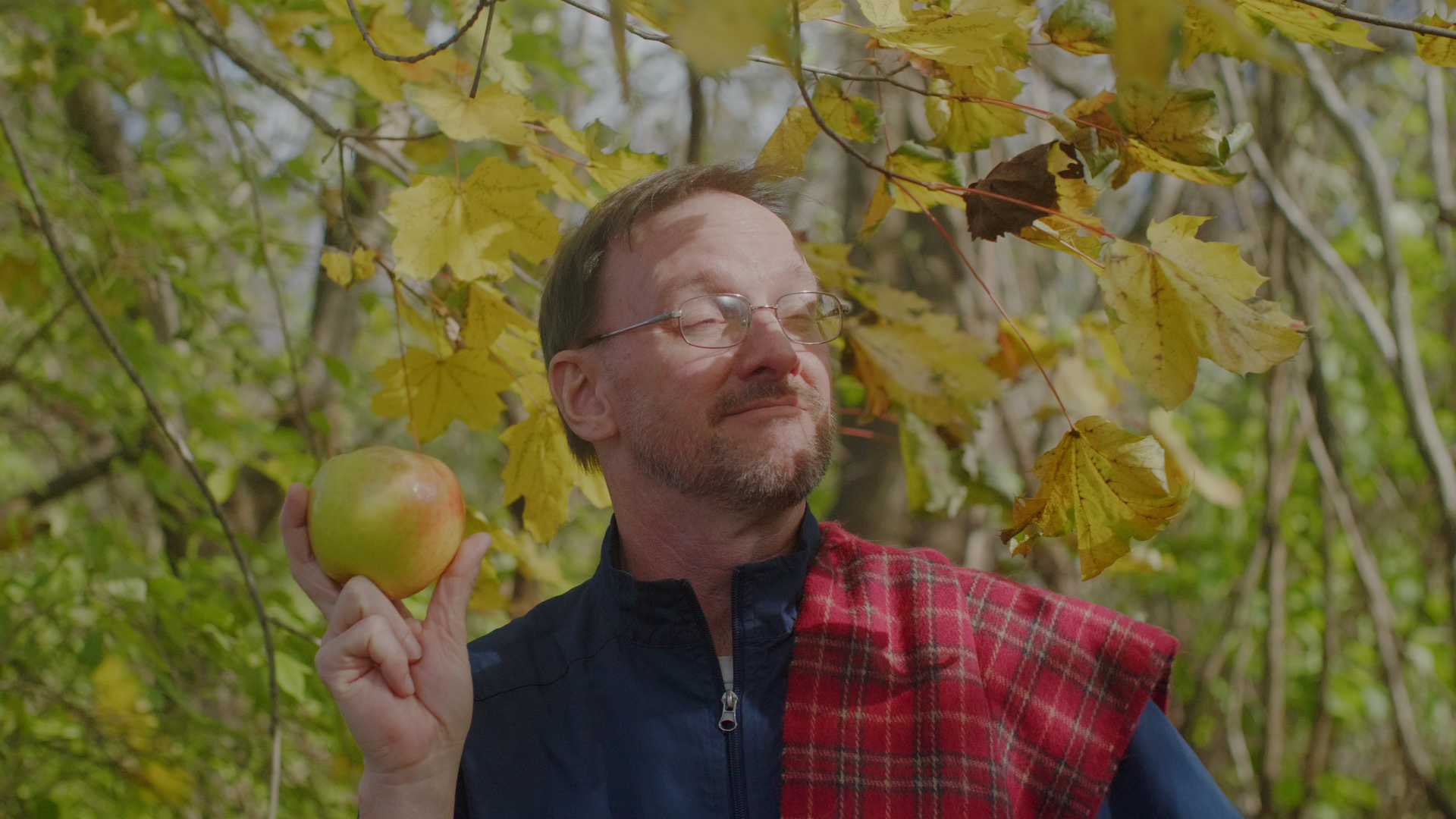

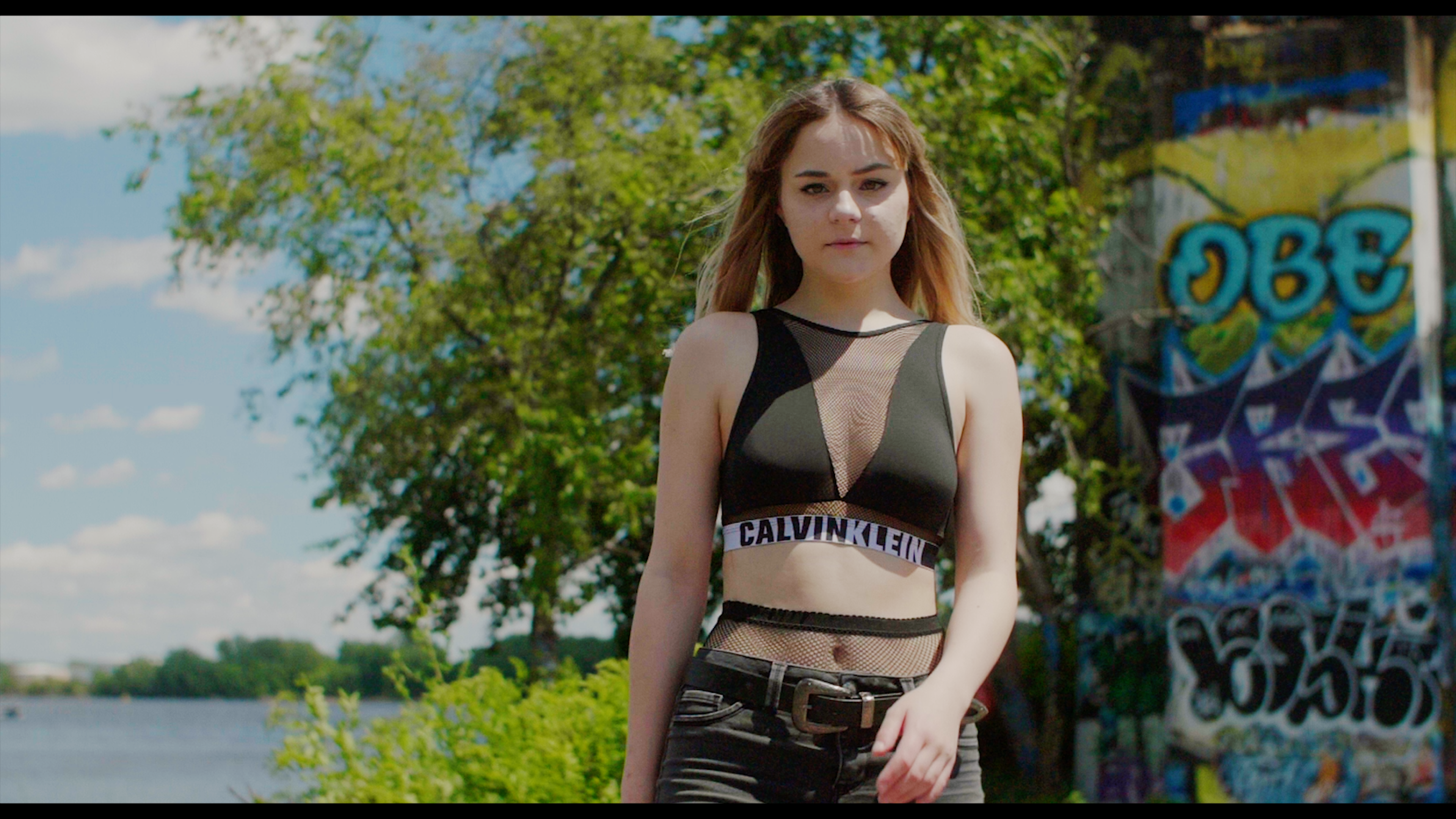

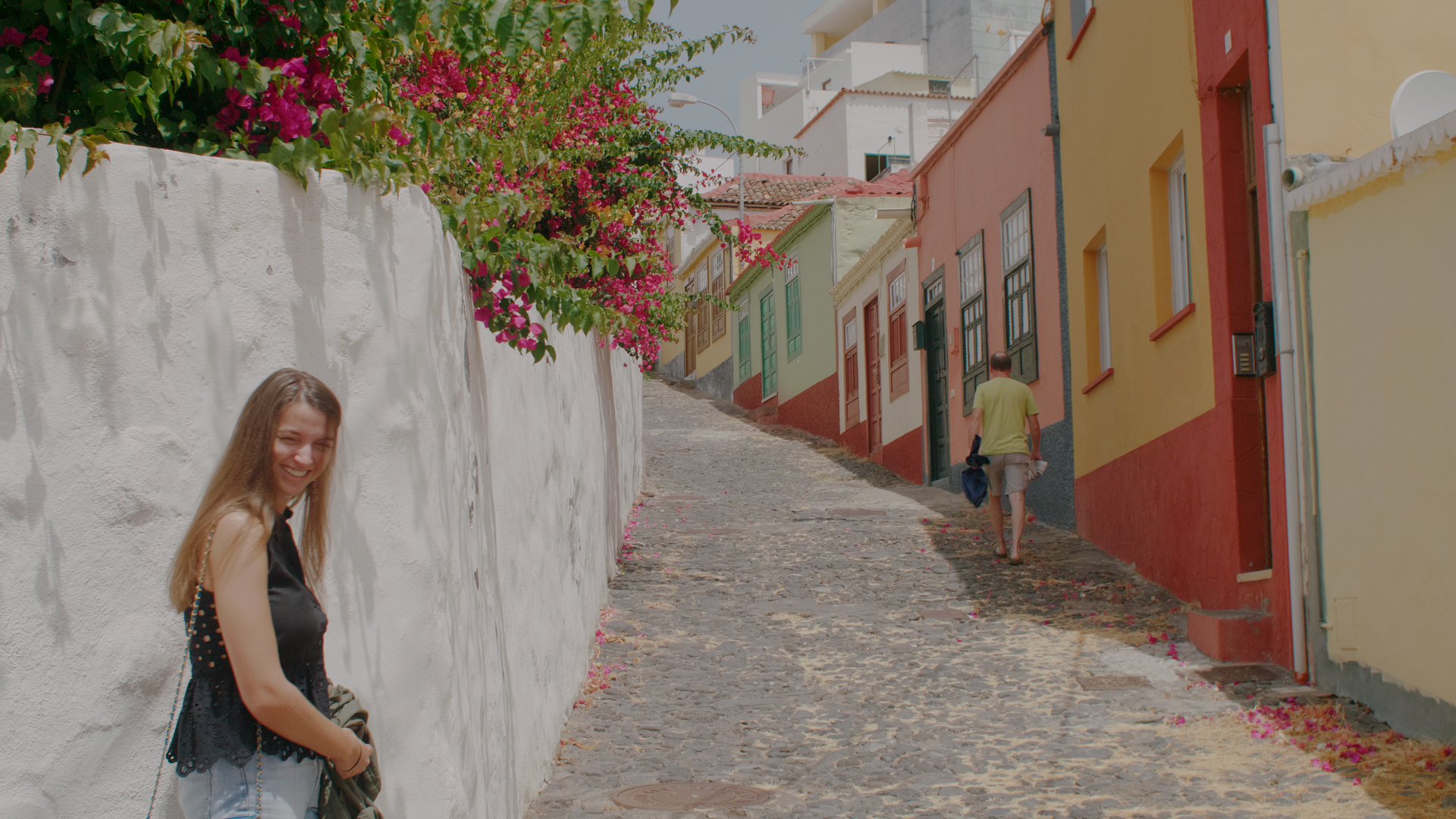

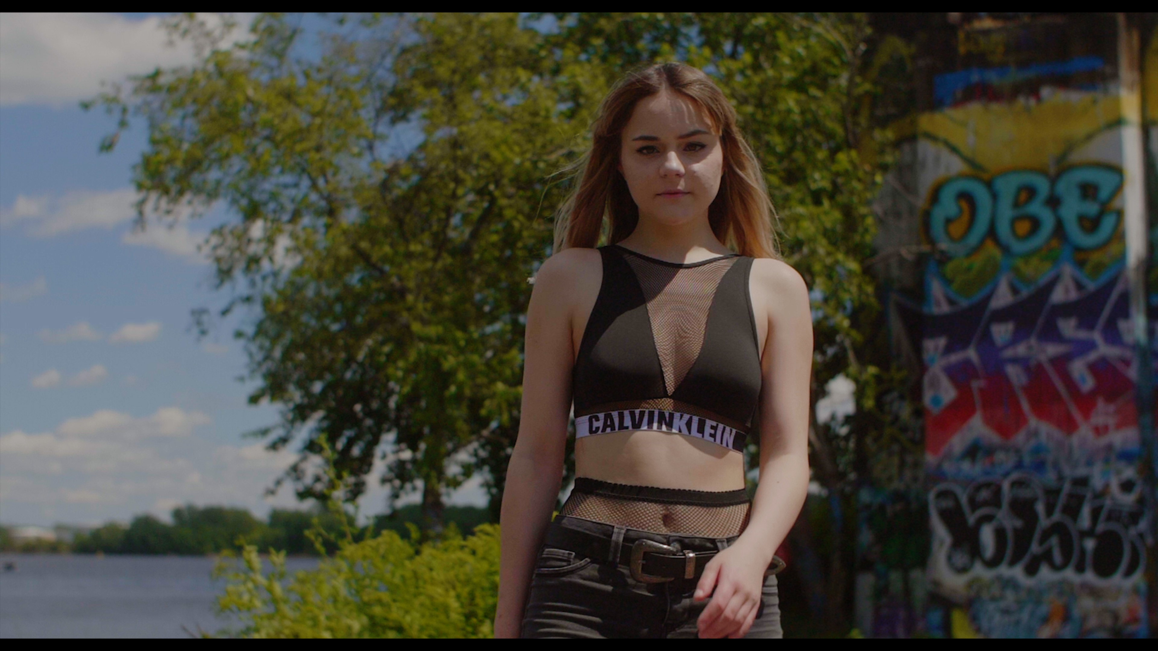

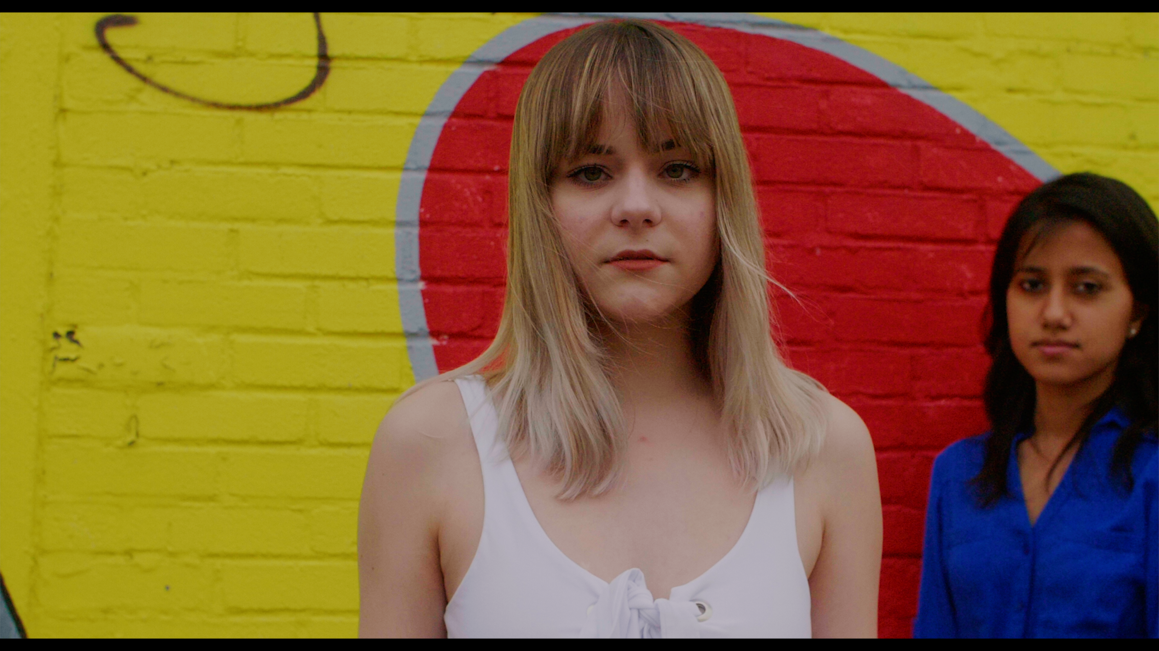

Sage Posted March 28, 2018 Author Share Posted March 28, 2018 Check it out: New LogC Tungsten New GHa Tungsten ________________________ VLog + Varicam 35 Lut deezid 1 Link to comment Share on other sites More sharing options...
deezid Posted March 29, 2018 Share Posted March 29, 2018 36 minutes ago, Sage said: Check it out: New LogC Tungsten New GHa Tungsten ________________________ VLog + Varicam 35 Lut Looks good! Can't wait to try it out. Sage 1 Link to comment Share on other sites More sharing options...
majoraxis Posted March 29, 2018 Share Posted March 29, 2018 That's quite a difference between the Varicam 35 Lut and New GHa Tungsten Lut. The GHa Tungsten Lut looks great! Sage 1 Link to comment Share on other sites More sharing options...
tihon84 Posted April 1, 2018 Share Posted April 1, 2018 On 29.03.2018 at 2:29 AM, Sage said: Check it out: New LogC Tungsten New GHa Tungsten ________________________ VLog + Varicam 35 Lut Hi, how can i get this new versions? Thanks Link to comment Share on other sites More sharing options...

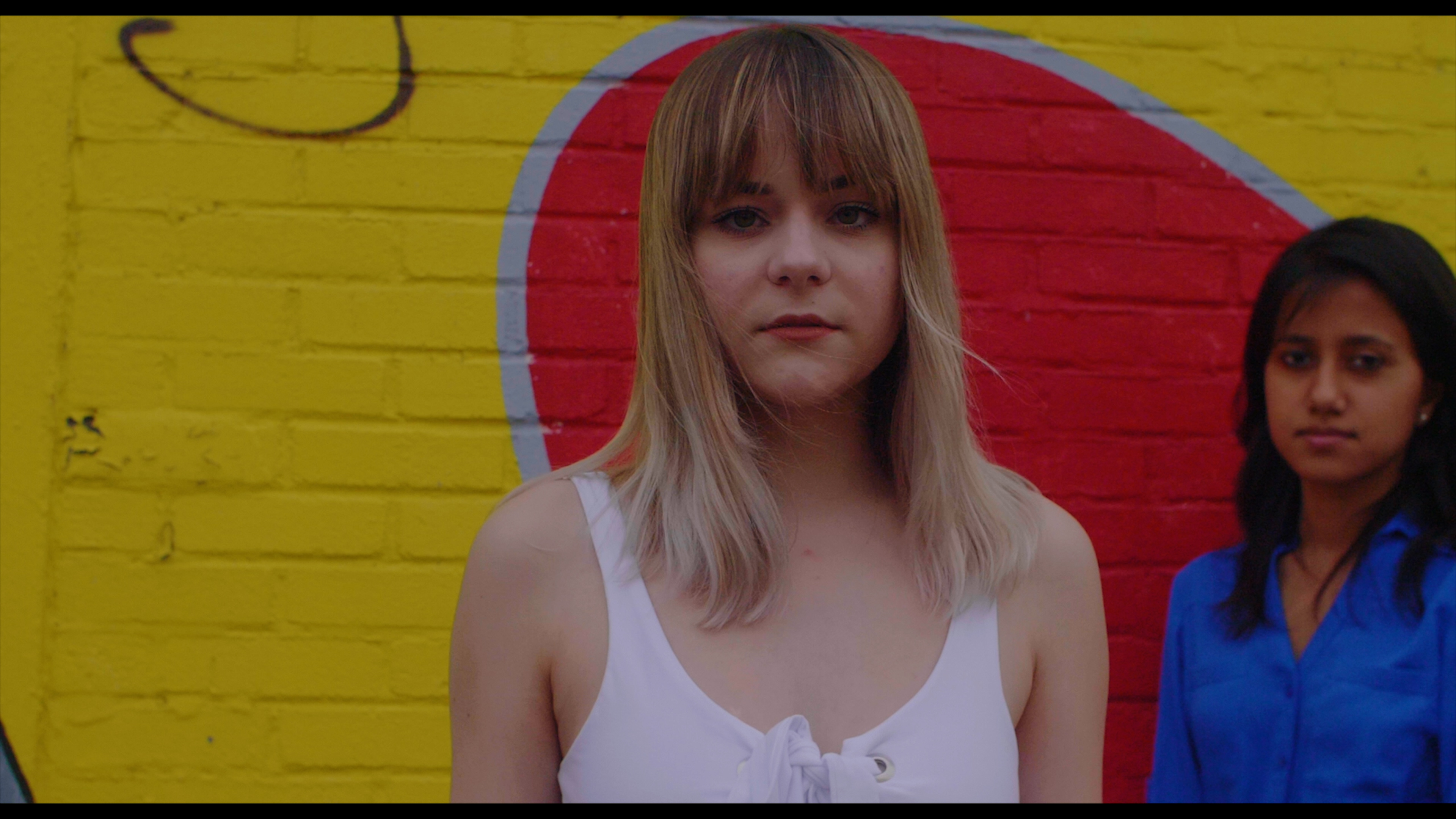

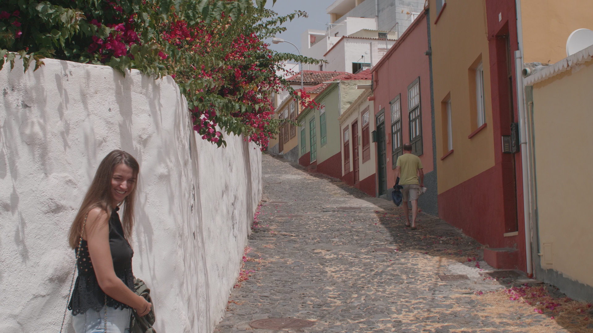

Sage Posted April 1, 2018 Author Share Posted April 1, 2018 3 hours ago, tihon84 said: Hi, how can i get this new versions? Thanks Soon; I have a lot of things to work on first. You'll be hearing from me (as previous) New GHa Daylight VLog + Varicam 35 Lut New GHa Daylight VLog + Varicam 35 Lut dxotic, anonim, JeremyDulac and 1 other 4 Link to comment Share on other sites More sharing options...

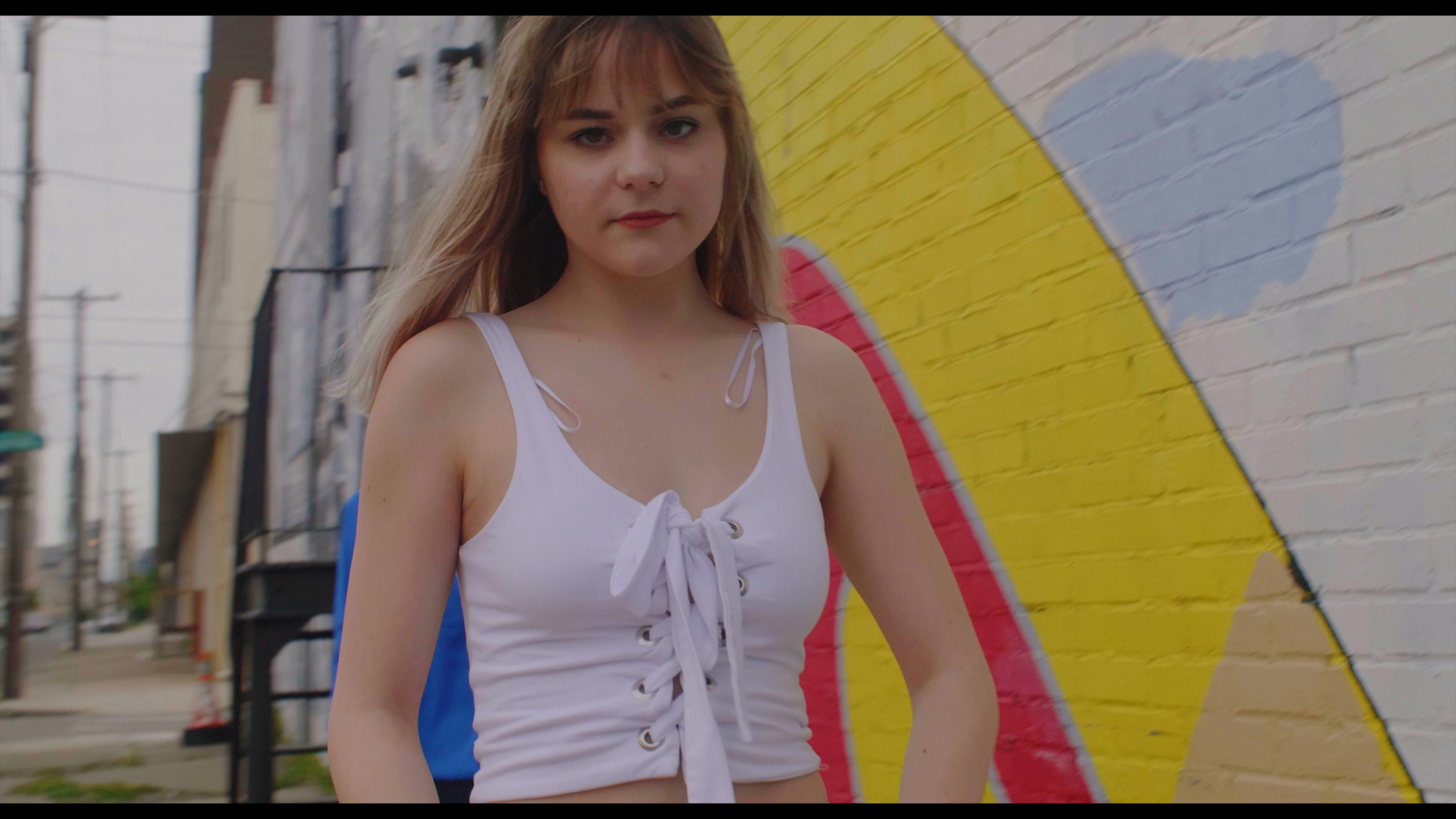

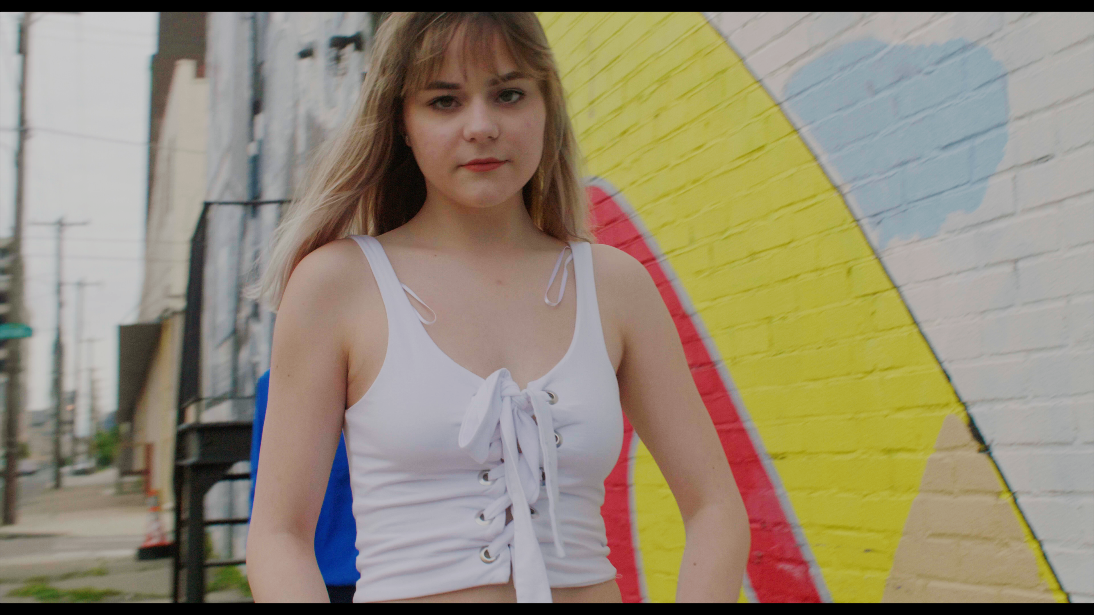

Sage Posted April 5, 2018 Author Share Posted April 5, 2018 2 hours ago, Pewwinck said: Thumbs up @Sage Thanks Pewwinck! Here's the upcoming Daylight: anonim, dxotic, deezid and 1 other 4 Link to comment Share on other sites More sharing options...

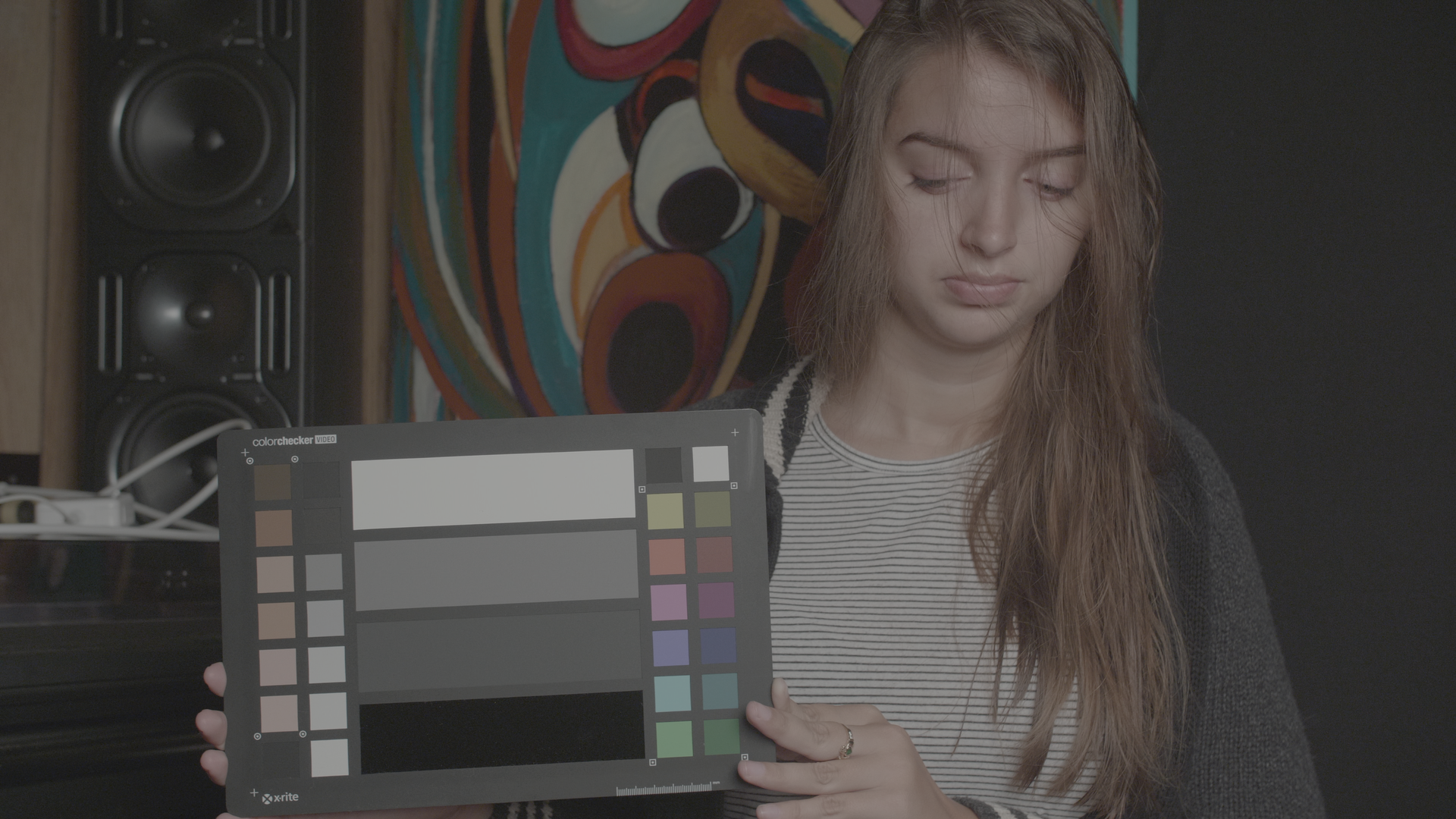

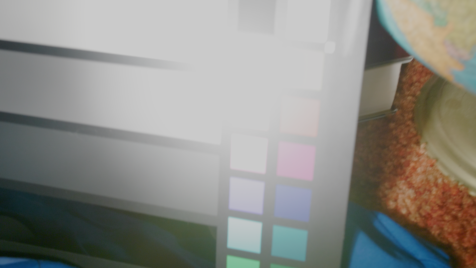

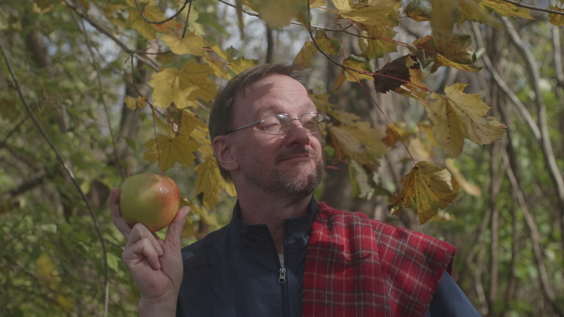

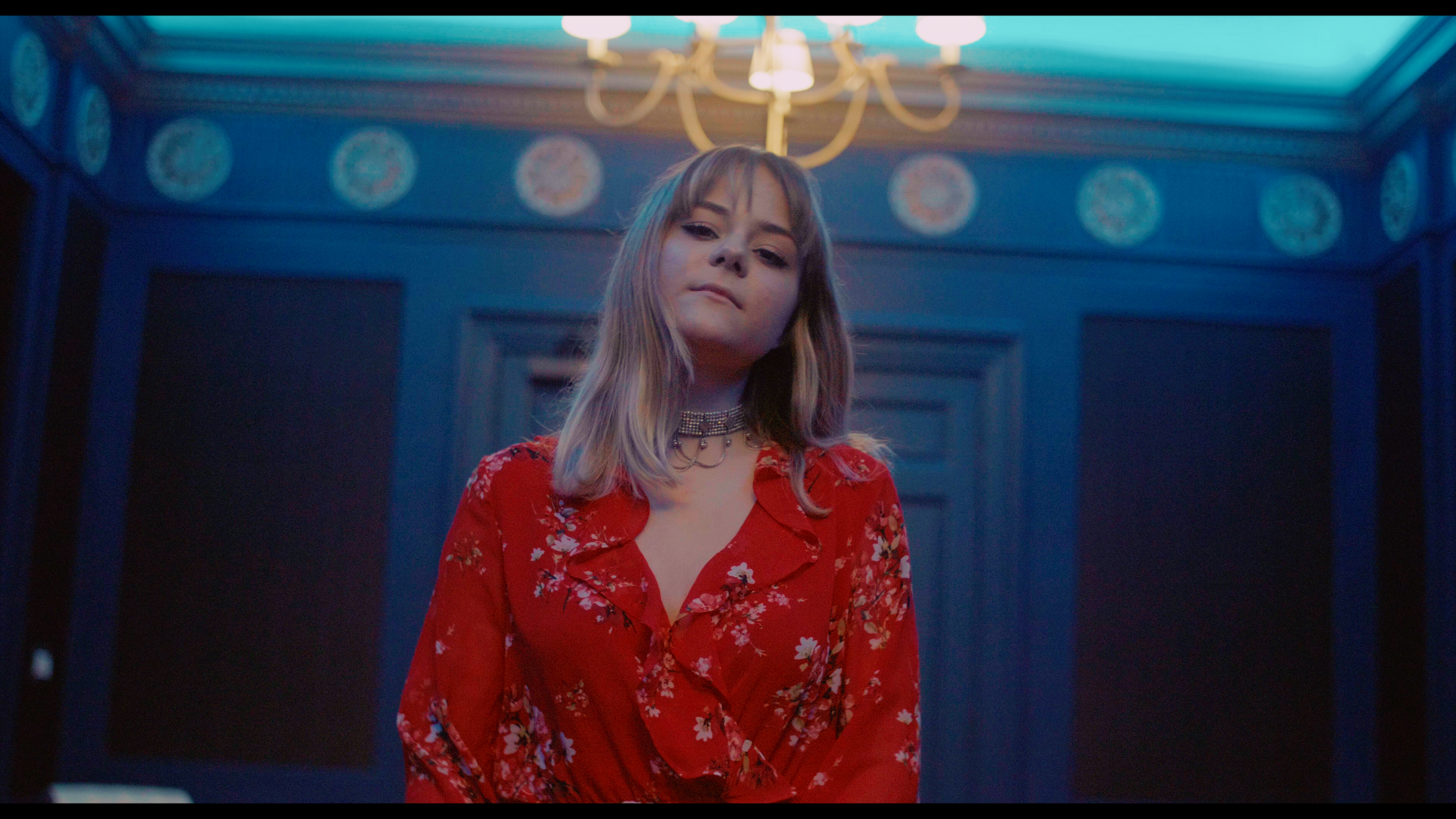

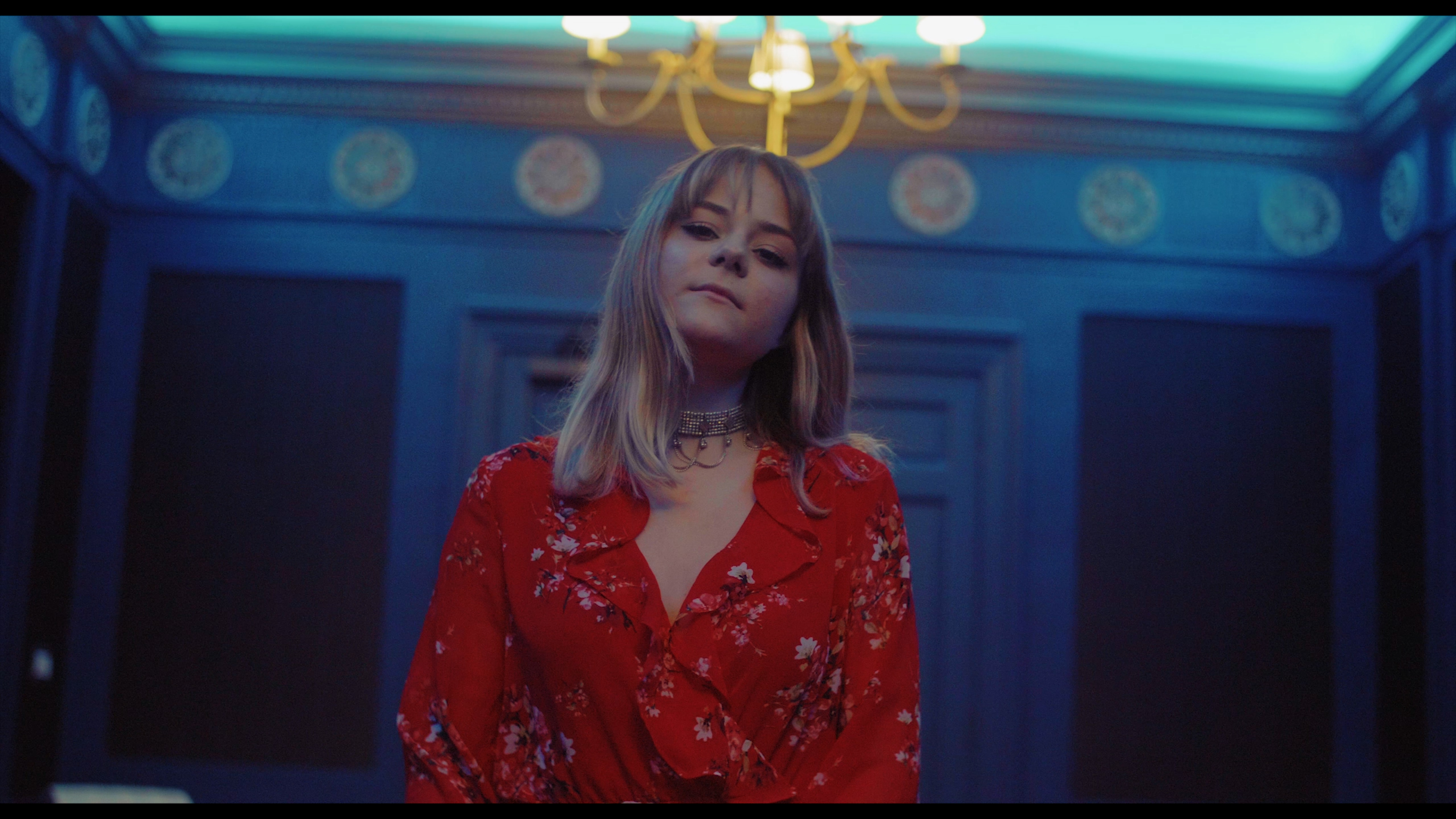

Sage Posted April 20, 2018 Author Share Posted April 20, 2018 Hey @Rikoshet You'll only need one instance of Lumetri - the 'Basic Correction' section can accept the [PRE] technical conversions, and the 'Creative' section can accept the GHa conversions. Then, in the Basic Correction section, any needed white balance adjustment may be made, which will stack inbetween the [PRE] and GHa conversions. You may then right click on Lumetri, and 'Save Preset' for use later (w/ a title like "8-bit Daylight (Soft)", etc.) This will save the step of having to load two separate files. A lumetri effect may be copied and pasted to multiple clips, and an 'Adjustment Layer' can be stretched over several clips in Premiere to apply a single instance of Lumetri to all underneath it for a one-light grade. I'm about to revisit the PDF. A lot is about to change. I've been revisiting the 8-bit Emotion II, updating it to the new color science: PREVIOUS NEW PREVIOUS NEW PREVIOUS NEW buggz and dxotic 2 Link to comment Share on other sites More sharing options...

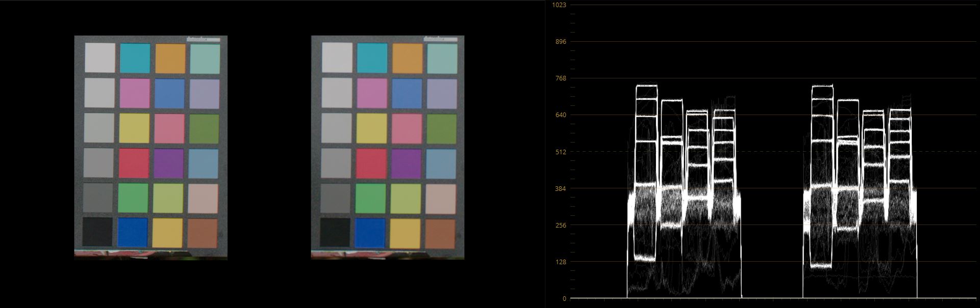

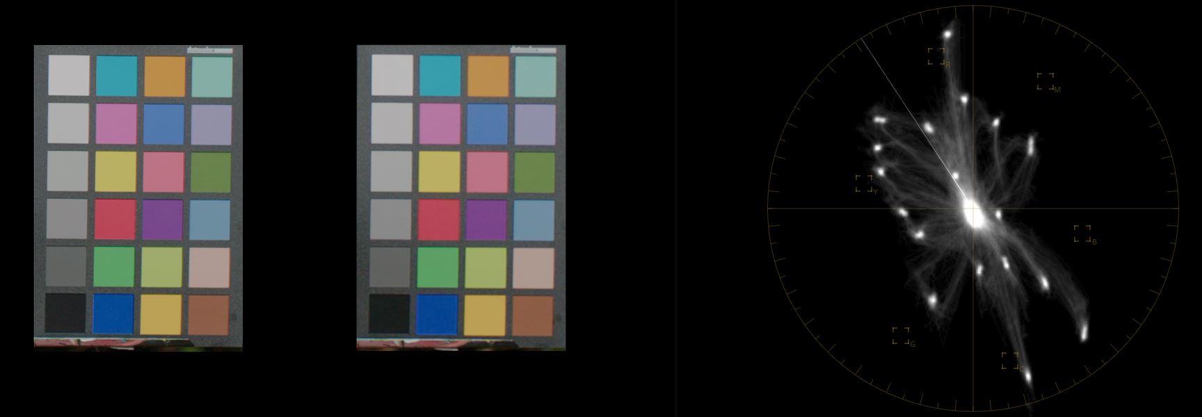

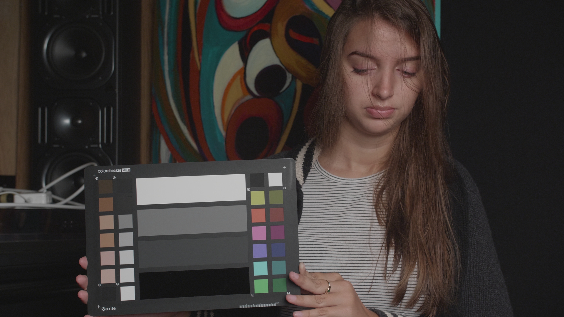

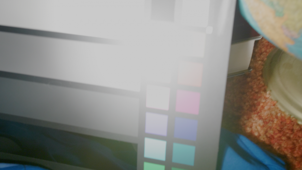

Sage Posted April 25, 2018 Author Share Posted April 25, 2018 @dxotic One neat thing that I geek out over, is that it is so smooth - PREVIOUS NEW And the PREs are so much more accurate (8 bit/Premiere/photo styles) - PREVIOUS NEW - 8 bit Premiere PRE at work JeremyDulac, Jonesy Jones, deezid and 1 other 4 Link to comment Share on other sites More sharing options...
