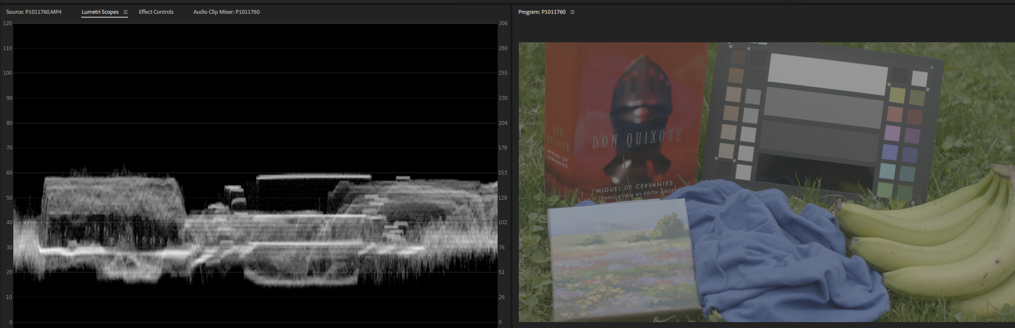

Following up on this, I've been testing AE with Premiere, and have found that the default 'none' setting is correct for Color Settings.
Is it native Log, or encoded to an intermediate format?
V2 Day exposure handling is notably different, and surprising at first - but when you get familiar with it, you'll love it. It's like 'swimming' in dynamic range
Here's an example of VLog with middle gray (that upper gray line) a bit above 40 IRE (you can safely target 40, this is a bit high)
