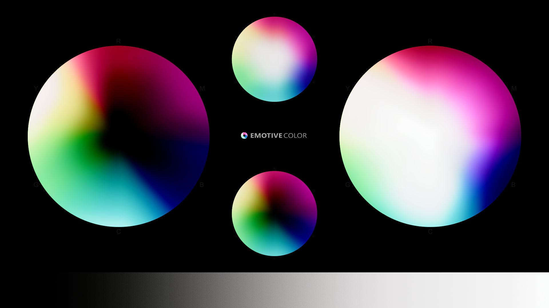

Sage Posted April 15, 2020 Author Share Posted April 15, 2020 The V4 email should be out to everyone; if you haven't received it please let me know. A month ago, my father was diagnosed with advanced colon cancer at the same time that the virus situation was taking off, and life was thrown into disarray. March is colon cancer awareness month, and we are aware now (get screened every 10 years, starting at 50) The GH5S is, at last, supported. V4: Emotive Color Component ('EC709') - Remade in 'HDR', preserving intense values (exceeding 0.0-1.0), that are incorporated into final Rec709 envelope - Using the new engine, Arri Rec709 primaries are recreated at lower saturation, while 'projecting' this primary behavior to HDR gamut extents (beyond Arri Rec709 gamut clipping) - Raised highlight ceiling for Main (average between Soft and Linear) - Significantly refined saturation envelope for Main and Linear (& Soft, to a lesser extent) Core LogC - Remade with new engine (Incorporates initial baseline HSL conform) - Fixed chart scan error that added 1/18th incorrect neighboring sample value to each sample average (hidden mistake in my very earliest code) (Corrects for persistent slight inaccuracies despite multipass, such as magenta bias of shadow skin tone in Tungsten) - Fully linearized highlight rolloff (true to LogC) with maximal detail retention (effective highlight DR increase) - New smoothing algorithm (incorporated into engine) - 12 passes, combining two hue-aware algorithms for new smoothness standard while preserving hue lines - Most extreme gamut is now directly measured and preserved (i.e. colored Leds in night environments) Misc. - Added Exposure Compensation [PRE]s - actual exposure color conversions for use ahead of the conversion (interpolated from sample data, incorporating rolloff) - Added Auto Black Level POSTs - for use following the conversion; quickly conform black level in any NLE (No accompanying relative hue/saturation distortion whatsoever, unlike standard luma tools) - Remade all PREs with new engine, taking new NLE measurements to accommodate NLE profile rendition shifts since original release - Direct monitoring variations included for HLG and Cine-D, and VLog external monitoring variation (includes levels fix) - Rewrite of Pdf (for Gen.4) - Direct FCPX support added (with distinct PREs and Pdf) - Significantly more efficient file sizes - 16 bit Gradient Chart included to test smoothness of theoretical & far gamut, and reveal pipeline banding issues - Each file is now unique to its owner at coordinate level Wild Ranger, buggz, PannySVHS and 4 others 4 3 Link to comment Share on other sites More sharing options...
