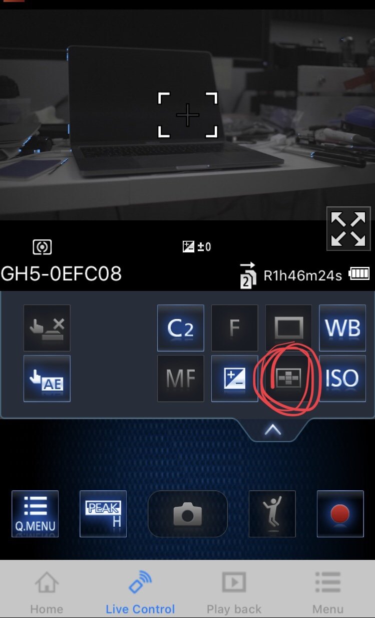

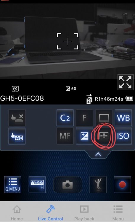

kye Posted November 15, 2019 Share Posted November 15, 2019 Does anyone know how to enable the "af mode/mf" function while operating the camera remotely with the app? It's greyed out for me in the app but works fine when using the camera directly... I'm really hoping I'm just making some silly mistake? Does anyone else have this working? Is it possible? Link to comment Share on other sites More sharing options...
Adam Kuźniar Posted November 15, 2019 Share Posted November 15, 2019 1 hour ago, kye said: Does anyone else have this working? Is it possible? are you using a manual lens ? Since you also can't change the f-stop Link to comment Share on other sites More sharing options...
kye Posted November 16, 2019 Share Posted November 16, 2019 12 hours ago, Adam Kuźniar said: are you using a manual lens ? Since you also can't change the f-stop Yes, manual lens. What confuses me is that I've got "AF Mode/MF" set to a button on the camera and that works just fine, so why it's not available in the app is confusing.. Link to comment Share on other sites More sharing options...
Super Members BTM_Pix Posted November 16, 2019 Super Members Share Posted November 16, 2019 23 hours ago, kye said: Does anyone know how to enable the "af mode/mf" function while operating the camera remotely with the app? It's greyed out for me in the app but works fine when using the camera directly... I'm really hoping I'm just making some silly mistake? Does anyone else have this working? Is it possible? The camera sends the lens capabilities back to the app to let it know which functions to disable. What you have circled there is the AF selector that opens up the options (multi point, single point etc) when you click it . It also enables the "manual" focus controls for AF lenses to be accessed when its active by swiping up. If you put an AF lens on the camera you will see these options appear and then disappear again if you swap to a manual lens. If you put an AF lens on but your overall focus setting in the camera is MF then this option is also greyed out as, of course, you have no need to change AF modes if you are set to MF. kye 1 Link to comment Share on other sites More sharing options...
kye Posted November 16, 2019 Share Posted November 16, 2019 Thanks @BTM_Pix... Bummer. Why they'd use the same icon for a different function is a bit strange, but ok. I'm back to wondering how to nail critical focus when filming myself with MF lenses. I'm thinking it's back to either a large TV from the HDMI out or your DIY EVF solution of a 1080p screen for the raspberry Pi, a USB power brick, and a long HDMI cable. Can I just buy a Pi screen and hook it up to the GH5 with a long HDMI cable and power it via a USB power brick? I'm thinking it'll be like a HDMI cable with a large monitor / dongle on the end.. Link to comment Share on other sites More sharing options...
Super Members BTM_Pix Posted November 16, 2019 Super Members Share Posted November 16, 2019 1 hour ago, kye said: Thanks @BTM_Pix... Bummer. Why they'd use the same icon for a different function is a bit strange, but ok. I'm back to wondering how to nail critical focus when filming myself with MF lenses. I'm thinking it's back to either a large TV from the HDMI out or your DIY EVF solution of a 1080p screen for the raspberry Pi, a USB power brick, and a long HDMI cable. Can I just buy a Pi screen and hook it up to the GH5 with a long HDMI cable and power it via a USB power brick? I'm thinking it'll be like a HDMI cable with a large monitor / dongle on the end.. Yes, it would work exactly like that. To be honest though, for this application, the path of least resistance would be to buy FieldMonitor for iOS or GMonitor for Android and use your phone. Both of them tap into the streaming signal as per the Panasonic app but are full screen and have additional focus tools that will make it far easier to do. A lot less hassle with cabling etc as well. Cheaper too. Link to comment Share on other sites More sharing options...
