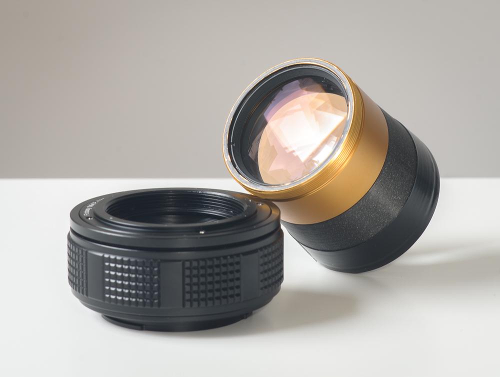

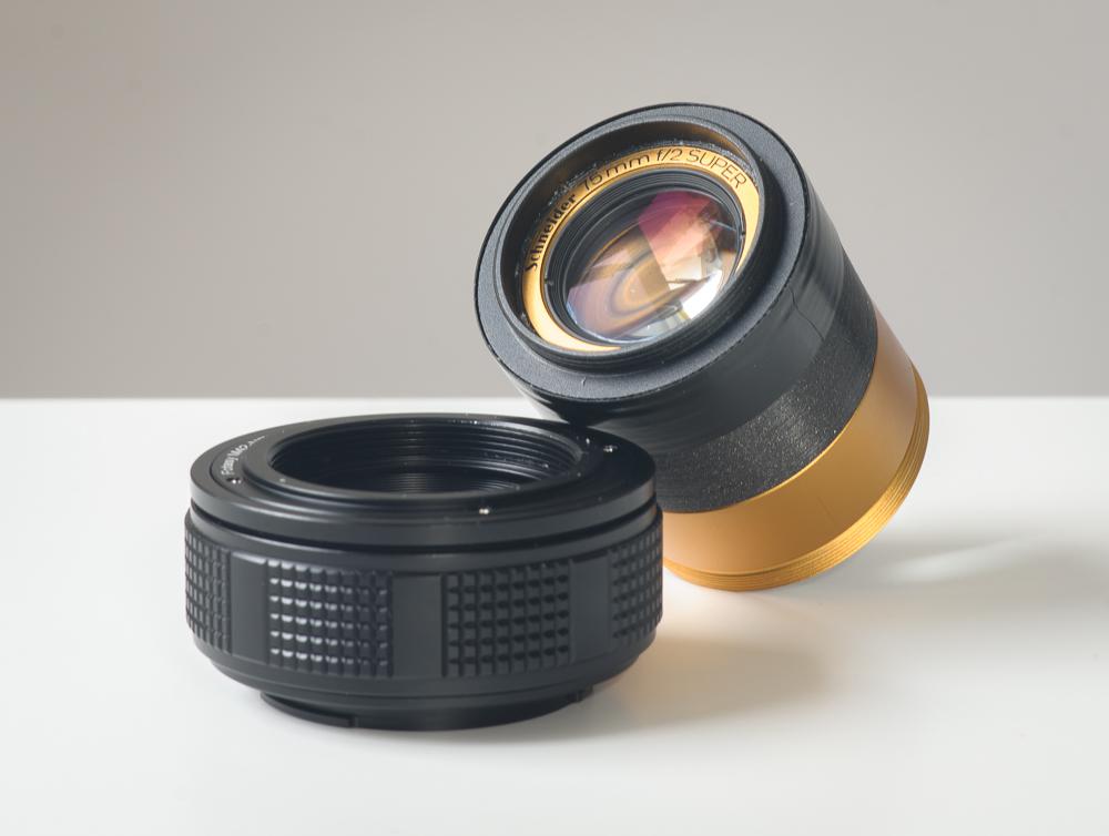

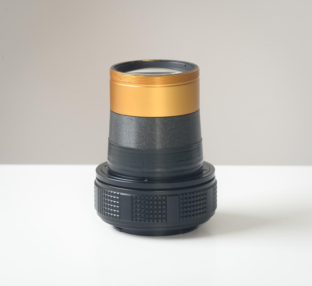

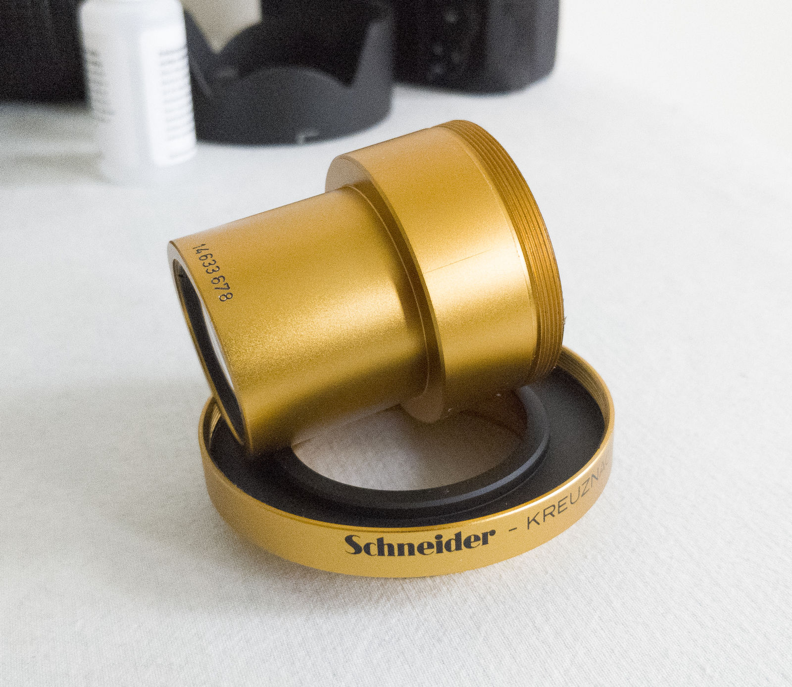

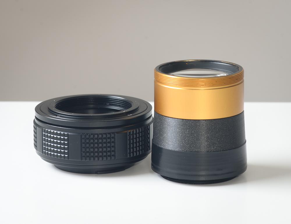

heart0less Posted December 22, 2018 Share Posted December 22, 2018 As some of you may know, I've been on a lookout for a 75mm lens. I almost bought Voigtalnder 75/1.8 Classic, when I thought: hey, if you already use anamorphic adapter that was not meant for cameras at all, why not try to adapt a projection lens, as well? So I did some research and concluded that some modern German optics (Schneider Kreuznach / ISCO) would be the best choice for me. Fortunately, there was a Schneider Kreuznach 75/2 Super listed on eBay. I pulled the trigger and bought it. Here is the funny thing: normally these are attached to the backs of anamorphics. Mine copy was detached from Schneider Cinelux ES 2x With help of my soon-to-be enginneer friend we adapted it to Sony E mount using M42 macro extension tube, M42→NEX Fotasy Helicoid, 3D printed part and a bit of glue. I'm really happy with the results. The image is detailed, bokeh is smooth and pleasing to look at. It needs some contrast and saturation boost in post, though. Thanks to the helicoid, focusing is really smooth and precise. (Bought it from RainbowImaging on eBay, really recommend them, since I got my order just in 2 working days, which is unbelievable, considering they had to ship it from NY to Poland) It covers full frame without any additional crop. With red ISCO Ultra Star I get some soft vignetting in the corners in photo mode (you can judge it by yourself looking at the images; no cropping involved), but I normally add vignetting in post, so it doesn't bother me. The only downside is the fact that there is no aperture. It's fixed at f/2, so the depth of field is a little narrow. If you have any questions, feel free to ask them. Cheers! Kudos to Mike Lee (http://www.mike-lee.org/scripts/camera/main.htm) whose articles inspired me and resolved many of my doubts. Normally, this little feller looks like this: webrunner5, noone, Emanuel and 3 others 5 1 Link to comment Share on other sites More sharing options...
mercer Posted December 22, 2018 Share Posted December 22, 2018 @heart0less that looks wicked. Great job. Would that set up work with EF? It should, I think...? Link to comment Share on other sites More sharing options...
heart0less Posted December 22, 2018 Share Posted December 22, 2018 20 minutes ago, mercer said: @heart0less that looks wicked. Great job. Would that set up work with EF? It should, I think...? I don't see any reason why it wouldn't. You just have to adjust it so you can focus at infinity when the helicoid is not expanded and voila! ( : Link to comment Share on other sites More sharing options...
