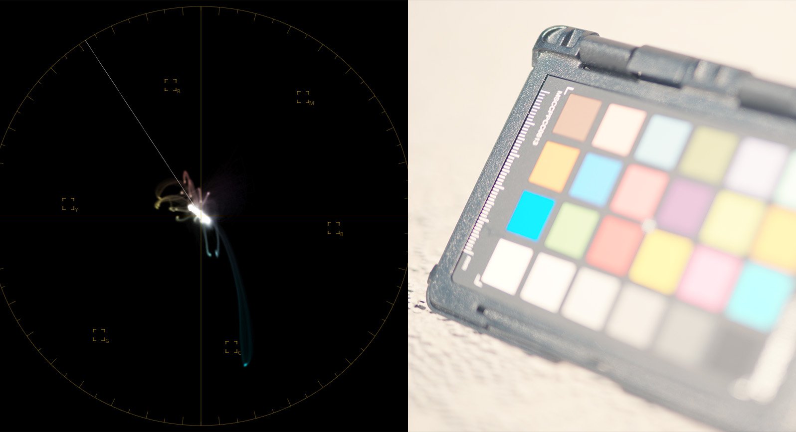

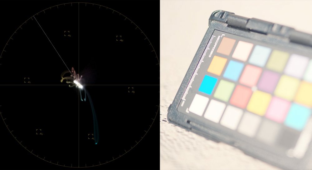

deezid Posted September 10, 2019 Share Posted September 10, 2019 16 hours ago, funkyou86 said: Thanks! I also shot a talent [who wore a blue dress] in direct sunlight, now I'm wondering why didn't that happened to my footage. I'm still new to S1 so probably have to do some additional tests... This just happened with my colorchecker in direct sunlight Whenever there's something blue and slightly overexposed in your shot (like objects outside a window) be prepared to run into issues like that. There's no roll-off for blues at all, almost like they did forget about adding it... Original clips https://drive.google.com/open?id=1IlfWM7jDVwh5GMAQk7RnLfp_FCscAojP omega1978 and funkyou86 1 1 Link to comment Share on other sites More sharing options...
Patrick B. Posted September 10, 2019 Share Posted September 10, 2019 I thought part of the advantage of having full v-gamut was to avoid things like this. ? Link to comment Share on other sites More sharing options...
deezid Posted September 10, 2019 Share Posted September 10, 2019 50 minutes ago, Patrick B. said: I thought part of the advantage of having full v-gamut was to avoid things like this. ? Ironically it's the only profile on the S1 showing this issue Patrick B. 1 Link to comment Share on other sites More sharing options...
