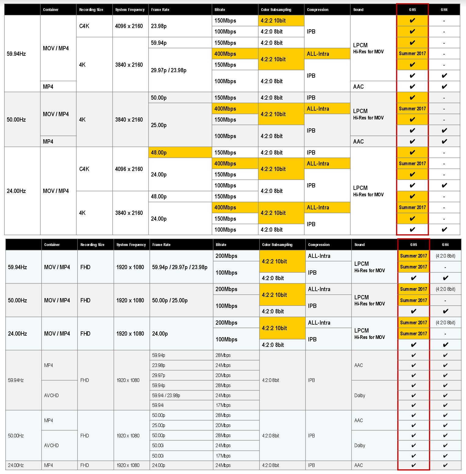

Simon Shasha Posted January 10, 2017 Share Posted January 10, 2017 Wait a second, 4K @ 48FPS in 10bit? Did I read that correctly? Link to comment Share on other sites More sharing options...
Stanley Posted January 10, 2017 Share Posted January 10, 2017 25 minutes ago, Simon Shasha said: Wait a second, 4K @ 48FPS in 10bit? Did I read that correctly? Looks like you did. Geoff CB 1 Link to comment Share on other sites More sharing options...
Claes Lind Posted January 10, 2017 Share Posted January 10, 2017 You are the first one I've seen reporting 4k 10bit at 48p. I can't really make sense of the chart, as it looks like 48p would be only 150 maps, but part of the summer 2017 firmware. Are you sure you're reading this chart correctly? Was it confirmed by Panasonic? Also, would it be selected in VF? DCI 4k 10bit at 48p would be massive.. Already decided to buy but didn't expect this! Link to comment Share on other sites More sharing options...
MaxAperture Films Posted January 10, 2017 Share Posted January 10, 2017 The chart is very confusing in how it groups the codecs to the frame rate. If this thing delivers 4K 48P @ 10 bit 4:2:2 after the update I'll be ecstatic. And if Matt confirmed that with Andrew already, I'm sure it's legit. He rarely gets tripped up on specs. Link to comment Share on other sites More sharing options...
deezid Posted January 10, 2017 Share Posted January 10, 2017 Yh, I don't see it from the chart either. But it would be amazing indeed!! Link to comment Share on other sites More sharing options...
Stanley Posted January 10, 2017 Share Posted January 10, 2017 8 minutes ago, deezid said: Yh, I don't see it from the chart either. But it would be amazing indeed!! 24.00HZ, MOV/MP4,4096x2160,48P,400Mbps,422 10 Bit,All- Intra, Summer 2017.... Follow The Yellow grid. Well spotted Simon. webrunner5 1 Link to comment Share on other sites More sharing options...
Claes Lind Posted January 10, 2017 Share Posted January 10, 2017 20 minutes ago, Stanley said: 24.00HZ, MOV/MP4,4096x2160,48P,400Mbps,422 10 Bit,All- Intra, Summer 2017.... Follow The Yellow grid. Well spotted Simon. I'm still hesitant. I'm reading 48p the same way as 50p and 59.94p is listed above it, with the chart indicating 150mbps. If you look at the top where you have 23.98 it's listing two bitrates. And then 3 bitrate options for all regular framerates. If 48p was possible in 400mbps wouldn't that be listed under 150mbps? Let's see if Andrew can comment and clear it up if it's been confirmed from Panasonic Link to comment Share on other sites More sharing options...

Don Kotlos Posted January 10, 2017 Share Posted January 10, 2017 From the info that Panasonic has in these charts, it looks like 48p will be just 150mbps 4:2:0 8bit IPB. 1 hour ago, tihon84 said: Best example of hi bitrate h265fail H265 in the examples that you posted is 2% of the original H264 file size, and at these rates of course you are going to loose some detail compared to the original. The quality also depends on the implementation of each codec. The BBC R&D video coding research team wrote a paper on this and concluded: "It can therefore be concluded that the HEVC standard is able to deliver the same subjective quality as AVC, while on average (and in the vast majority of typical sequences) requiring only half or even less than half of the bit rate used by AVC. This means that the initial objective of the HEVC development (substantial improvement in compression compared with the previous state of the art) has been successfully achieved." Also, H265 can have an intra frame version the same way H264 has From Wikipedia: "The maximum bit rate of the profile is based on the combination of bit depth, chroma sampling, and the type of profile. For bit depth the maximum bit rate increases by 1.5× for 12-bit profiles and 2× for 16-bit profiles. For chroma sampling the maximum bit rate increases by 1.5× for 4:2:2 profiles and 2× for 4:4:4 profiles. For the Intra profiles the maximum bit rate increases by 2×" And in the original H265 standards look for the "general_intra_constraint_flag". Kisaha 1 Link to comment Share on other sites More sharing options...

theSUBVERSIVE Posted January 10, 2017 Share Posted January 10, 2017 Since the AVC Ultra up to 30p is 400Mbps, it makes sense to be H.264. As for 48p, it doesn't look like it's 10-bit 422, a H.264 400Mbps All-I codec wouldn't be enough for 48p, for AVC Ultra it would be around 640Mbps and even at a lower bitrate codec like Sony's XAVC-I, you would still need 480Mbps. Since there is no mention of 500-700Mbps All-I codec, I doubt that 48p will be All-I 10bit 422. On the other hand Panasonic could very well provide a 200-240Mbps IPB 10-bit 422 codec for 4K60p if they wanted. Link to comment Share on other sites More sharing options...
