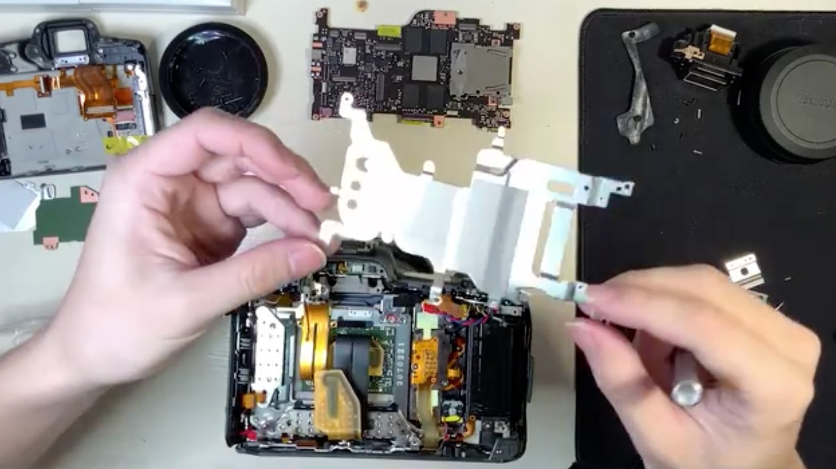

UncleBobsPhotography Posted August 10, 2020 Share Posted August 10, 2020 Those thermal pads doesn't lead the heat anywhere... 🤔 The only real connection between the hot parts and the body seems to be around the screw holes, that's way too far for the heat to travel before reaching the chassis. Link to comment Share on other sites More sharing options...

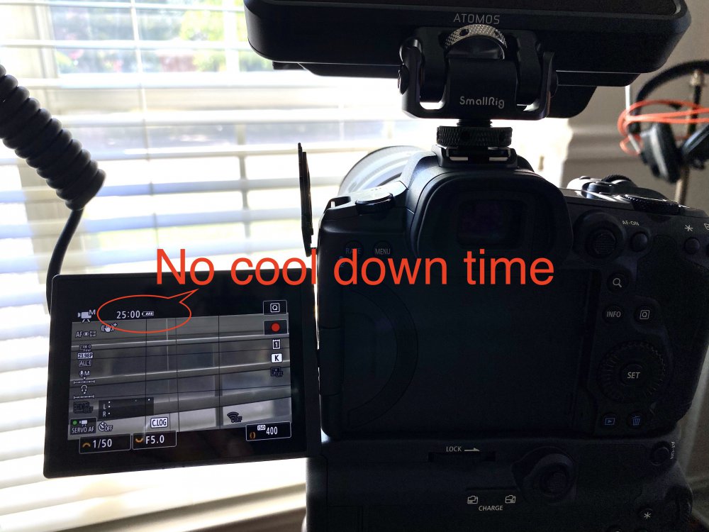

Stanly Posted August 10, 2020 Share Posted August 10, 2020 1 hour ago, Andrew Reid said: I think the 4K HQ option gets deactivated when the Ninja V is connected too Nope – that is 4K HQ being output to Ninja V for sure mechanicalEYE 1 Link to comment Share on other sites More sharing options...
hijodeibn Posted August 10, 2020 Share Posted August 10, 2020 41 minutes ago, Stanly said: Nope – that is 4K HQ being output to Ninja V for sure Same guy made a comparison between 4K and 4KHQ and looks like 4K is totally usable. So I will be waiting for Andrew's feedback about it, we could get several workarounds to use this camera in most of the situations. Link to comment Share on other sites More sharing options...
Stanly Posted August 10, 2020 Share Posted August 10, 2020 9 minutes ago, hijodeibn said: comparison between 4K and 4KHQ and looks like 4K is totally usable That topic has nothing to do with the issue: R5 in 4KHQ overheats while browsing menus and doesn't when filming externally without a card. BenEricson 1 Link to comment Share on other sites More sharing options...
Nezza Posted August 10, 2020 Share Posted August 10, 2020 All these so called 'workarounds' really are an olympic sized exercise in turd polishing. ajay 1 Link to comment Share on other sites More sharing options...
hijodeibn Posted August 10, 2020 Share Posted August 10, 2020 1 minute ago, Stanly said: That topic has nothing to do with the issue: R5 in 4KHQ overheats while browsing menus and doesn't when filming externally without a card. of course it related to find a solution, if we can use an external recorded to get 4KHQ for 4 continuos hours that's obviously a solution to use the camera in fiction, if we also get 4K internal with excellent quality for many hours, then the camera could be also usable in weddings, so we need a test from a reliable source, which for me will be Andrew's review, you have to look the camera as a whole, not by parts. Link to comment Share on other sites More sharing options...
