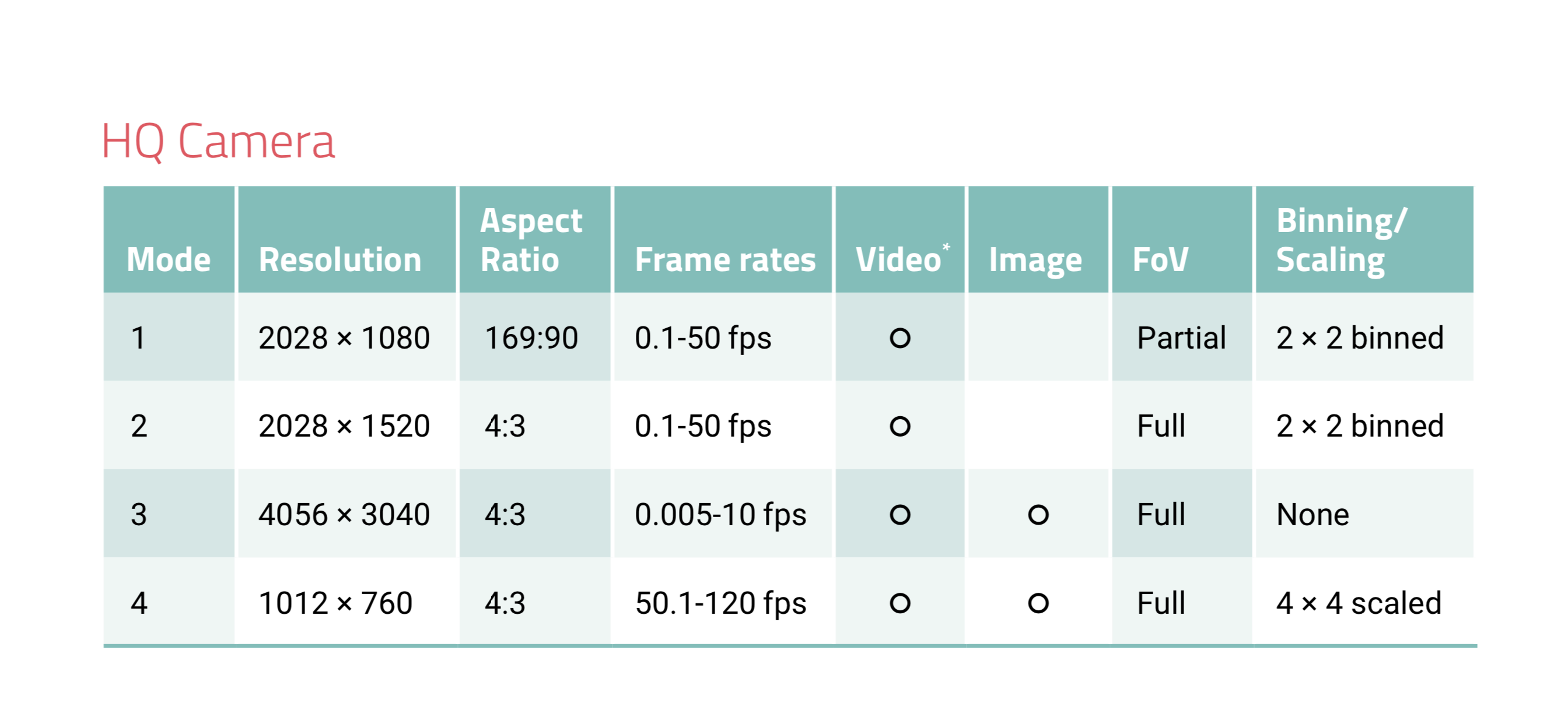

Administrators Andrew - EOSHD Posted May 1, 2020 Administrators Share Posted May 1, 2020 https://www.raspberrypi.org/products/raspberry-pi-high-quality-camera/ Specs here imply it does output RAW? Sony IMX477R stacked, back-illuminated sensor, 12.3 megapixels, 7.9 mm sensor diagonal, 1.55 μm × 1.55 μm pixel size Ouput: RAW12/10/8, COMP8 Back focus: Adjustable (12.5 mm–22.4 mm) Lens standards: C-mount, CS-mount (C-CS adapter included) IR cut filter: Integrated Ribbon cable length: 200 mm Tripod mount: 1/4”-20 Link to comment Share on other sites More sharing options...
androidlad Posted May 1, 2020 Author Share Posted May 1, 2020 35 minutes ago, Andrew Reid said: https://www.raspberrypi.org/products/raspberry-pi-high-quality-camera/ Specs here imply it does output RAW? Sony IMX477R stacked, back-illuminated sensor, 12.3 megapixels, 7.9 mm sensor diagonal, 1.55 μm × 1.55 μm pixel size Ouput: RAW12/10/8, COMP8 Back focus: Adjustable (12.5 mm–22.4 mm) Lens standards: C-mount, CS-mount (C-CS adapter included) IR cut filter: Integrated Ribbon cable length: 200 mm Tripod mount: 1/4”-20 Yes obviously, those RAW formats are standard in MIPI CSI-2 interface protocol. Link to comment Share on other sites More sharing options...
Administrators Andrew - EOSHD Posted May 1, 2020 Administrators Share Posted May 1, 2020 I see. But is it bayer RAW, can it be recorded to a card, or doesn't the SDK / LSI handle it? Link to comment Share on other sites More sharing options...
Caleb Genheimer Posted May 1, 2020 Share Posted May 1, 2020 I just want a board sensor that covers 16mm and has dual pixel AF so I can hack my 16mm camera apart and replace the ground glass with a CMOS and have reliable AF on a film camera. KnightsFan, jack jin, tweak and 1 other 2 2 Link to comment Share on other sites More sharing options...
gt3rs Posted May 1, 2020 Share Posted May 1, 2020 4 hours ago, Andrew Reid said: I see. But is it bayer RAW, can it be recorded to a card, or doesn't the SDK / LSI handle it? On the Pi the max video recoding seems 1080p. On Pi 4 via usb 3 you could connect a ssd so saving on storage would be possible. I believe the CSI is 4 Gbits/s so if I did the math right it should fit 12bit x 12mpix x 24fps not sure if the CSI is the bottle neck. Link to comment Share on other sites More sharing options...

tweak Posted May 2, 2020 Share Posted May 2, 2020 7 hours ago, gt3rs said: On the Pi the max video recoding seems 1080p. On Pi 4 via usb 3 you could connect a ssd so saving on storage would be possible. I believe the CSI is 4 Gbits/s so if I did the math right it should fit 12bit x 12mpix x 24fps not sure if the CSI is the bottle neck. That looks interesting. 2028x 1520 4:3 in 48fps Raw would suit my needs well. I don't even need a screen, just ability to record to SD. That could be a pretty small package. Link to comment Share on other sites More sharing options...
