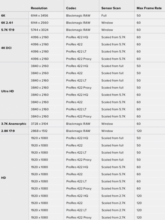

Anaconda_ Posted August 16, 2019 Share Posted August 16, 2019 When shooting 4k or 1080p on the P6k, does it crop the sensor, or downscale from the whole sensor? I assume since they're ProRes only they downscale, but then what about 1080p120? Does that window the sensor? If it does, what's the FOV compared to the P4k shooting 1080p120? hansel 1 Link to comment Share on other sites More sharing options...
Kisaha Posted August 16, 2019 Share Posted August 16, 2019 34 minutes ago, Anaconda_ said: When shooting 4k or 1080p on the P6k, does it crop the sensor, or downscale from the whole sensor? I assume since they're ProRes only they downscale, but then what about 1080p120? Does that window the sensor? If it does, what's the FOV compared to the P4k shooting 1080p120? https://www.newsshooter.com/2019/08/09/blackmagic-design-releases-pocket-cinema-camera-6k-with-ef-mount/#disqus_thread Can you find your answer on the tables of this article? Anaconda_ 1 Link to comment Share on other sites More sharing options...
Anaconda_ Posted August 16, 2019 Share Posted August 16, 2019 Thanks @Kisaha that does answer my question. 1080p120 is downscaled from the 2.8k crop, so will definitely have wider FOV than the P4K. Also interesting to note: according to the charts this camera will perform slightly better in PAL areas, as all 50p frame rates are down sampled from the full sensor, but 60p is down sampled from 5.7k. Granted, there's not much in it at all, but interesting that 50p will have more in the frame than anything 60p. Kisaha 1 Link to comment Share on other sites More sharing options...
