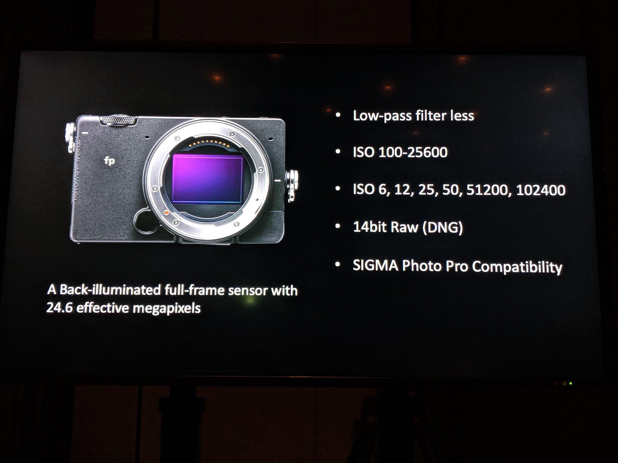

Sigma FP
Another interesting tidbit, it does 18fps in stills mode. If those are raw images, that's close to a9 territory.
From Sigma:
“Able to shoot whenever you want, wherever you want”―to realize this concept, the SIGMA fp incorporates a construction without a mechanical shutter for quiet shooting. This allows shooting without worrying about noise in a situation where one would have hesitated with a conventional camera because of its shutter sound. It gives no shutter shock even when shooting in quick succession at a frame rate of 18 frames/sec. eliminating even the tiniest shakes."

Holy ISO range.
If this is possible in cine-mode, then it's basically like having an internal ND (in terms of light gathering). In bright conditions at ISO 400 and f2.8 (what I often shoot), I usually need 6-stops of light reduction (ND1.8). So... 400 > 200 > 100 > 50 > 25 > 12 > 6... well, there ya go.
Though, I'm guessing it is for stills only. And dynamic range probably takes a hit.

4 hours ago, Andrew Reid said:
Foveon has amazing film qualities and colour, but they really need to sort the low light out before I use a Foveon camera as my main one.
Honestly, they can lock them in at iso100 for all I care. Been dreaming a long time for a base iso 50 or even 25 in a camera.
The ISO 6 looks tasty even though I suspect it's a pull from 100.
Share this post
Link to post
It uses IMX410, just like Z6/S1/Zcam F6
Due to the removal of a mechanical shutter, flash sync speed is an appalling 1/30s.
ISO 6 is achieved by in-camera 16-frame stacking.
