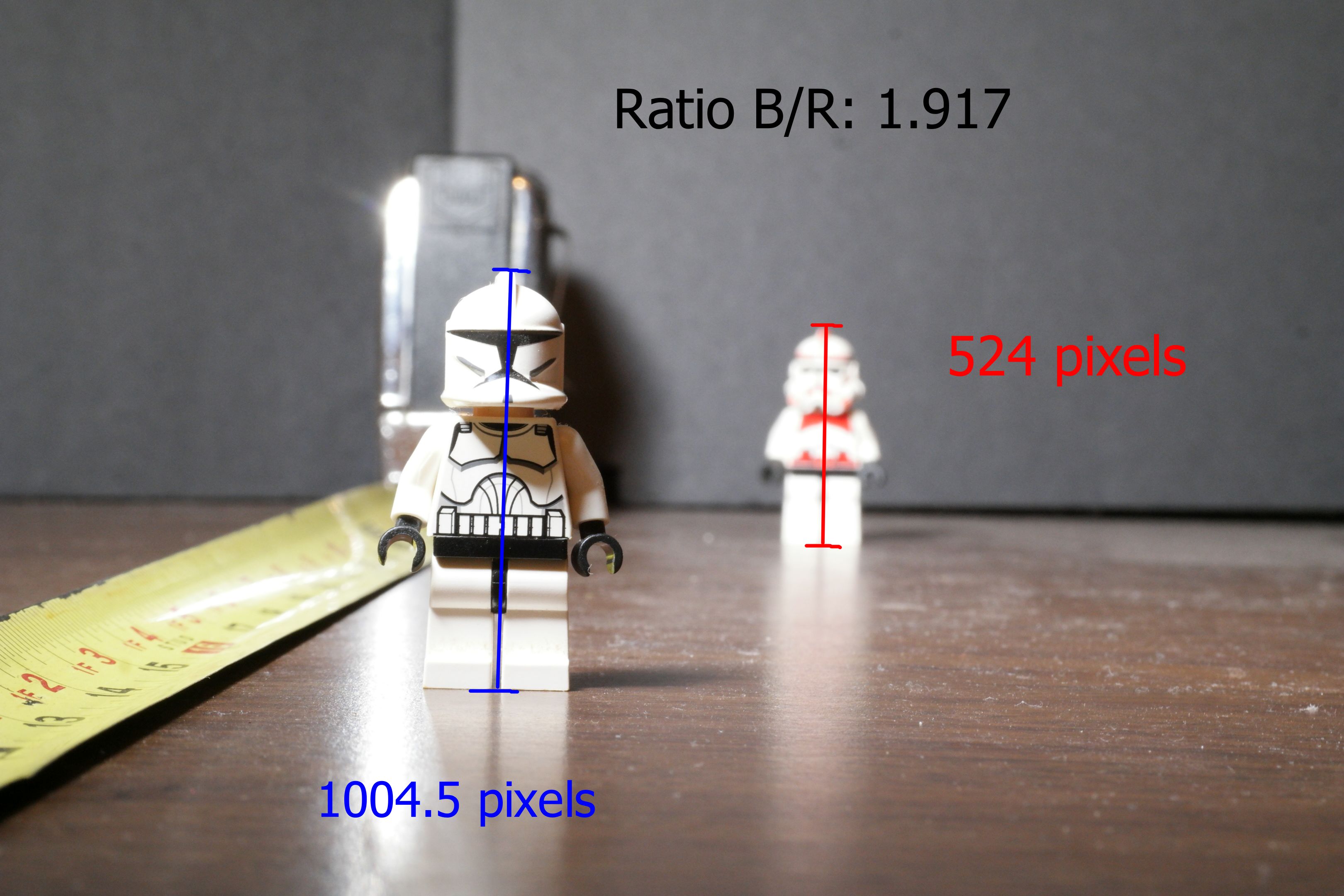

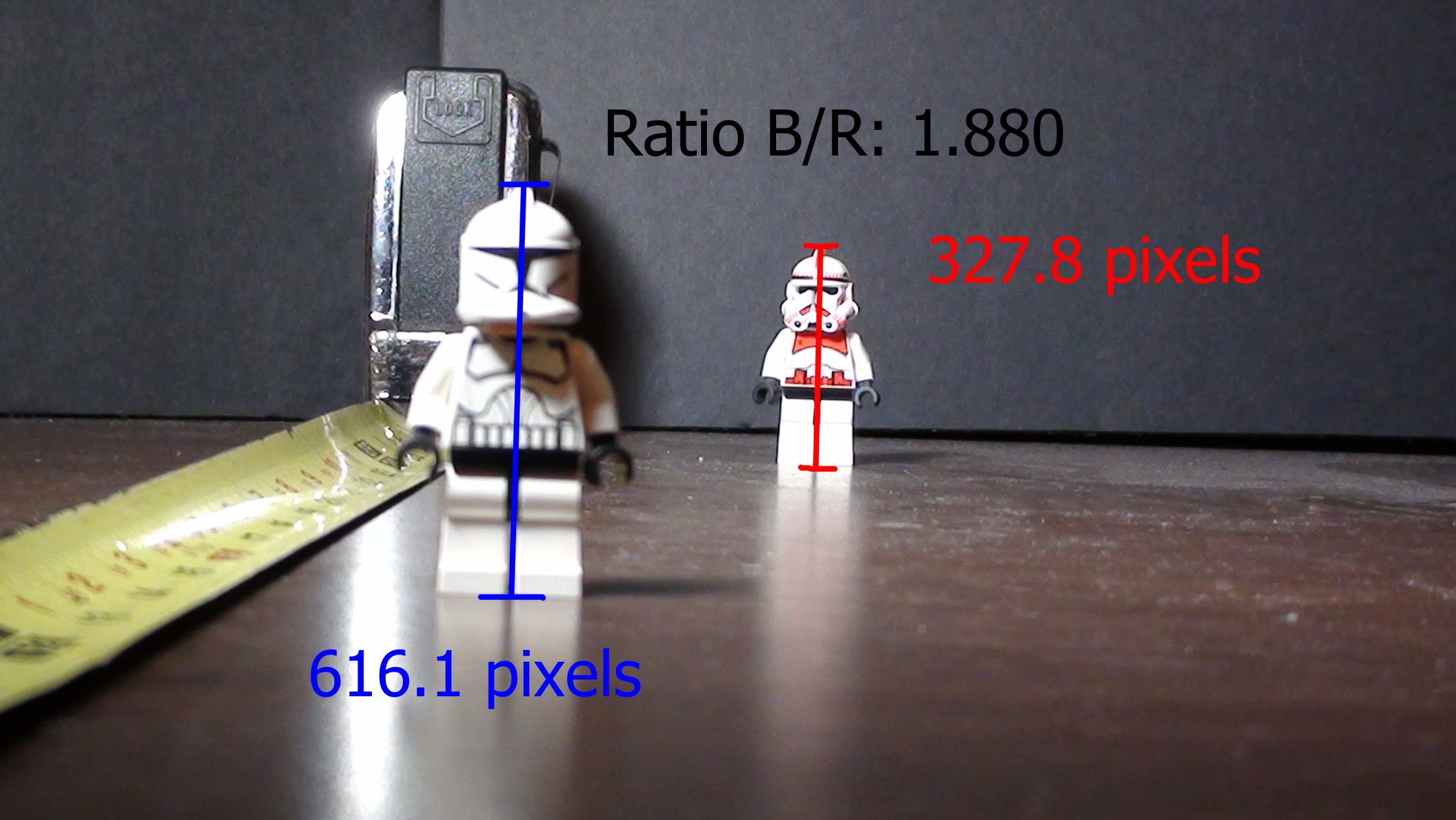

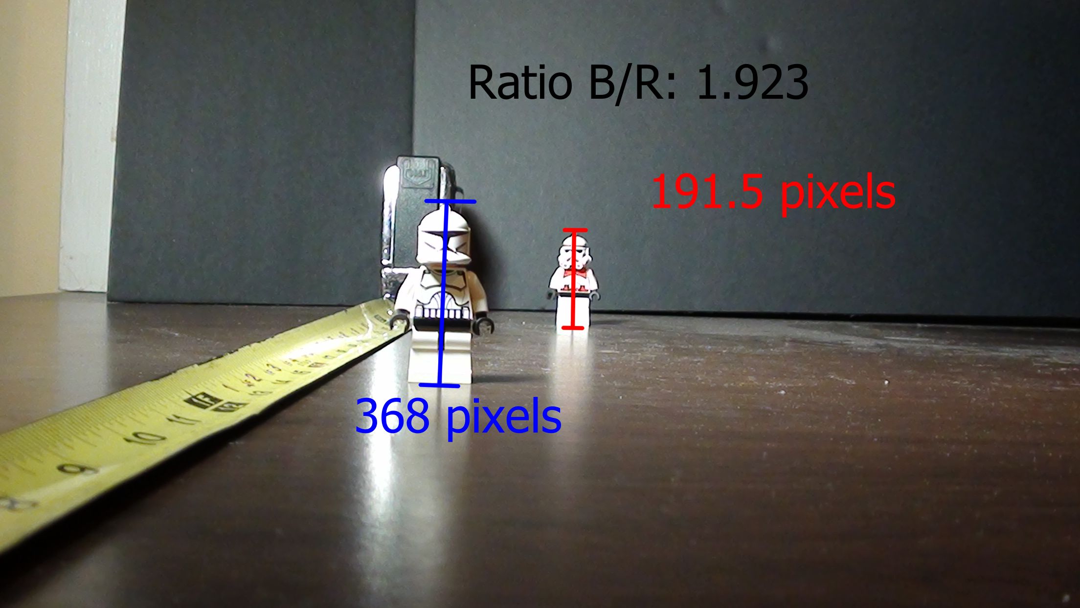

KnightsFan Posted May 19, 2018 Share Posted May 19, 2018 @blondini No, perspective distortion is only affected by distance from the camera to the subject. No matter what sensor/lens combination you use, if the camera and the subjects don't move, then the ratio of the size of two subjects will remain the same. I did a quick and dirty test to illustrate. It's a little imprecise (the camcorder would NOT focus on the guy in front...) For all three images the camera is in the same place. I suspect the small discrepancies in ratio (2.2% error) are mainly due to moving parts inside the camcorder when it zooms, which changes its actual distance from the subject. But this is an easy thing to test yourself. First image is a 4mm lens on a 1/4 type sensor Second image is a 55mm lens on an APS-C sensor As you can see, the ratio of the figures is the same. You could even use a wider lens and the ratio remains, because the distance has not changed: Third image is a 2mm lens on the 1/4 type sensor. Quote from Wikipedia: Quote Note that linear perspective changes are caused by distance, not by the lens per se – two shots of the same scene from the same distance will exhibit identical perspective geometry, regardless of lens used. However, since wide-angle lenses have a wider field of view, they are generally used from closer, while telephoto lenses have a narrower field of view and are generally used from farther away. 1 hour ago, Tiago Rosa-Rosso said: if you would film this with a smaller sensor and place the camera in the exact same place and try to have the same frame you would have to use a different lens, maybe a 1000mm, then the plane wouldn't look so close to the actors. Yes, it would. As long as the camera is in the same place, the relative size of the plane compared to the people will remain the same regardless of the lens or sensor. If you don't believe me or my Legos, go try it yourself! Nathan Gabriel, Don Kotlos, Timotheus and 2 others 4 1 Link to comment Share on other sites More sharing options...
