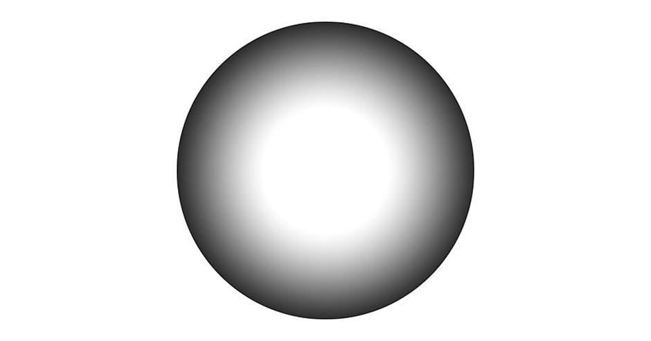

Don Kotlos 912 Posted May 31, 2018 Share Posted May 31, 2018 24 minutes ago, noone said: I am forever searching for a 43mm apodization filter. DIY: You can create a gradient in photoshop and print it on a translucent paper. Then cut it out and place it as close to the back glass element (closest to the aperture blades). Or use this image instead of doing it in Photoshop: Quote Link to post Share on other sites
noone 608 Posted May 31, 2018 Share Posted May 31, 2018 Thanks, I have seen those before when looking for a filter but while I am trying for a bit of a kludge, I do want a "real" filter with top class glass. I might just buy the largest I can find and try and use it in APSC mode though it would probably be sticky taped into the adapter. Quote Link to post Share on other sites

no_connection 114 Posted June 1, 2018 Share Posted June 1, 2018 17 hours ago, tupp said: On the other hand, the background is softer with the APD filter in every set except for the one at f5.6. Softer and size are two different things. 17 hours ago, tupp said: However, that gradation of the aperture edge is affecting DOF, and the character of that gradation (combined with the mechanical iris) is one of several variables ignored by the equivalency formula. You are grasping at straws. You are looking for a unified theory and are sad when all it does it describe acceleration. You don't need to worry about light speed when all you do is dropping apples. And compare it to other apples. 12 hours ago, Don Kotlos said: print it on a translucent paper. Problem is it's not exactly optical grade, maybe get some of that meant to print on t-shirt and then transfer by heat, maybe even sprinkle toner on a glass filter and bake it. We should make a thread bout it somewhere. Quote Link to post Share on other sites
Don Kotlos 912 Posted June 1, 2018 Share Posted June 1, 2018 I agree there are better ways than printing a pattern on a paper. Using film is a better way if someone still has access to it . You can also use a properly made glass filter like this. At the end of the day, while nothing will surpass the quality of a lens designed to use an apodization filter like the Sony STF, you can still have some fun trying and you never know, it might result in a usable result like the one found in the linke webrunner posted. Quote Link to post Share on other sites
