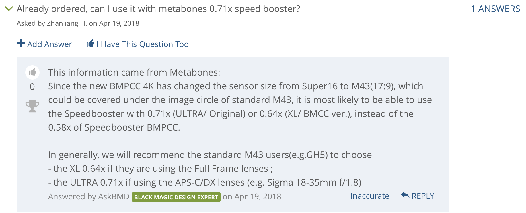

From my understanding, they've been recommending the 0.71x adapter as this will get the best out of the sensor before you start vignetting on aps-c lenses.  While it might be best to wait and see what Metabones come up with, a BM rep has said this: image.thumb.png.b8b8b86e72defea8b9ad4275259a7c5c.png

BMPCC 4K have sensor's diagonal 21.44mm. Metabones 0.64x for BMCC is not suitable for BMPCC 4K because it covers image circle 18.2mm only.
Metabones Nikon G to Micro Four Thirds Speed Booster XL 0.64x have image circle 21.63mm. So it fully covers a new sensor of BMPCC 4K!
Anyone knows image circle of Metabones BMPCC 0.58x Speed Booster? I think it is smaller that IC of BMCC.
Link to post
Metabones will definitely come up with something.
People also need to keep in mind that there are filter stack differences between cameras.  The filter stack on the BMPCC is different than the filter stack on the GH4.  This is what metabones had to say about it...
Quote
Like all Metabones Speed Boosters, the Speed Booster ULTRA m43 is optimized to correctly account for the camera’s filter stack located near the sensor surface3.  This is especially critical at the extremely large apertures made possible by Speed Booster technology.  As a result of this careful optimization, an enormous range of full-frame optics, ranging from vintage film lenses to the latest digital designs, will function flawlessly when adapted to Micro Four Thirds camera bodies.
http://www.metabones.com/article/of/Speed_Booster_ULTRA_0.71x
Link to post

I understand their answer as they don't know exactly if their m4/3 0.64x XL Booster will work with the BMPCC 4K because they don't have a camera at the moment to make a test and don't know its specs to develop a new specific model of their Speed Booster for BMPCC 4K.
I quote Brian's words (designer of Speed Booster) from the BMCuser forum (04-13-2018):
Quote
There are already two Speed Boosters dedicated for M43: The 0.71x Ultra and the 0.64x XL. These should work very well on the 4k Pocket (4kP?) The only reason I can see for custom Blackmagic versions is if the new camera repeats the sins of the old pocket camera by having a non-standard filter pack thickness. Going to a more extreme design than the 0.64x (e.g., 0.63x or less) is a non-starter in my view because I can't maintain the image quality expected from true Speed Boosters.
BMPCC 4K have a sensor's diagonal 21.44mm. And from the Brian's words to make it clear:
Metabones 0.58x BMPCC Speed Booster was designed to cover a 14.6mm.
Metabones 0.64x BMCC Speed Booster was designed to cover a 18.2mm.
Metabones M4/3 Speed Booster XL 0.64x was designed to cover a 21.63mm.
Link to post
The discussion about the sensor stack thickness affects the optimisation of the speed booster (as I understand it)
It means they have to alter their optical design to make certain lenses perform better post speed booster, and I believe this tends to affect the faster lenses or faster apertures at F1.4 and higher.
JB
Link to post
There was a post on one of the other forums where Brian said that he didn't see any need to make a speedbooster as long as Blackmagic used standard filter stack size.  He basically said he didn't want to have to make one.
As long as this is standard (which it hopefully is) then everything should be just fine.
