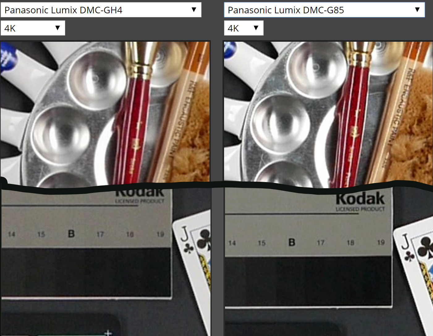

G85 is sharper and cleaner than GH4. GH4 has flatter video and less clipping in HL. Here is comparison details GH4 vs G85 in DPREVIEW video comparison frame in same settings.

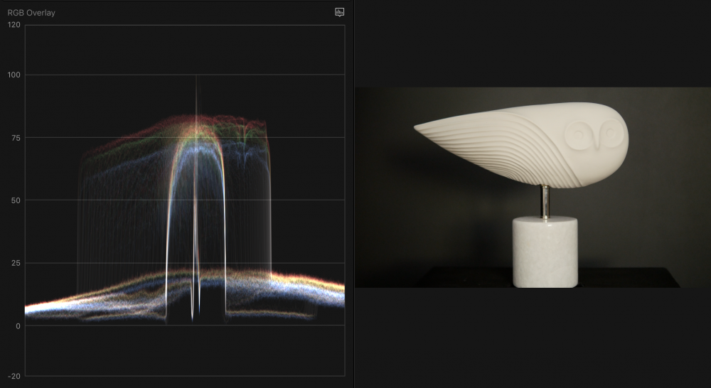

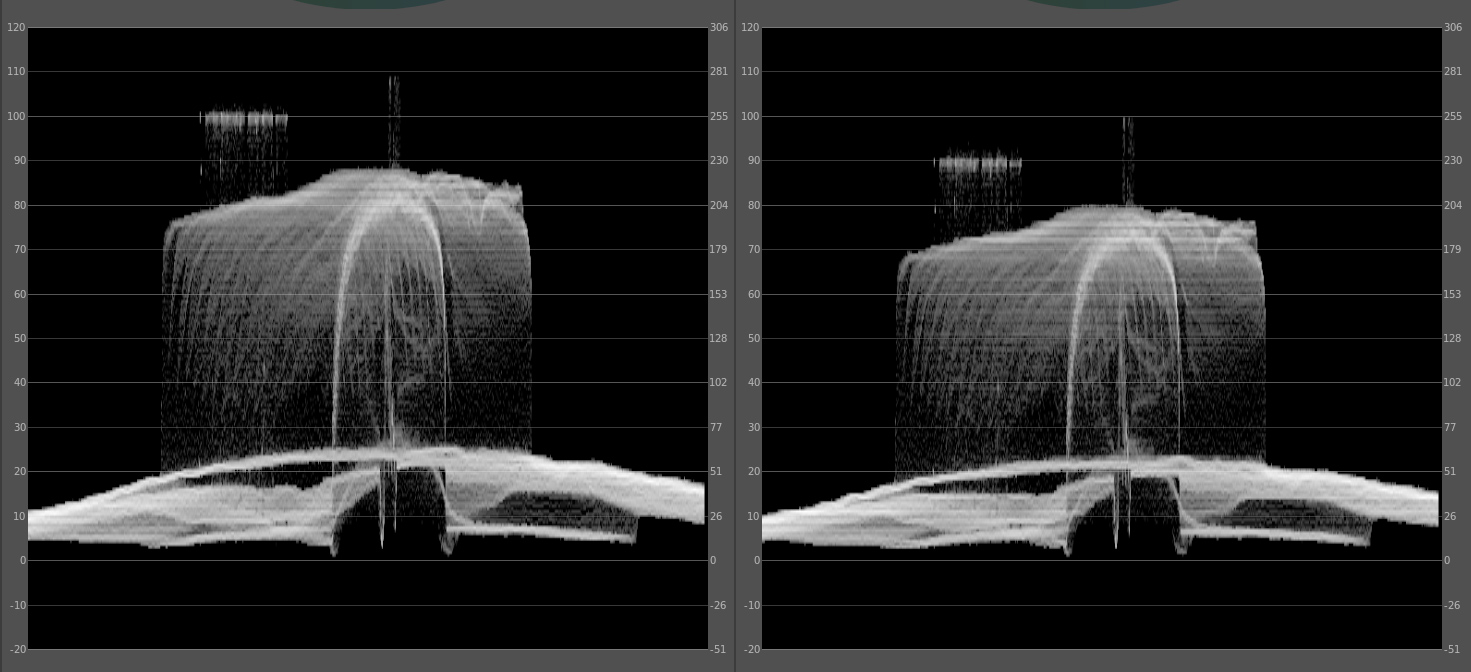

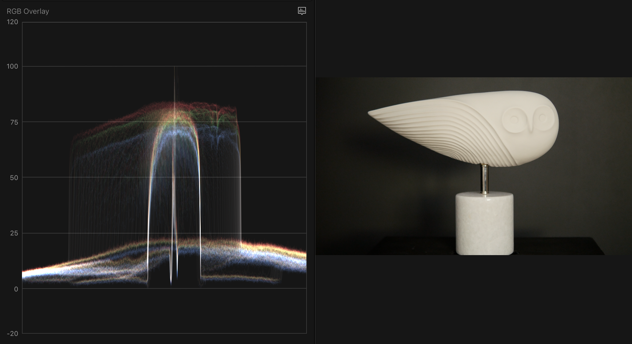

Fredrik, great test but there is a problem with your comparison.
You are actually clipping the highlights in the GX85 scenes.  The GX85 provides video levels but does use out of range values for overhead.  So in your NLE or color grading application you need to bring the out of range values into legal to compare the shots.  If you keep out of range values then a lot of setups will clip the highlights because they expand limited to full range.
Here is the waveform before and after bringing the highlights into legal range.
The 100% values on the left are from the titles but notice there is more highlight information above it.  The right side has brought the highlights into legal range and obviously the titles are now too low.  For indoor it is not really an issue but if you make a video outside in bright lights the out of range highlights contain valuable information that you should not discard.

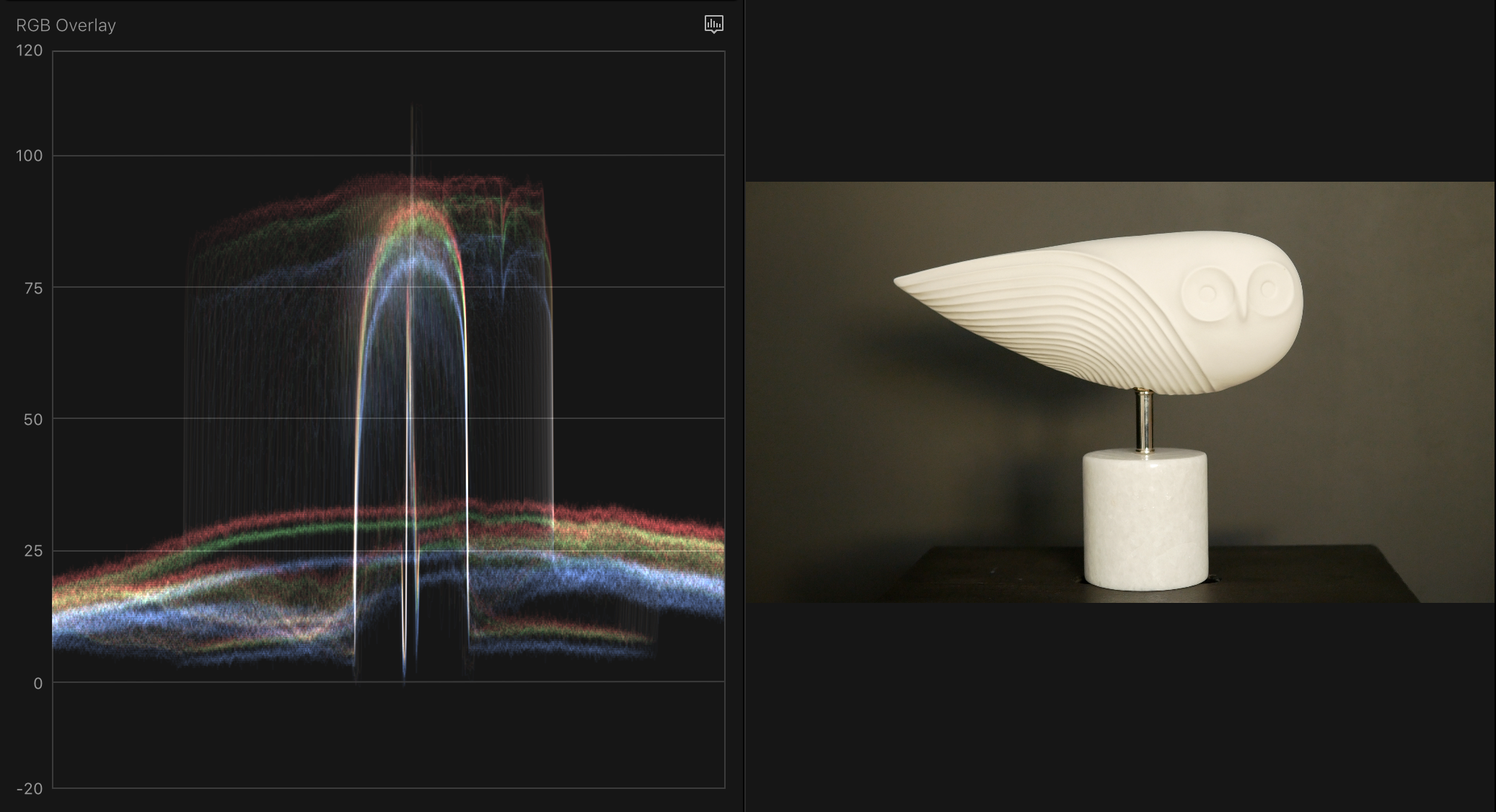

I don't get what you mean Cary, the only thing clipping is the tiny reflection on the top of the marble? Doesn't matter in an ISO test does it?
I only posted this so @jonpais could see the difference in exposure between the GH4 and GX85. In my experience skin tones and highlights look a lot better when underexposing with these cameras and that could be why he thinks the image from GX85/G85 look less "filmic".
GX85 is nr. 1 and GH4 is nr. 2
