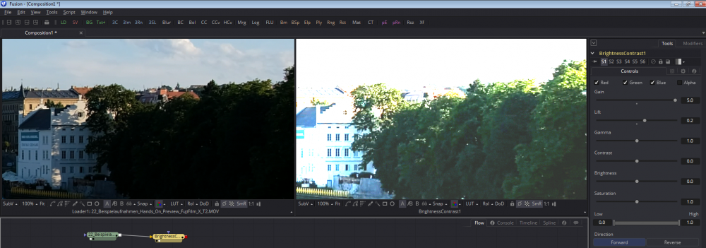

no_connection Posted July 9, 2016 Share Posted July 9, 2016 I did check both the video samples for download above with ffdshow internal reporting to .csv file. And it did report an I frame every 15 frames. 448 P frames and 32 I frames. For the clip with water. The magic happens when I open the clip in fusion. I expected to see mush with huge blocks at best. But this? Not sure if fusion is responsible for grain or not but I can't get anywhere near as good of a result by converting it to another format. Link to comment Share on other sites More sharing options...
