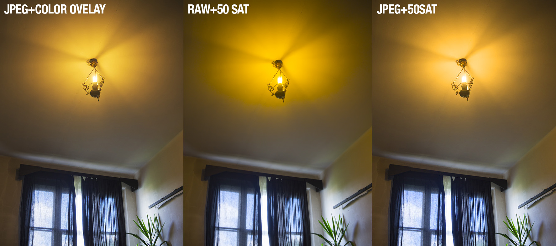

Kamil Sarnowski Posted July 14, 2016 Share Posted July 14, 2016 John Matthews: "I've been told this before: don't reduce the saturation too much on a 8bit file... but why?" Mainly to avoid usually incorect collor procesing. I'm adding an example to illustrate this. In the middle there is a +50 saturation added in 16 bit raw image during inport to ps. right is 8bit jpeg with 50 added sat in post. left is an extracted color layer overlayed over an image (which basicly mimics adding a isolated color data). Raw is obviously correct, right the most artificial. It might be even that setting higher sat in 8bit would be beneficial in post (lowering sat doesn't introduce artifacts), but it's a guess. Michael Coffee and John Matthews 2 Link to comment Share on other sites More sharing options...

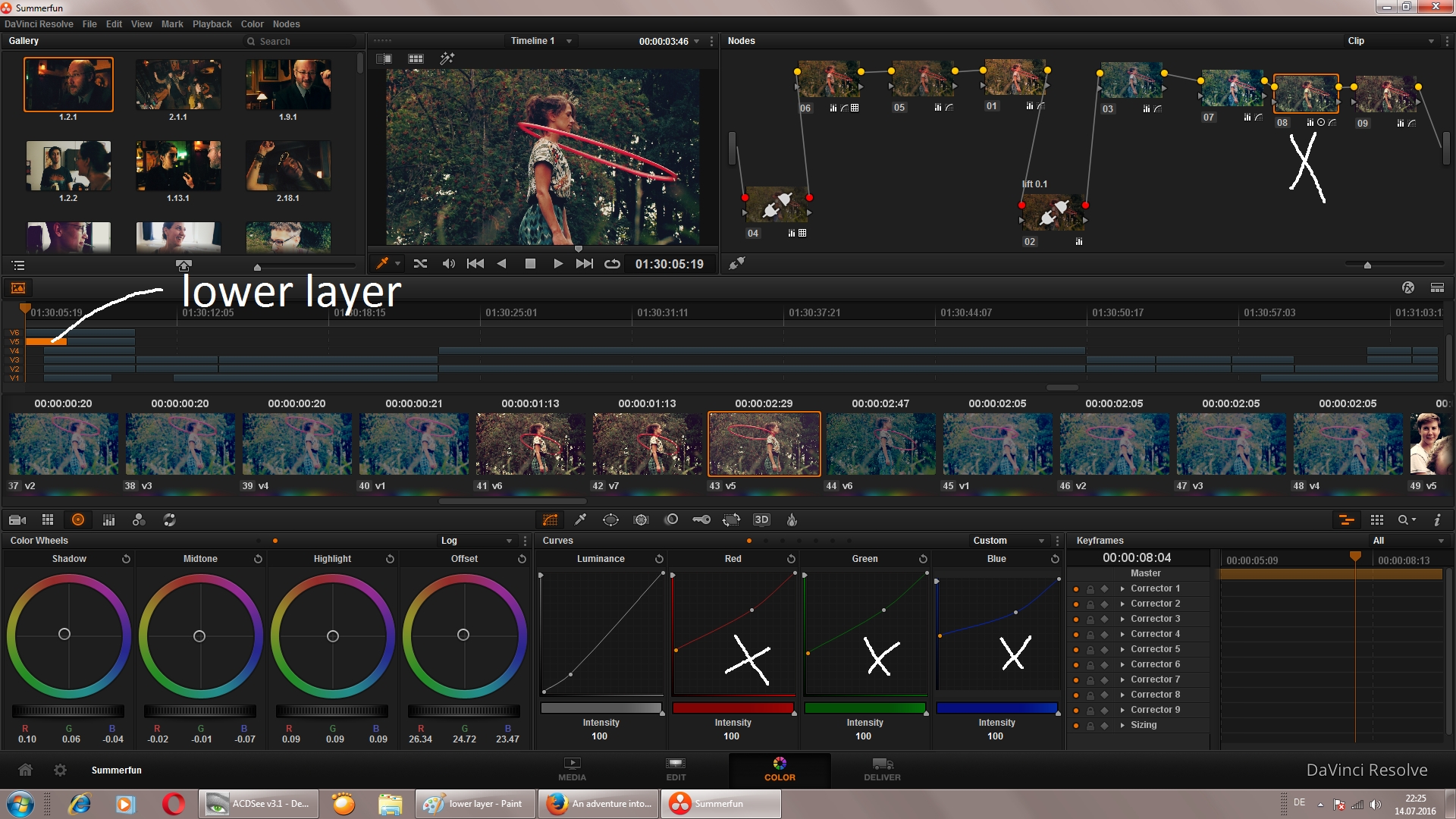

PannySVHS Posted July 14, 2016 Share Posted July 14, 2016 19 hours ago, tomastancredi said: Indeed, amazing colors! beautiful... how did you get that green? Thank you very much! I have two layers, one with 7 nodes, another one on top duplicated and in Hardlight layermode- with two of the nodes altered. I think one of the main things is one of the nodes of the lower of the two layers as seen on the Davinci screenshot below. Also attached a framegrab of a duck with colors I was really exited about to find in that 50p 28Mbit codec, with additional twixtor like slomo added! cheers and regards John Matthews, Michael Coffee and tomastancredi 3 Link to comment Share on other sites More sharing options...

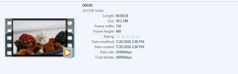

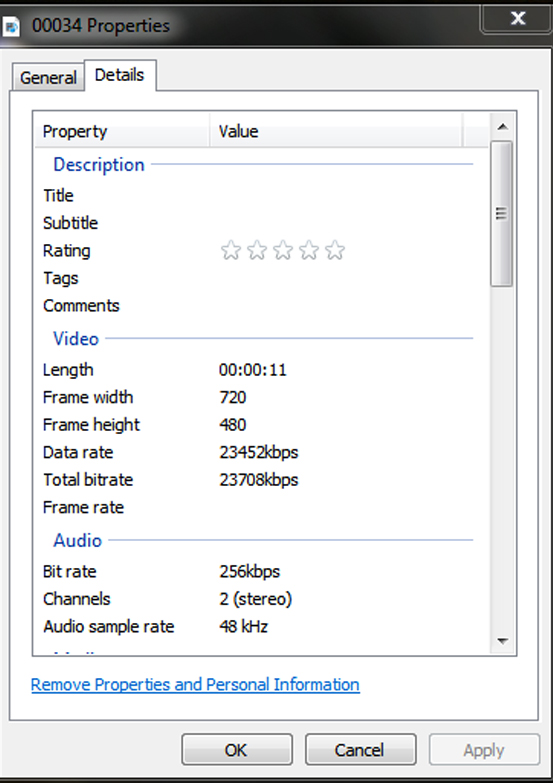

EyeSoul Posted July 21, 2016 Share Posted July 21, 2016 Sorry if this has been discussed but couldn't find any info on the subject. I have a issue when I record in AVCHD FHD 24P or 30p the file info shows it as 720x480 on SD card but in Resolve the Metadata shows as 1920x1080p. I was wondering had anyone else experienced this,I'm a bit confused. I want to make sure I'm actually recording 1080p and furthermore my camera is operating correctly. UPDATE: After further investigation it seems the files actually show as 1080p in Sony Vegas as well as Premiere Pro.I guess it's something with Windows 7 and how it sees the files far as info details,a bit strange but as long as the DAW is reporting correct I can live with it. Link to comment Share on other sites More sharing options...
