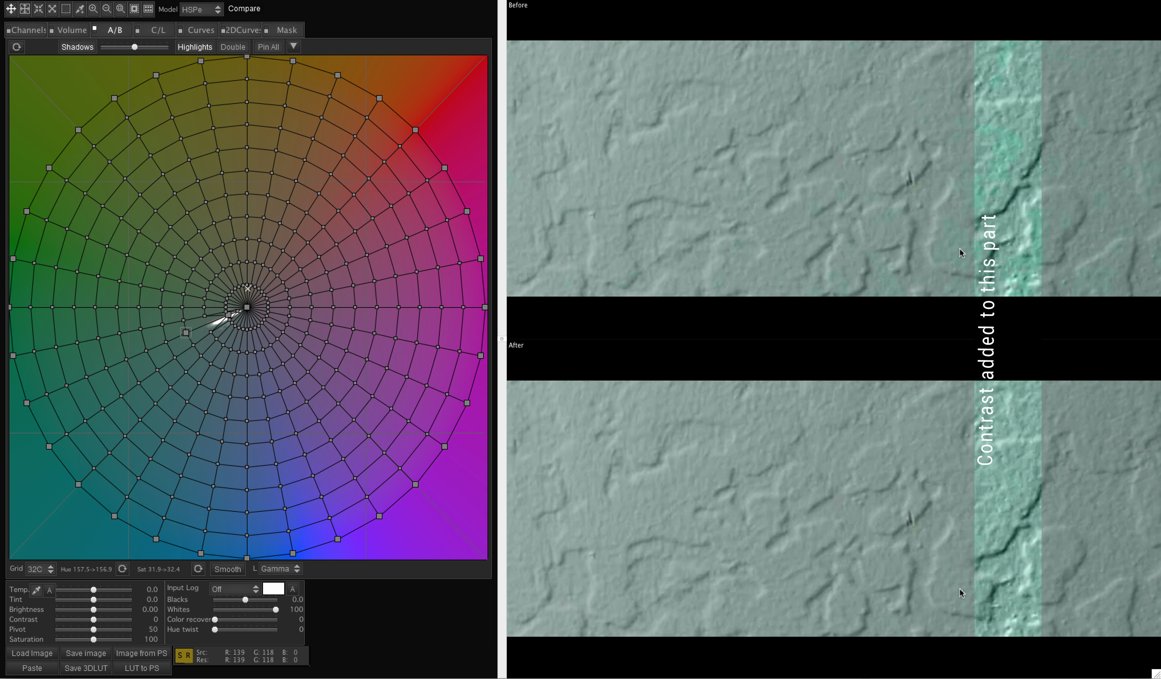

AaronChicago Posted September 18, 2015 Share Posted September 18, 2015 A kind fella named Joonas T helped me figure out a solution to reduce the macro blocking (cyan/magenta). Using a program called 3D Lut Creator. It takes a little bit of work but it's a good solution for those particular shots that have a beige/grey surface. Link to comment Share on other sites More sharing options...
Zak Forsman Posted September 18, 2015 Share Posted September 18, 2015 I saw your posts over on PV. I tried my hand at it with the demo but couldn't figure out the best way to identify and adjust things. so I went out instead and shot some more V-Log with a Dog Schidt Optiks FF58 lens I rented this morning. kaylee, CTRT, mercer and 1 other 4 Link to comment Share on other sites More sharing options...
ted ramasola Posted September 18, 2015 Share Posted September 18, 2015 @Aaron Chicago,Basing on your screen grabs of the LUT creater, do you use a color picker to click on the area in the screen and the nodes on the color grid gets auto selected based on the area you clicked on?I can also see the reddish "Y" on the framed pic in your sample also being affected slightly aside from the "magenta" and "greenish" blocks/stain on the wall being removed. Link to comment Share on other sites More sharing options...
AaronChicago Posted September 18, 2015 Share Posted September 18, 2015 @Aaron Chicago,Basing on your screen grabs of the LUT creater, do you use a color picker to click on the area in the screen and the nodes on the color grid gets auto selected based on the area you clicked on?I can also see the reddish "Y" on the framed pic in your sample also being affected slightly aside from the "magenta" and "greenish" blocks/stain on the wall being removed.yeah you click on a portion of the photo and it selects a point on the graph. From there you move the points around to affect the hues. Link to comment Share on other sites More sharing options...

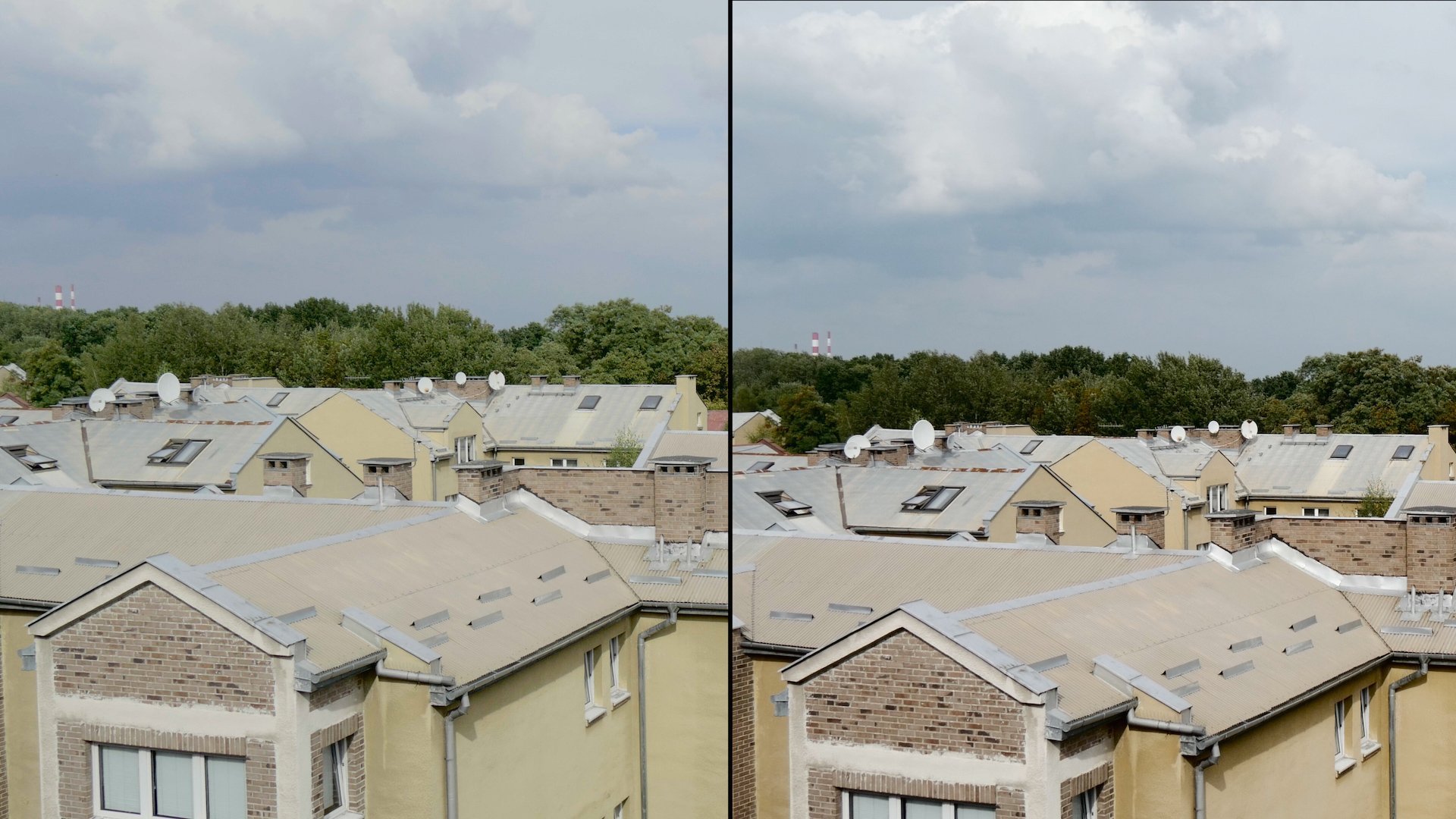

Michael Ten Calka Posted September 19, 2015 Share Posted September 19, 2015 The other day I did some test shots using 4K. On the left is V Log L and on the right is James Miller Cine V settings shot. I've tried to match sky this two and you can see clearly that shadows are much more crushed in Cine V. Mat Mayer and TheRenaissanceMan 2 Link to comment Share on other sites More sharing options...

Lintelfilm Posted October 3, 2015 Share Posted October 3, 2015 A kind fella named Joonas T helped me figure out a solution to reduce the macro blocking (cyan/magenta). Using a program called 3D Lut Creator. It takes a little bit of work but it's a good solution for those particular shots that have a beige/grey surface. So does this mean you've created a standard LUT that can now be applied to all v-log footage to help with this issue? ... and if so can we have it! Link to comment Share on other sites More sharing options...
AaronChicago Posted October 3, 2015 Share Posted October 3, 2015 So does this mean you've created a standard LUT that can now be applied to all v-log footage to help with this issue? ... and if so can we have it! Unfortunately it doesn't. You have to create a LUT for each scene which is cumbersome. Lintelfilm 1 Link to comment Share on other sites More sharing options...
