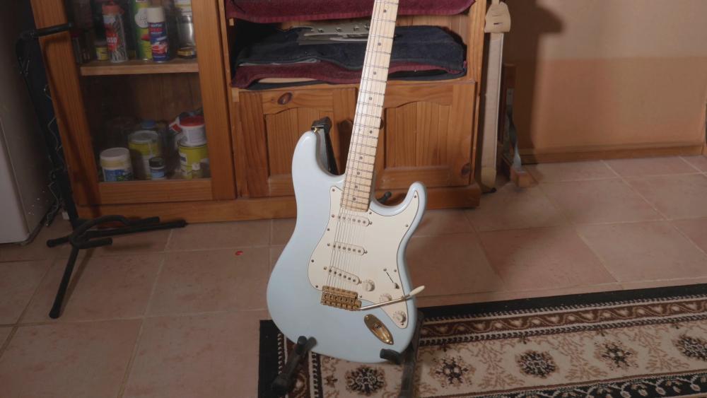

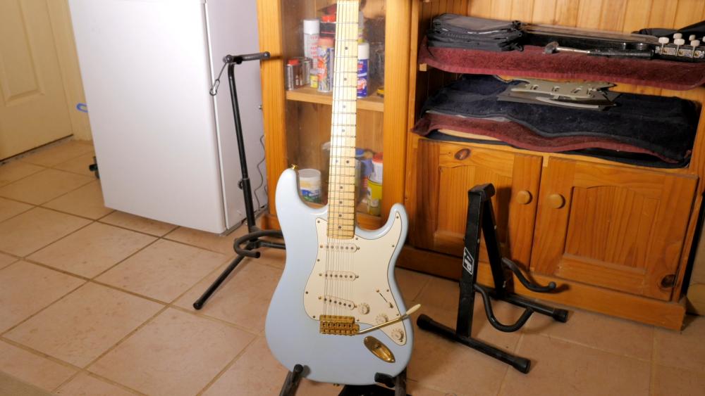

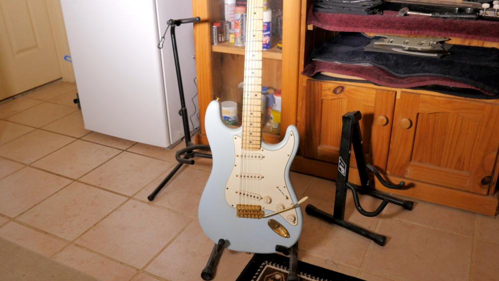

Astro 59 Posted September 16, 2015 Share Posted September 16, 2015 Well I was going to buy it, but after everything I read and some of what I saw...I became doubtful and not in any rush.But I decided to try it out since they overlooked the image app activation, and at first I was really underwhelmed, then later on I started doing some serious tests with video lights and just filming a guitar with highlights on the neck and stuff.I reset the Zebras to 75 and 65 respectively so I can get a good exposure etc...with the 79 IRE rolloff.I then did a ton of A/Bs with Natural, Portrait and other settings...shooting the same scene under lighting, the difference is staggering actuallyV-Log has depth somehow (not talking about DOF) just the look of it, I am actually quietly blown away, it definitely has the X factor and somehow the other profileslook a bit plastic to my eyes compared to it, it just somehow looks more organic...a lot more organic.I did not expect it to look this much better...so far I have only used the Varicam LUT, a little bit of experimenting...not much, there is some noise in the shadows but nothing serious that neat video could not fix, personally I expected it to be a lot noisier, but it isnt if you push the exposure right...So anyway Panasonic doing this stuff up has given me a chance to try it and I will buy it happily, before I was a bit on the fence...not now.Images attached...yes the guitars under Port/ NAT etc...was overexposed, but even with the exact exposure the difference is vast in all areas.3rd Image is the VLOG Cap...exact same lighting etc... Quote Link to post Share on other sites

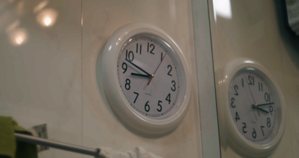

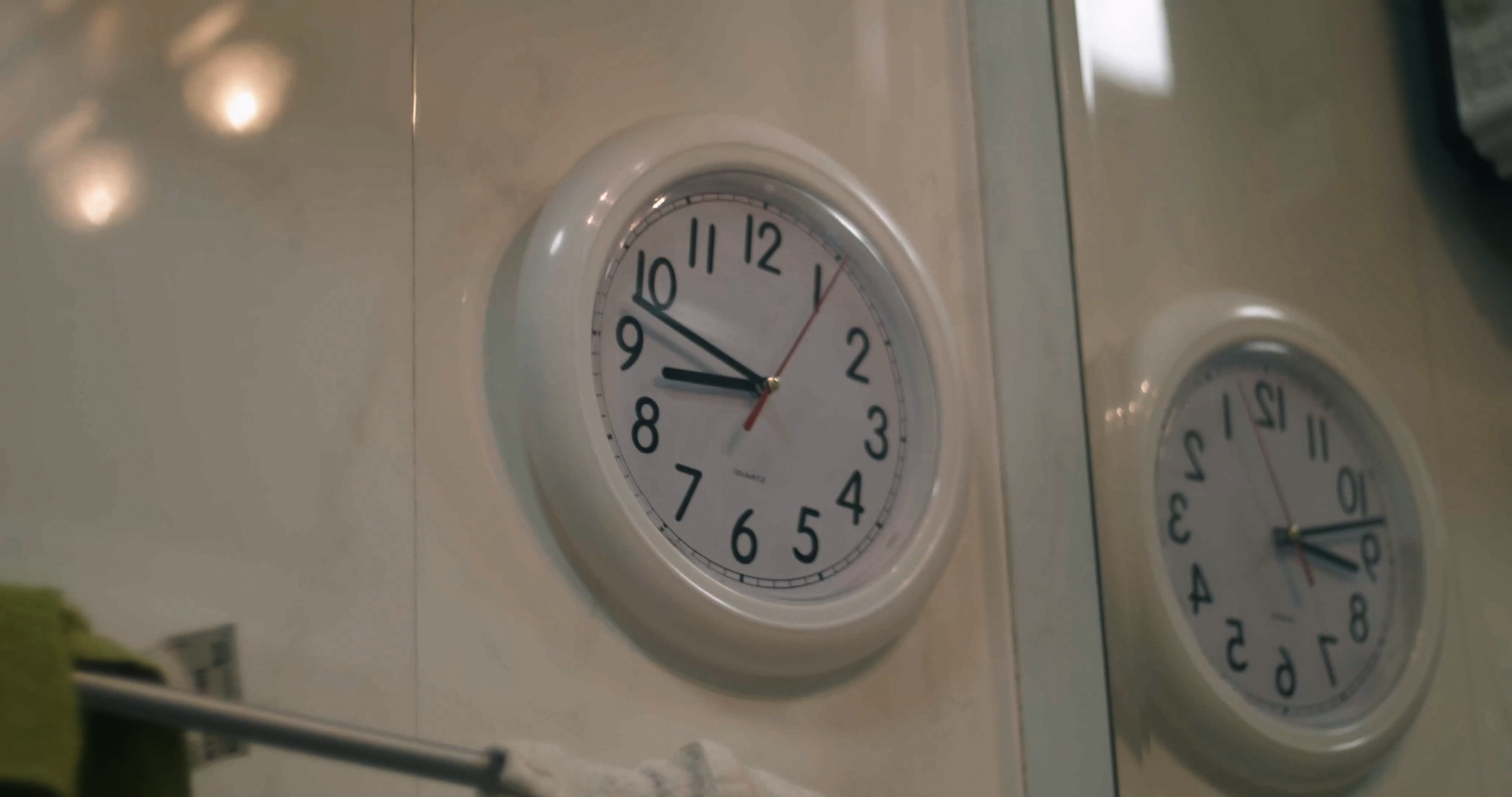

Aragonnarun 15 Posted September 16, 2015 Author Share Posted September 16, 2015 I tried a little more today after work. Filmed a clock on a white wall. When I tried to pull down the mids, the color bandings are showing clearly. It's quite severe. I over exposed around 0.5 stop. There's not much room to play in post due to the color banding.. Obviously the 8bit bottle is not enough for v log.. In Premiere/AE it's actually an effect converter instead of a 3D LUT. I know that Impulz makes a Cineon LUT if I'm not mistaken.yeah. I used it. It's not bad but I think the Arri Log C lut works better in impulse. Quote Link to post Share on other sites

dr_jon 22 Posted September 16, 2015 Share Posted September 16, 2015 Ah, when people say "banding" they mean "posterisation", I thought they were looking at pattern noise from the sensor. Thanks for the clock photo. Quote Link to post Share on other sites
