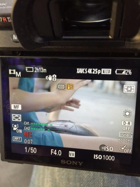

ntblowz Posted August 2, 2015 Share Posted August 2, 2015 http://www.newsshooter.com/2015/08/02/sony-a7r-ii-part-iii-5-axis-stabilisation-and-heat-issues-going-handheld-to-tell-the-story-of-a-london-busker/So it will overheat in 4K mode unless you use external recorder, not that great if the only mode that gives you the good result (S35 4K) also have overheating issue. Better to wait for A7S II if you want reliable 4K continuous shoot Palpet and Marco Tecno 2 Link to comment Share on other sites More sharing options...

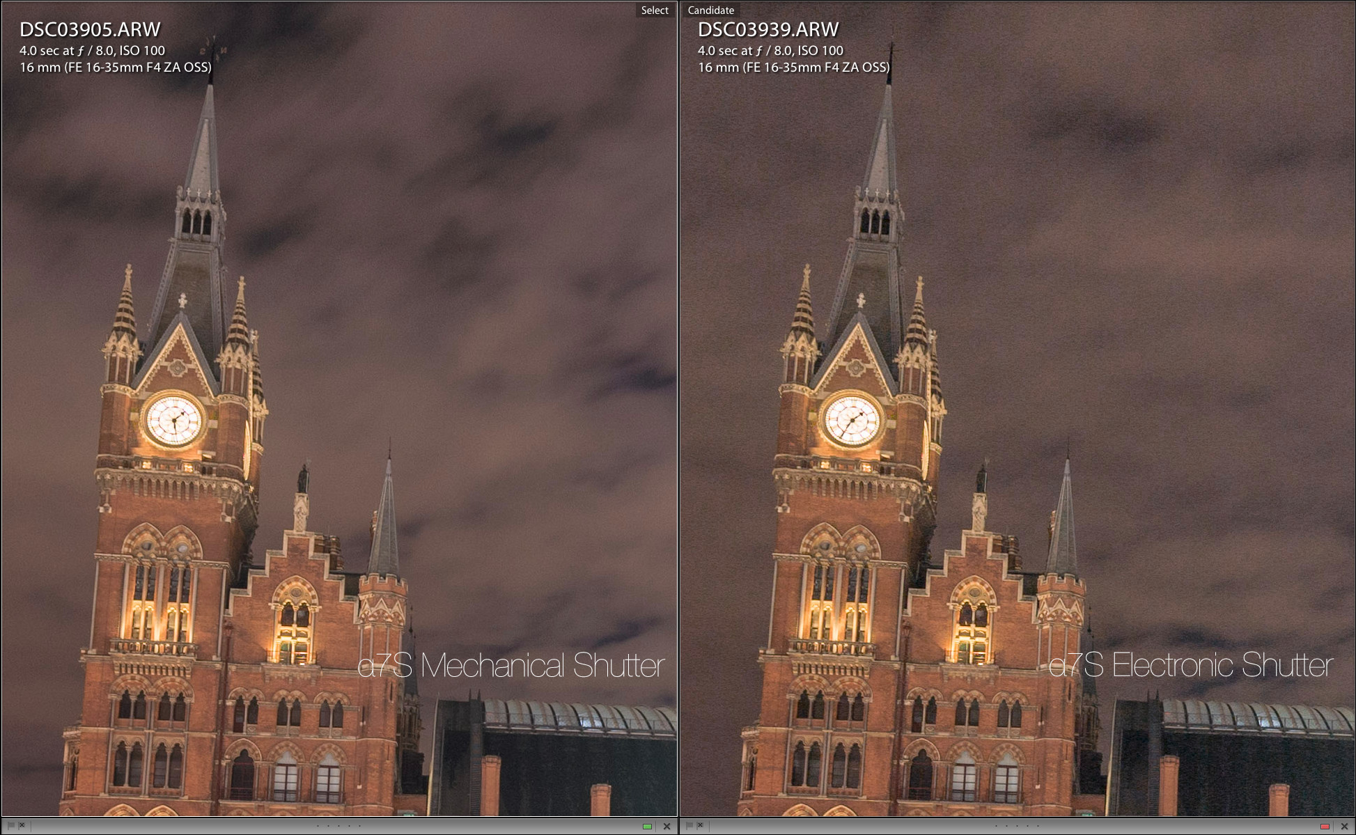

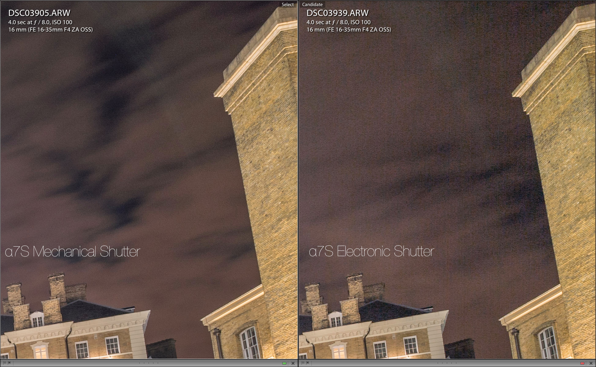

Davide Roveri Posted August 3, 2015 Share Posted August 3, 2015 Davide,What makes you think it doesn't drop to 12-bit precision in fully electronic ("silent") shutter mode? All indications are that it does so, just like the other A7 series cameras that support this feature (there's no penalty with EFCS, naturally.)In fact, someone even posted a snippet from an A7RII manual a few weeks ago confirming this limitation.Bulb, continuous, and continuous bracket modes also drop to 12-bit precision. So for top quality super long exposure shots exceeding 30 seconds, where you must use bulb, you get 12-bit. That stinks, in a $3200 camera.Coupled with the fact that they're still using the somewhat crappy lossy RAW compression scheme, which does occasionally manifest itself in real-world shots, and this one's a skip, for me, for now. It seems Nikon is still the best when it comes to getting top quality out of Sony's sensors.But then, I'm primarily a stills guy--video is a bonus. @labirdman the informations i had regarding the electronic shutter were from an Q&A with Kimio Maki (Senior General Manager, Digital Imaging Business Group, Sony Corporation) published on Imaging Resource here: http://www.imaging-resource.com/news/2015/06/16/sony-qa-the-must-have-sensor-tech-of-the-futurebelow is the bit in which he said that the only tradeoff with using the electronic sensor in the A7RII is the distortion caused by the rolling shutter:DE: But CMOS, CMOS it's very hard, yeah. Oh, that was one question. So on the A7R II, there's an all-electronic shutter mode, a silent shutter mode.KM: Yeah.DE: Our sense, and I'm not sure if we had seen it in... It might not have been a Sony product, it might have been somebody else's, but I know that there was at least one camera we had in the lab not long ago that reduced the bit depth in the raw files when you used its all-electronic shutter mode. And so I'm wondering, I guess there's a tradeoff there. What is the tradeoff in terms of image quality or noise level or whatever, when you're using an entirely electronic shutter as opposed to a mechanical shutter?KM: Just distortion.MW: Yeah. Otherwise, why put the mechanism in?KM: Yeah.They could have changed things before the release of the production model though, that i don't know! I guess the only way is to make some tests and that is what i'm gonna do anyway! :-) Link to comment Share on other sites More sharing options...
labirdman Posted August 3, 2015 Share Posted August 3, 2015 They could have changed things before the release of the production model though, that i don't know! I guess the only way is to make some tests and that is what i'm gonna do anyway! :-)That's the spirit! I really hope he, and you, are right. If you're able, could you please consider testing bulb mode, in non-silent mode, for the same thing?Also, Jim Kasson, on his excellent blog, has noted that the drop to 12-bit is typically only noticeable quite close to base ISO. So, 100 ISO appears to be the best setting with which to test, which probably almost goes without saying http://blog.kasson.com/?p=8586 kaylee 1 Link to comment Share on other sites More sharing options...

Shield3 Posted August 3, 2015 Share Posted August 3, 2015 NX1 destroyed...Not so fast professor. "One thing I discovered about half way into the shoot was that the camera has a tendency to overheat when recording in 4K for extended periods. At first a yellow warning sign pops up on the screen, then a few minutes later the camera shuts itself down with a black warning saying it needs to cool down. This is not something I have experienced in normal shooting with either the Panasonic GH4 or Sony a7S. The last time this happened to me was when using a Canon 5D mkII in hot conditions. During the shoot it was warm weather but not scorching hot, so I expect it is the 4K recording that is creating the excess heat. I lost several shots while waiting for the camera to cool down."http://www.newsshooter.com/2015/08/02/sony-a7r-ii-part-iii-5-axis-stabilisation-and-heat-issues-going-handheld-to-tell-the-story-of-a-london-busker/ My "destroyed" NX1 has been recording 4k all day and hasn't overheated once. Same S35 mode too basically. Link to comment Share on other sites More sharing options...

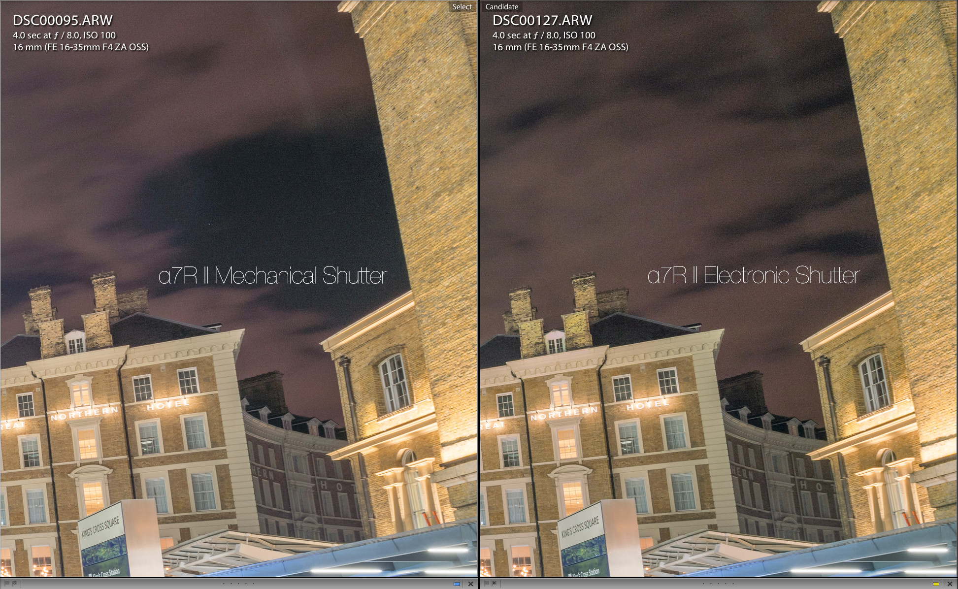

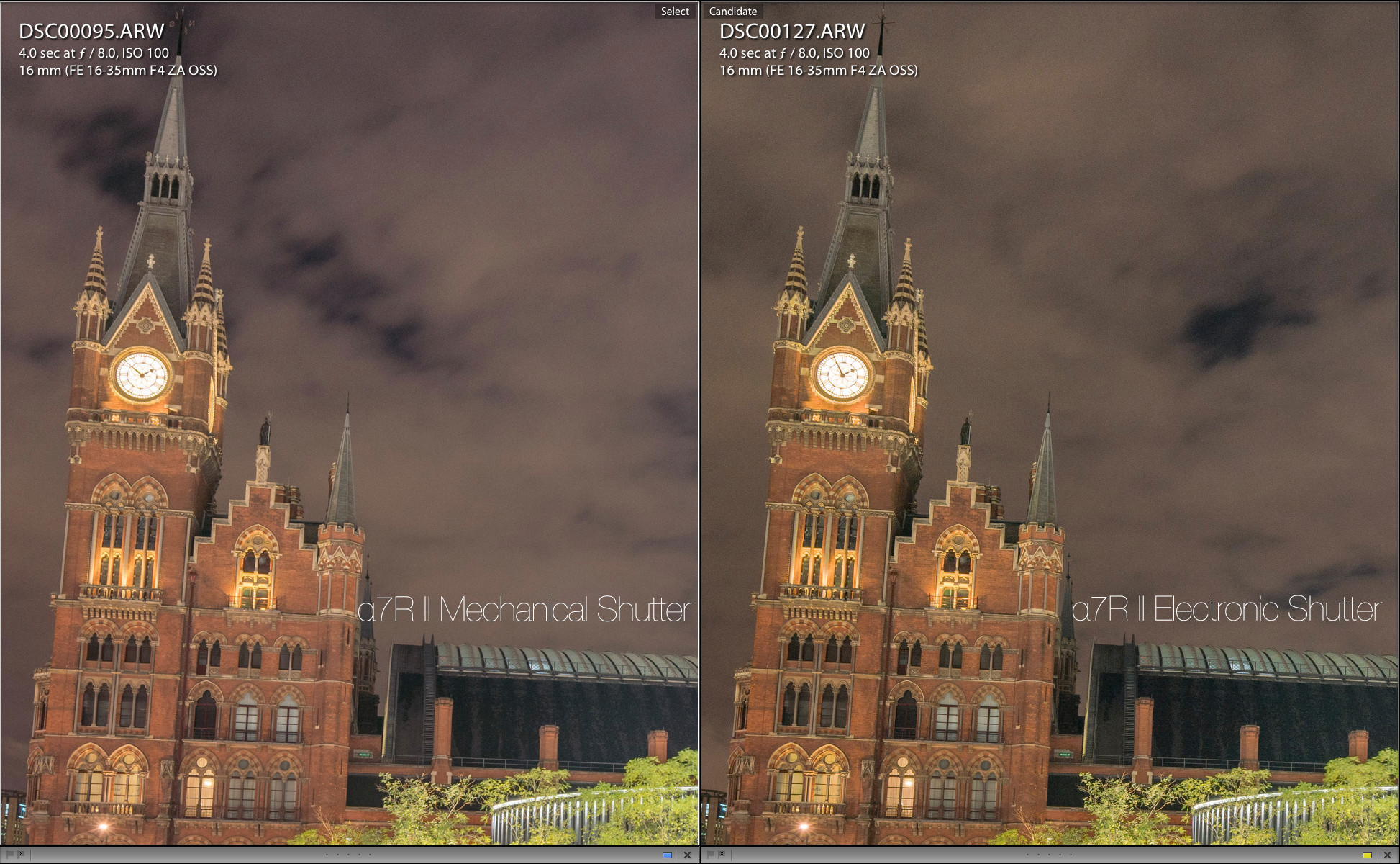

Davide Roveri Posted August 4, 2015 Share Posted August 4, 2015 Hello!Tonight I made a test of the ISO performance of the camera in still mode and I shot with both the mechanical and the electronic shutter to finally asses whether there's a reduction in quality like in other cameras or not.. I have to check the files more extensively and take a little bit more time to analyse them but I feel pretty confident to say that the electronic shutter on the α7R II looks pretty much indistinguishable from its mechanical counterpart and this is just insanely amazing! (especially for a time-lapse photographer, eheh!)I've attached some quick screen grabs from Lightroom where you can see with your own eyes. I also shot the whole set with the α7S again for comparison: the results are the same I remembered from past tests I did, the α7S shows a clear degradation of the image especially in darker areas where some nasty vertical banding can show up if the shadows are pushed limiting the usable dynamic range of the camera. Nothing like this happens on the α7R II and, once again, i think it's just another technological achievement from this very innovative and capable sensor.. I'm very impressed! agolex 1 Link to comment Share on other sites More sharing options...
