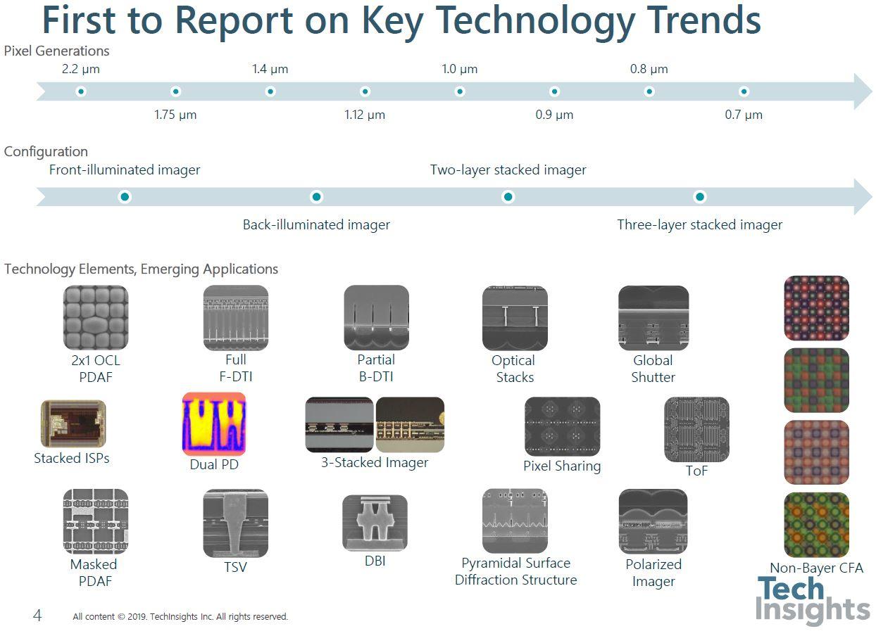

androidlad Posted May 1, 2019 Share Posted May 1, 2019 Short answer: no it will not, or shall we say, it does not ? Long answer: Quad Bayer is a cost-effective compromise to boost low light performance by dropping resolution by 4 times. What if I tell you there are more sophisticated technologies to achieve unparalleled low light performance while still maintaining high resolution? We can have designs such as Deep Trench Isolation (DTI), Pyramid Surface Diffractor (PSD) and colour-aware ADC, they address crosstalk, QE and read noise which are key metrics for low light performance. Link to comment Share on other sites More sharing options...

Administrators Andrew - EOSHD Posted May 2, 2019 Author Administrators Share Posted May 2, 2019 8 hours ago, androidlad said: Short answer: no it will not, or shall we say, it does not ? Long answer: Quad Bayer is a cost-effective compromise to boost low light performance by dropping resolution by 4 times. What if I tell you there are more sophisticated technologies to achieve unparalleled low light performance while still maintaining high resolution? We can have designs such as Deep Trench Isolation (DTI), Pyramid Surface Diffractor (PSD) and colour-aware ADC, they address crosstalk, QE and read noise which are key metrics for low light performance. The beauty of Quad Bayer are the video capabilities and big ass resolution sticker on the box. No need to drop to a maximum of 24 or even 12 megapixel to get a full pixel readout quality 4K readout going. 8K / 48 megapixel stills at same time as 4K in low light to match a 12 megapixel sensor with big fat pixels. Stacked design makes the readout really fast too. Sure Sony can do a 48 megapixel sensor with all of what you mentioned, most of it is new to me though, so maybe I am completely out of my depth with things like Pyramid Surface Diffractor... But why, when Quad Bayer works so well? By the way I get usable ISO 12,800 on the Mi 9 camera... On a phone... In video mode at 4k 60p.... Incredible. ISO 1600 in video mode looks so clean, it may as well be an A7S II. webrunner5 and kye 2 Link to comment Share on other sites More sharing options...

kaylee Posted May 2, 2019 Share Posted May 2, 2019 19 hours ago, androidlad said: We can have designs such as Deep Trench Isolation (DTI), Pyramid Surface Diffractor (PSD) and colour-aware ADC, they address crosstalk, QE and read noise which are key metrics for low light performance can we? kye 1 Link to comment Share on other sites More sharing options...
Super Members BTM_Pix Posted May 2, 2019 Super Members Share Posted May 2, 2019 Deep Trench Isolation sounds like some sort of PTSD from the First World War. I believe Ebrahim used a Pyramid Surface Diffractor to collect his money from Western Union without ID. thebrothersthre3, foliovision, Amazeballs and 2 others 2 3 Link to comment Share on other sites More sharing options...
