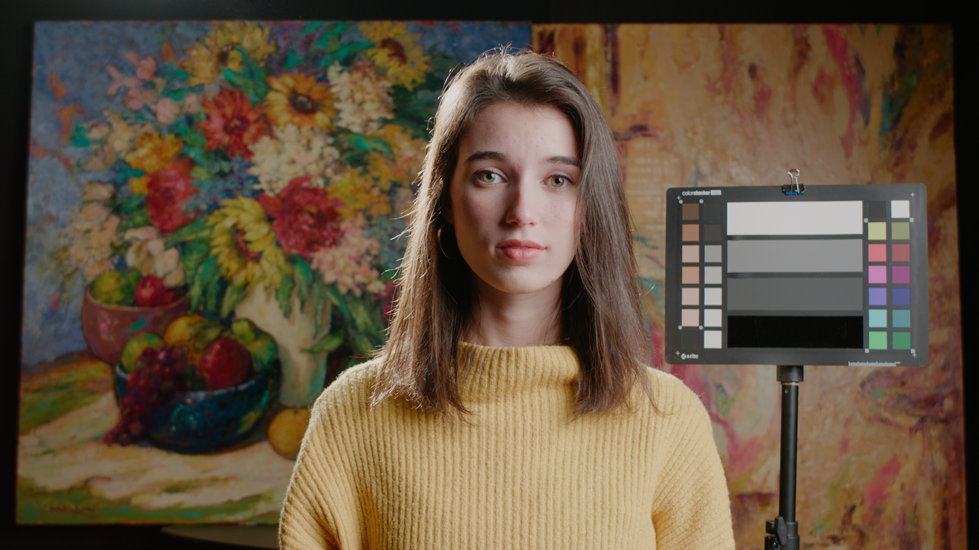

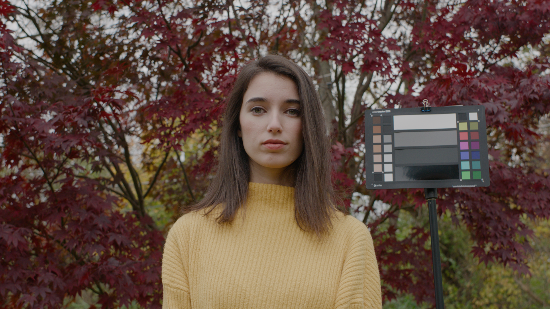

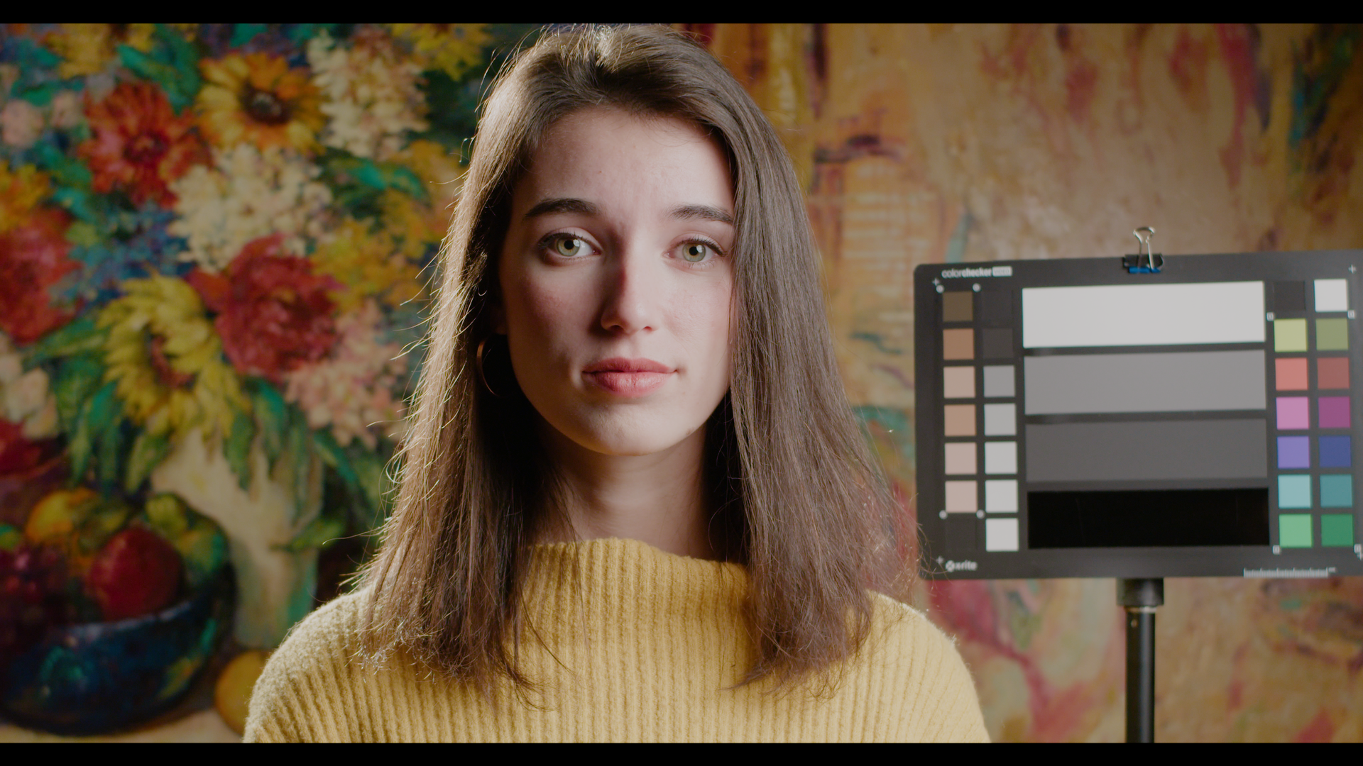

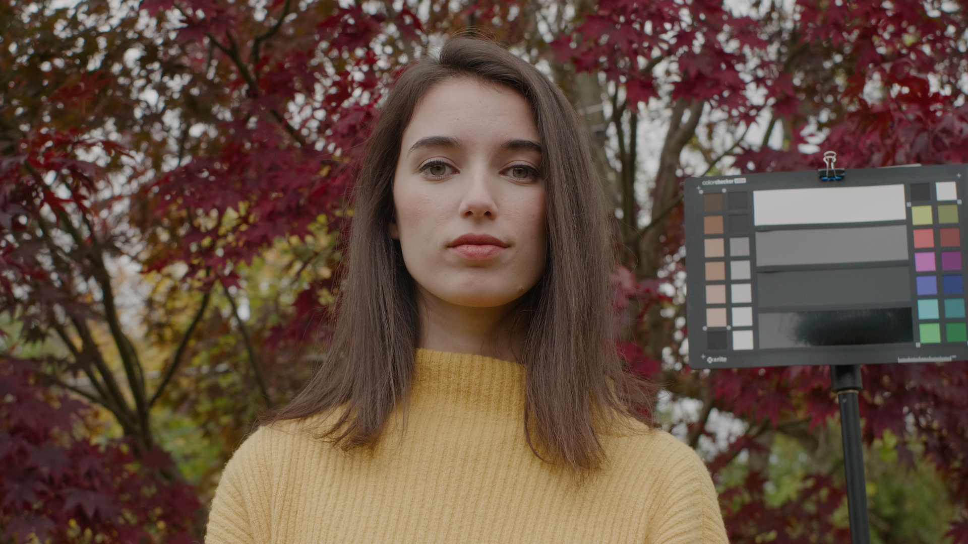

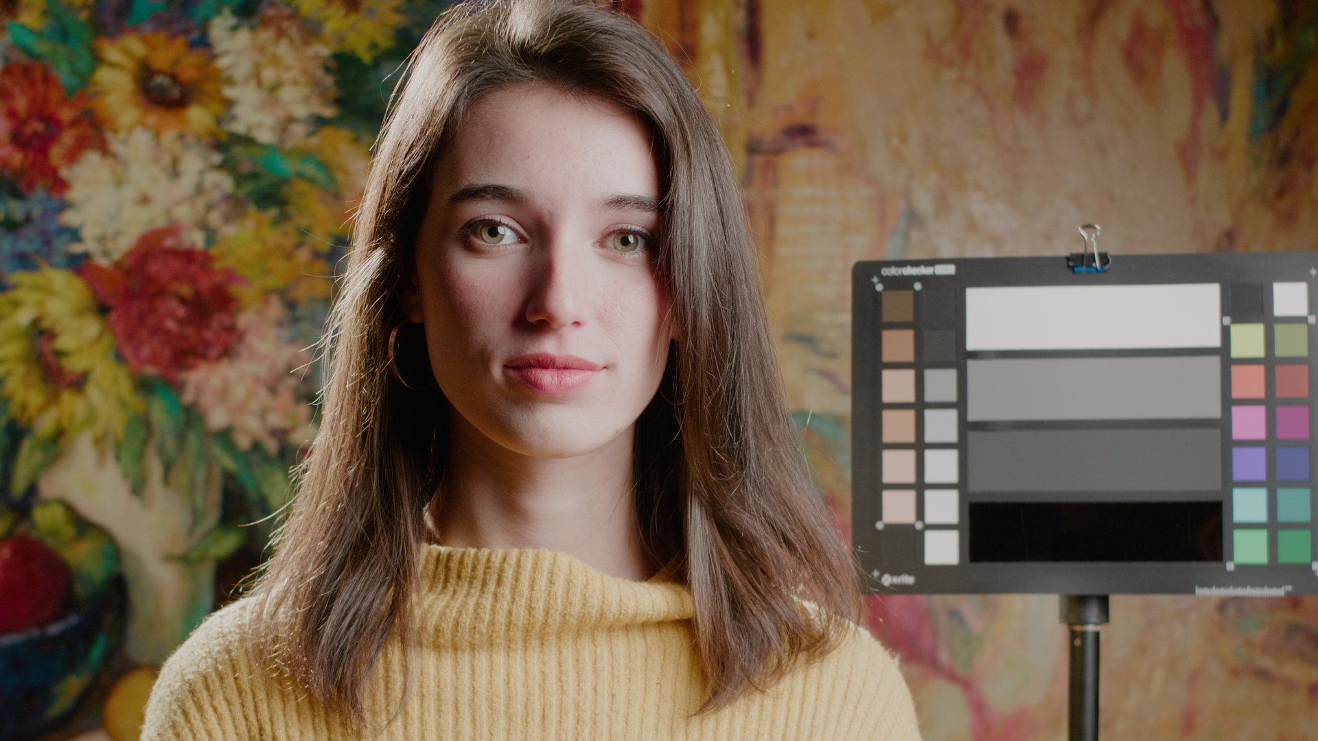

Sage Posted June 30, 2020 Author Share Posted June 30, 2020 On 6/22/2020 at 7:48 AM, PannySVHS said: S1, S1H, count me in. Wouldnt mind Cind D and HLG to VLOG conversion for free as well:) GHA for S1 I would buy if possible to transfer the high quality of the GH5 and BMPCC 4K versions. BM version looks esp spectacular! There will be PREs if the codec is lacking for the main log format; only the Cine-D Pre would be needed, but I like that HLG on the GH5 could use the default saturation setting. The standard bar is absolute for each new camera; I'd like to do a comparison in the future, wherein the same subject is filmed with every camera. Here are the Alexa, P4K, and GH5, with the most recent conversions/EC709: On 6/23/2020 at 1:11 AM, Neufeldt said: Funny timing as I just traded my GH5S for an S1H. I'm working with the S1H in pure VLog and it's way easier to get pleasant color than the GH5 was in VLogL (again, thanks Sage for saving the GH5 for me). I'm very curious as to how different an GHa-esque S1HVLog->ARRILogC LUT would be from the standard Color Space Transform of V-Gamut/V-Log->ARRIAlexa/ARRILogC. The CST is entirely usable though, so I'm less desperate than I was with the GH5 especially since highlight rolloff is so much nicer to begin with. It will interesting to see; I hope to explore it soon! On 6/26/2020 at 6:28 AM, Molas said: Hi everyone, Assuming I really need to shoot 60p with the GH5 and in order to get the best results with GHa, should I shoot 4k CINE-D 8-bit 150Mbps or 1080 CINE-D 10-bit ALL-I? I remember @Sage addressing (probably on reddit) the use of the 4K 8-bit 150Mbps codec but I can't remember if it was in a good or bad way. Is there a noticeable difference? it's always nice having that 4k resolution to punch in and re-frame but I rather shoot 1080p ALL-I if it holds better . Thanks in advance. All-I will give you a codec advantage over 8-bit 60 (and 10-bit 150mbps 24). There is less macroblocking and denser color gradients. The exception is 1080p 100 Long, which was similar to All-I in my gradient motion test. 1080p on the GH5 is very detailed (at the limit of 1080). Cine-D is better than VLog for 4K 8-bit andrgl, Adept and Wild Ranger 2 1 Link to comment Share on other sites More sharing options...
