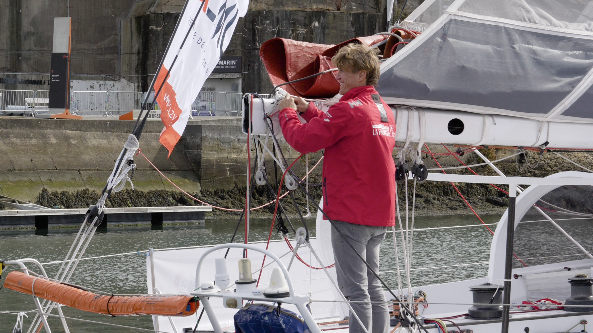

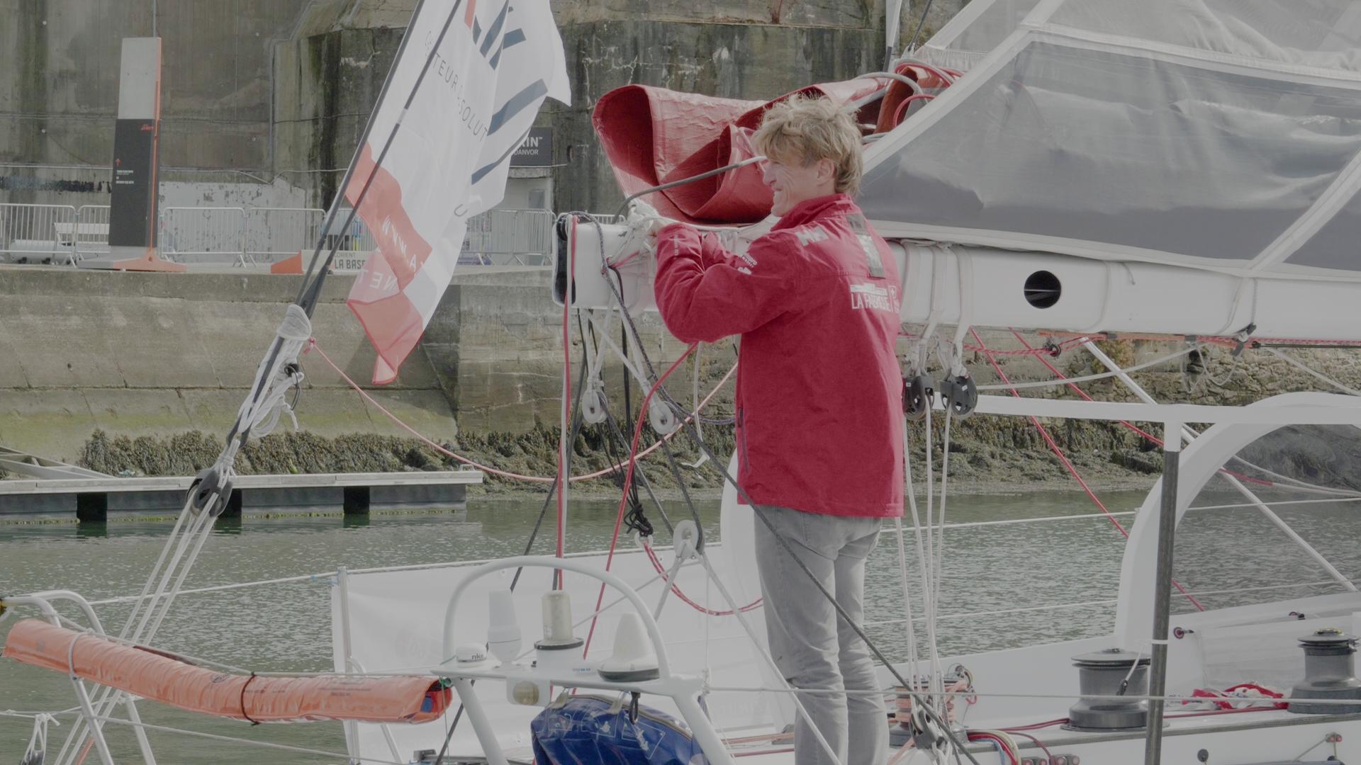

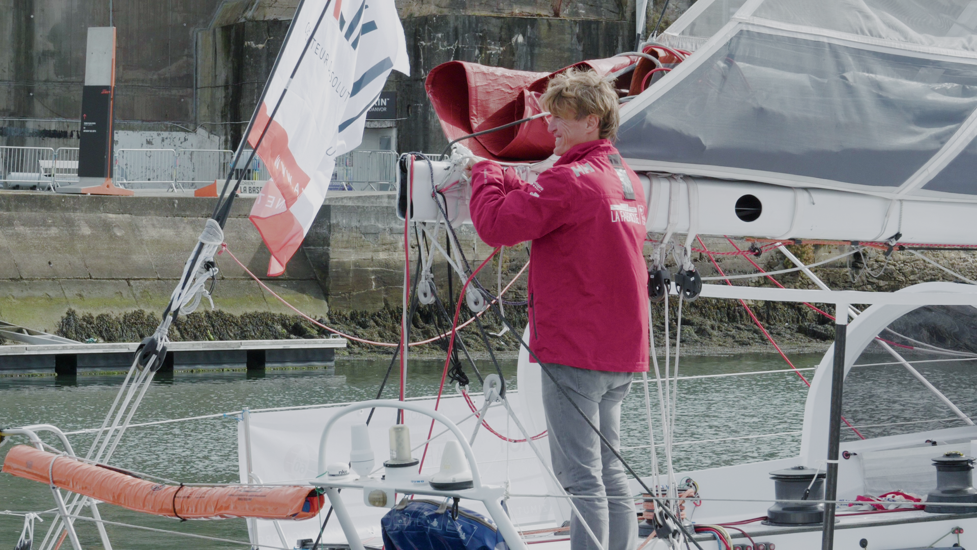

austinchimp Posted September 25, 2018 Share Posted September 25, 2018 Hi @Sage I've had great success with using EC on V-Log footage but I wanted to try it with Cine-D following your recommended settings. I'm having some trouble with the reds, which seem to shift hard to magenta in Premiere. I shot in Cine-D, with Saturation all the way down, and applied your V2 Cine-D to V-log Pre conversion in the Basic correction Lumetri tab, then used the Soft Lut from your Verde release in the Creative Lumetri tab. I was using a Tiffen Vari ND but I don't think that accounts for the Red distortion. The footage is 8 bit 1080p. Check out the screen grabs below. First one is straight out of the camera. Second is with the Emotive Color conversion, and third is a quick grade adding contrast and saturation to the Cine-D with no LUT used. Any ideas what I'm doing wrong? Adept 1 Link to comment Share on other sites More sharing options...
Sage Posted September 25, 2018 Author Share Posted September 25, 2018 3 hours ago, austinchimp said: Hi @Sage I've had great success with using EC on V-Log footage but I wanted to try it with Cine-D following your recommended settings. I'm having some trouble with the reds Its an interesting case. Arri places the reds toward magenta, but this saturated region in your Cine-D shot has a double curvature with the Cine-D PRE. The other reds in the frame are where they should be. The shot appears to have a slight magenta shift in the WB (may be introduced by lens/nd), but this won't account for the region. Attached is a corrective POST file to place after the 'Soft' variation (and before a grade). A couple inquiries - does the file happen to be wrapped in ProRes? How did it look by eye? 'Soft' with the corrective and a slight WB: GHa Cine-D Red-Magenta Corrective .cube Link to comment Share on other sites More sharing options...
austinchimp Posted September 25, 2018 Share Posted September 25, 2018 3 minutes ago, Sage said: A couple inquiries - does the file happen to be wrapped in ProRes? How did it look by eye? GHa Cine-D Red-Magenta Corrective .cube Thanks. To my eye the cine-d looks pretty accurate. Maybe technically there's a small shift to magenta if you use scopes, but the red jacket was nowhere near hot pink in real life. It was straight out of the camera, so not transcoded to Prores. I'm still using a pretty old version of premiere - 2017 edition. Not sure if that has any bearing on it. I have found previously that Premiere does have a tendency to do this to red on occasion, where as Resolve will not, even with the same footage and same Lut. Never found an explanation for it. Link to comment Share on other sites More sharing options...
Sage Posted September 25, 2018 Author Share Posted September 25, 2018 9 minutes ago, austinchimp said: Thanks. To my eye the cine-d looks pretty accurate. Maybe technically there's a small shift to magenta if you use scopes, but the red jacket was nowhere near hot pink in real life. It was straight out of the camera, so not transcoded to Prores. I'm still using a pretty old version of premiere - 2017 edition. Not sure if that has any bearing on it. I have found previously that Premiere does have a tendency to do this to red on occasion, where as Resolve will not, even with the same footage and same Lut. Never found an explanation for it. Oh yea, that is, with the PRE there's a double shift to magenta from where it should be with the jacket red. The POST corrective will address this. The Cine-D itself is good, and has subtle variations of red hue Yea; I noticed this oddity with Premiere ProRes; I've got to do a PRE for it eventually Link to comment Share on other sites More sharing options...
Sage Posted September 25, 2018 Author Share Posted September 25, 2018 On 9/23/2018 at 9:54 PM, ykt.net said: Very good works ? Especially short horror film is great ! But what I noticed is that GHA color science makes video more retro (vintage) look. Am I wright you are saying that it is standard use ? Or what u are saying by "non-standard use". Also, is there any Arri Alexxa LUT's tested with GHA ? I want to see variations of use for this beautiful color science. Thanks. Main/Soft are low contrast color bases resembling film; it may indeed work well for a retro film aesthetic (as in 'Tilian - Cocky'). For non-standard use, people often use it in unexpected ways that will move away from true Alexa color. There's been a variety; grading before the conversion, using the conversion at a percent strength, using non-full spectrum NDs, using the Lumetri luma curve, shooting HLG/Cine-D over VLog (this is about to improve), grading LogC directly without a display Lut, placing black level very high (above 5 IRE), placing luma brightly (faces above 45 IRE anchor), ETTR into the rolloff, combining the LogC variation with Main/Soft For Alexa luts, do you mean the Arri display luts for Rec709 etc? I'm going to do SBS comparisons with a variety of Lut options soon. Wild Ranger uses LogC film conversions with GHa occasionally, such as in Basta above mercer, deezid, Wild Ranger and 2 others 5 Link to comment Share on other sites More sharing options...
