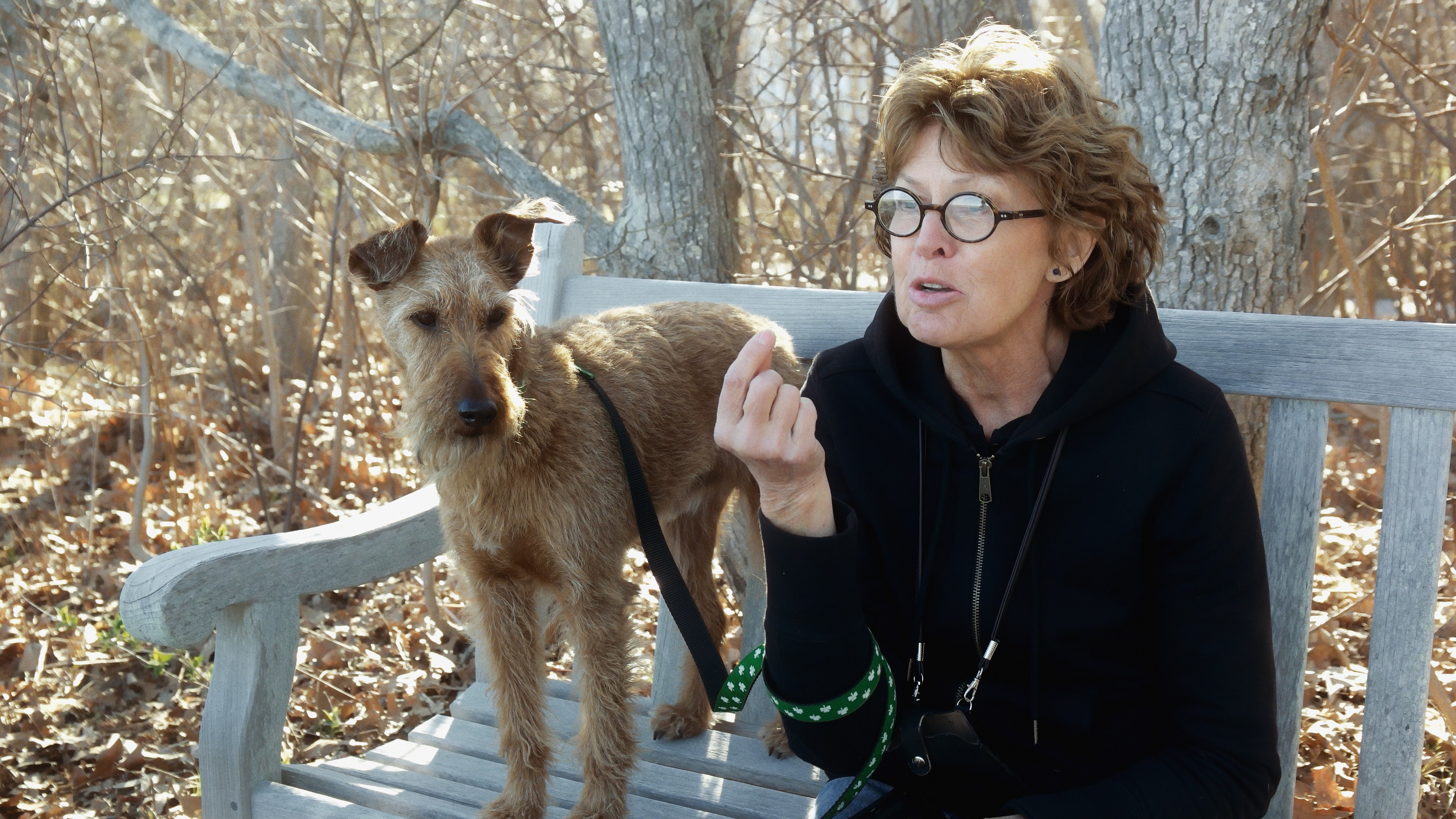

Geoff CB Posted April 27, 2016 Share Posted April 27, 2016 Yeah running the Trial version of the Tiffen set for Premiere. Had an imprompu interview the other day and really needed to soften it. With about 10 minutes of tweaking i'm getting pretty great results. This is the pro mist filter. Kurtisso, dahlfors, TheRenaissanceMan and 2 others 5 Link to comment Share on other sites More sharing options...
mercer Posted April 27, 2016 Share Posted April 27, 2016 1 hour ago, Geoff CB said: Yeah running the Trial version of the Tiffen set for Premiere. Had an imprompu interview the other day and really needed to soften it. With about 10 minutes of tweaking i'm getting pretty great results. This is the pro mist filter. Wow. Not bad. It seems to help with falloff pretty nicely. And it really makes your subject pop. BrorSvensson and outerbeat 2 Link to comment Share on other sites More sharing options...
