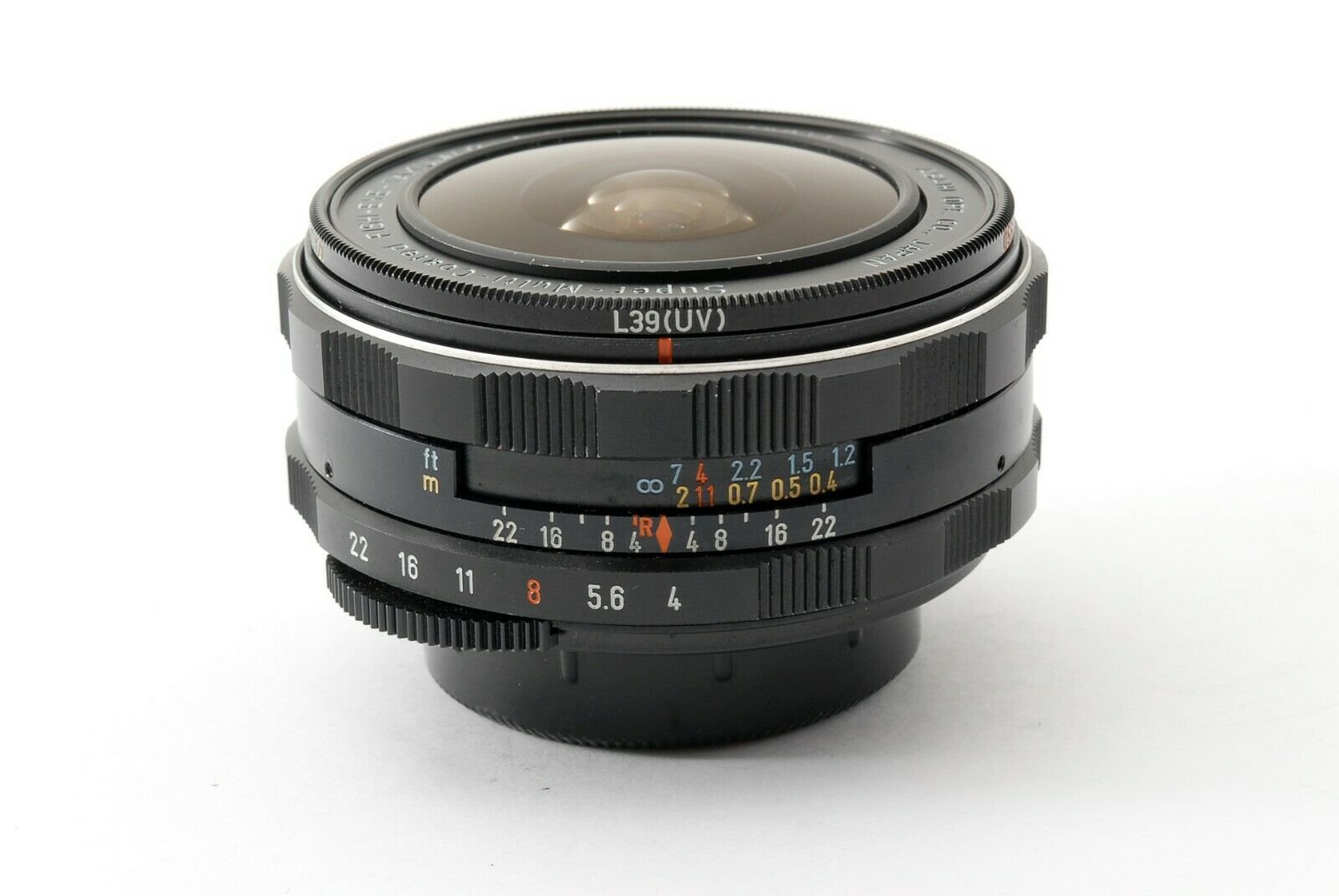

Henchman Posted July 6, 2020 Share Posted July 6, 2020 I have Jupiter 8 lens that won't focus at all. I'm using it with an M39 to EF adapter. The only thing it will focus on, is extreme close up. Like a crazy macro lens. Link to comment Share on other sites More sharing options...

heart0less Posted July 6, 2020 Share Posted July 6, 2020 7 hours ago, Henchman said: I have Jupiter 8 lens that won't focus at all. I'm using it with an M39 to EF adapter. The only thing it will focus on, is extreme close up. Like a crazy macro lens. That's because this Jupiter isn't a normal M39x1 mount. It's actually a Leica M39×26tpi aka L39 Since it's meant for rangefinder cameras, its flange distance is so short that you won't be able to use it on a DSLR. If you put it on a mirrorless camera, it'll work just fine. Link to comment Share on other sites More sharing options...

Henchman Posted July 7, 2020 Share Posted July 7, 2020 17 hours ago, heart0less said: That's because this Jupiter isn't a normal M39x1 mount. It's actually a Leica M39×26tpi aka L39 Since it's meant for rangefinder cameras, its flange distance is so short that you won't be able to use it on a DSLR. If you put it on a mirrorless camera, it'll work just fine. I want to use it with my BMPCC 4k. It has an MFT mount. Is there an adapter I can get for it? Link to comment Share on other sites More sharing options...
heart0less Posted July 7, 2020 Share Posted July 7, 2020 51 minutes ago, Henchman said: I want to use it with my BMPCC 4k. It has an MFT mount. Is there an adapter I can get for it? Surely, there is. This one, e.g. https://www.bhphotovideo.com/c/product/1413094-REG/fotodiox_m39_mft_lens_mount_adapter_for.html It cannot be any thicker / higher than that. It's not properly advertised since it's more of a L39 (which isn't the same as M39) to MFT adapter, but what can we do.. Bear in mind you won't be able to use Russian M39 lenses with this adapter, even though they would mount perfectly - once again, different flange distance. Link to comment Share on other sites More sharing options...
kye Posted July 7, 2020 Share Posted July 7, 2020 5 hours ago, heart0less said: Surely, there is. This one, e.g. https://www.bhphotovideo.com/c/product/1413094-REG/fotodiox_m39_mft_lens_mount_adapter_for.html It cannot be any thicker / higher than that. It's not properly advertised since it's more of a L39 (which isn't the same as M39) to MFT adapter, but what can we do.. Bear in mind you won't be able to use Russian M39 lenses with this adapter, even though they would mount perfectly - once again, different flange distance. Your post is why I've avoided m39 mount lenses and stuck with m42 mount!! What a mess. Of course, lots of talk about the earlier models of the classic Russian lenses being better in many ways, so yeah. Link to comment Share on other sites More sharing options...
Henchman Posted July 8, 2020 Share Posted July 8, 2020 22 hours ago, heart0less said: Surely, there is. This one, e.g. https://www.bhphotovideo.com/c/product/1413094-REG/fotodiox_m39_mft_lens_mount_adapter_for.html It cannot be any thicker / higher than that. It's not properly advertised since it's more of a L39 (which isn't the same as M39) to MFT adapter, but what can we do.. Bear in mind you won't be able to use Russian M39 lenses with this adapter, even though they would mount perfectly - once again, different flange distance. I only want it for the Jupiter 8. Thanks for the info. Link to comment Share on other sites More sharing options...
