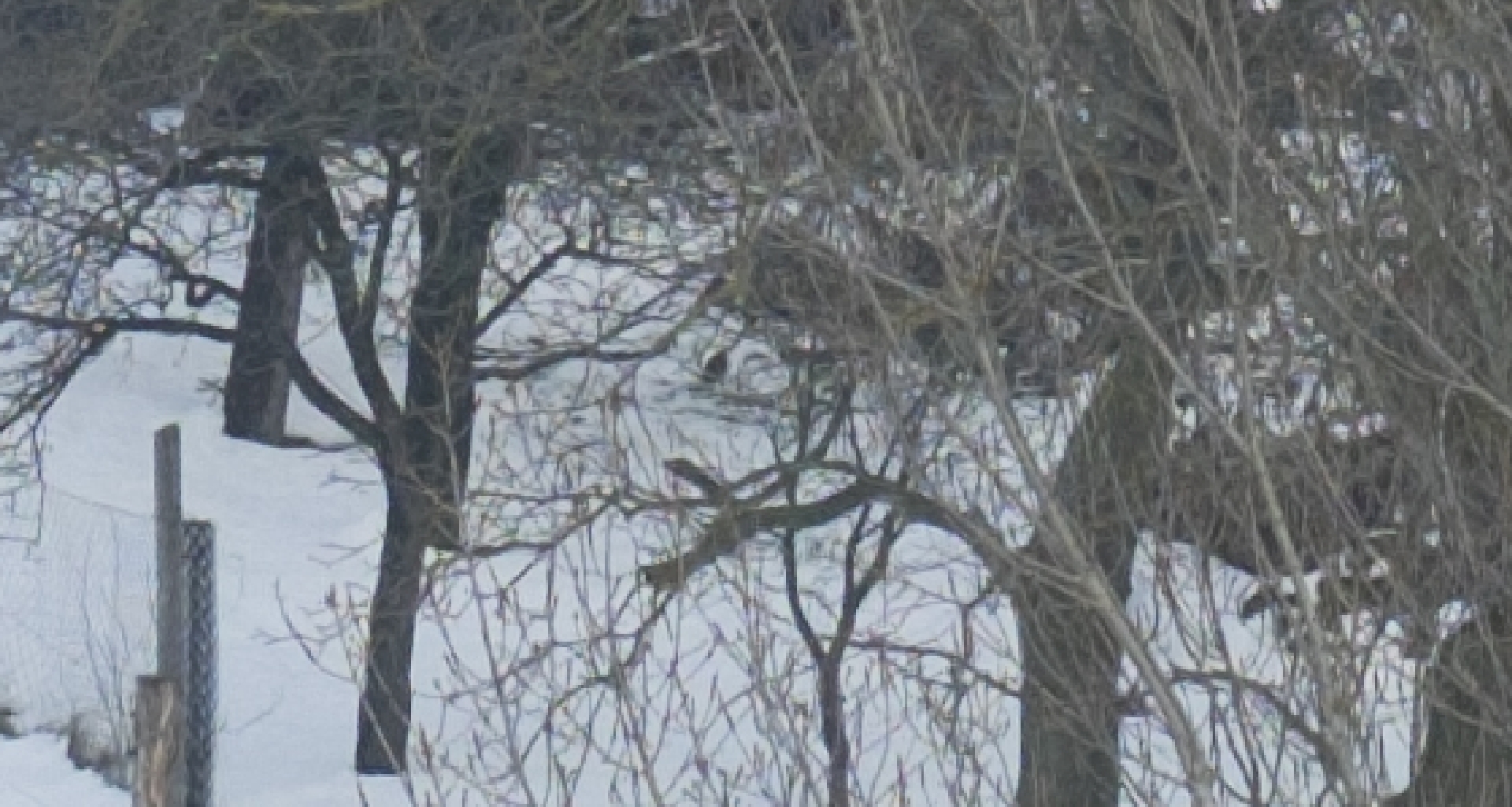

dgbarar Posted April 22, 2024 Share Posted April 22, 2024 Why? I have version 6 on my X-H2S that I use to video birds.The tracking AF for video in version 6 does not work any better than subject detect in the previous firmware. In fact, I find it to be a PITA. With my eye to eyecup I have to use the joystick to select the subject. Version 6 still loses the tracked subject and goes OOF. Why? Because it is essentially the same autofocus algorithm that does not work well for subject detect. These folks have had years to perfect their phase detect autofocus and two years with the X-H2S. But it is still the lack of video autofocus performance we have come to expect from FujiFilm. Not certain why this is the case. Is it lack of technical skill from the autofocus team? If it is, then they should be terminated. Maybe there are issues with X-Trans and this is the best they can do. If that's the case this is a management issue. All I can tell you is that Fuji is yet to figure out video autofocus. At this time there should be no more excuses. sanveer 1 Link to comment Share on other sites More sharing options...
dgbarar Posted May 19, 2024 Share Posted May 19, 2024 Changed my mind. I have been playing with this for a month. Wide tracking is a significant improvement for bird videos. While having to select the subject is still a bit of a PITA with an eye to the eyecup I have come to grips with it. I have turned off touch screen and keep the tracking box in the middle of the viewfinder. Select start tracking, hit record and then compose the shot. Works well. Would be terrific if the FujiFilm would allow me to map the start tracking to another button--say the red record button. Then, I could start tracking with the red record button, then move the same finger to the shutter release to start recording the video. PannySVHS 1 Link to comment Share on other sites More sharing options...
