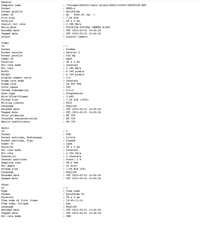

BrunoCH Posted March 2, 2023 Share Posted March 2, 2023 7 hours ago, Attila Bakos said: And if you record in UHD 24p, internal H.265 has actually more bitrate than ProRes HQ (720Mbps vs 707Mbps). I tested it, H.265 actually looks better due to more efficient compression. Yes for 4K the bitrate are very similar (I am around 780Mbps for ProRes HQ in 4KDCI) But for 6,2K I have a bitrate of around 2300 Mbps with ProRes HQ. This is really different from the 720 Mbps of H265 (Angelbirds SE 512GB cards are very good at a reasonable price, I got some around 180 euros) https://www.angelbird.com/prod/av-pro-cfexpress-se-type-b-2919/?category=238 Attila Bakos 1 Link to comment Share on other sites More sharing options...
ac6000cw Posted March 3, 2023 Share Posted March 3, 2023 22 hours ago, BrunoCH said: Yes for 4K the bitrate are very similar (I am around 780Mbps for ProRes HQ in 4KDCI) But for 6,2K I have a bitrate of around 2300 Mbps with ProRes HQ. This is really different from the 720 Mbps of H265 But 6.2k frame size is 6240 x 4160 (from the file info you posted), which is approximately 3 x the pixel count of 3840 x 2160 UHD (25958400 vs. 8294400 pixels) So in terms of compressed bits-per-pixel it's basically the same - 88 bpp for 6.2k @2284Mbs, 87 bpp for UHD @720Mbps Link to comment Share on other sites More sharing options...

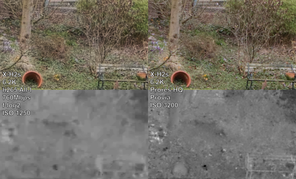

Daniel Robben Posted March 3, 2023 Share Posted March 3, 2023 Concerning chroma details, I tested a bit, and noticed a jump of increased color details at ISO 3200 in standard profiles. Further, h265 All-I is a bad choice vs longGOP for such detailed not moving scenes. Prores has advantage as well here, even if its Intra frame encoding. f-log2 also worse than standard profiles. So the best I could get (and almost completely get rid of smoothing) is with Prores HQ at ISO 3200 in standard profile. See comparison of best and worst (below is one of its chroma channels): Emanuel 1 Link to comment Share on other sites More sharing options...

Daniel Robben Posted March 4, 2023 Share Posted March 4, 2023 4 hours ago, D Verco said: Have you considered that it doesn't matter if the final image quality is as good as it is? I do. But I ended up here because something was odd (muddy) compared to my previous camera (G85), and also thanks to other people who digged deeper, it's clear that there are flaws. I was using the S5 Pro from Fuji (incredible dynamic range by the way) for years and still love it. Same with G85. I know their sweet spots and just rely on them at some point. With the x-h2s, of course the bars are raised, considering the specs. Regarding dynamic range in f-log2, it's great, yes. But there are situations (maybe more than I would like) where there will be lack of richness visible and you will not be able to recover it, whereas with its competitors, you might have. Of course, I also noticed that some of the "richness" in the wintertrees of other cameras is actually color noise, so also bad, but at least it can be postprocessed if needed. Link to comment Share on other sites More sharing options...
