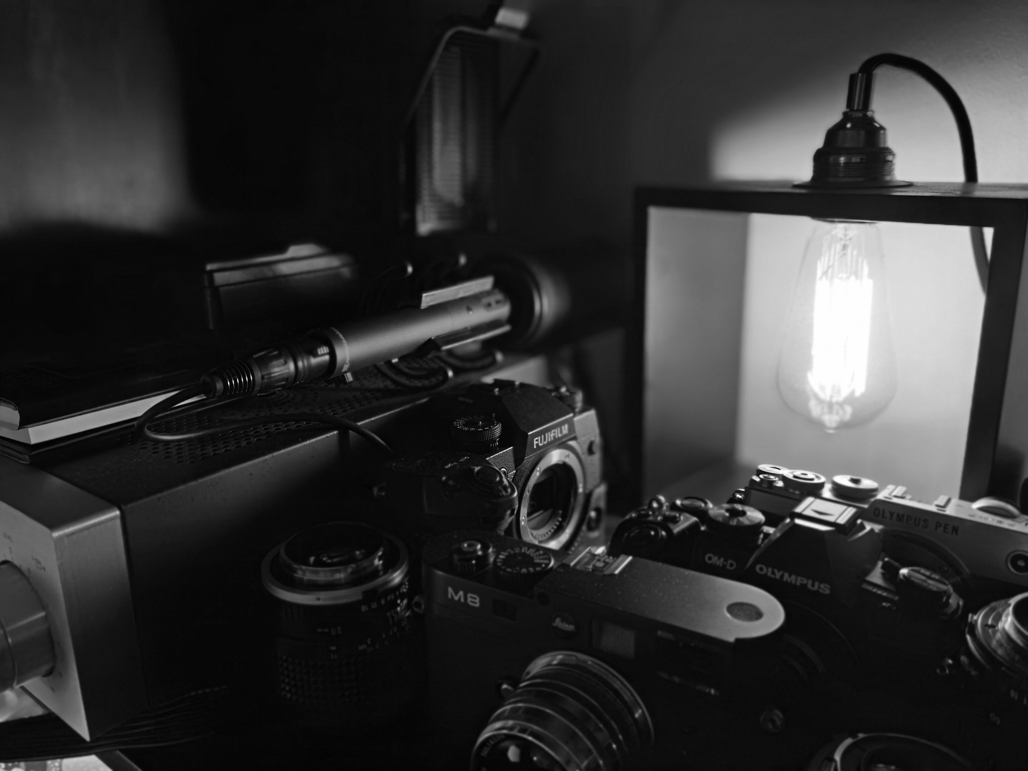

Administrators Andrew - EOSHD Posted November 5, 2020 Administrators Share Posted November 5, 2020 Have smartphones overtaken the best medium format cameras for dynamic range? This is a comparison that should worry everybody in the camera industry. Full blog post: https://www.eoshd.com/news/fuji-gfx-100-loses-to-huawei-p40-pro-plus-smartphone-for-dynamic-range/ KnightsFan, BTM_Pix, Katrikura and 3 others 4 2 Link to comment Share on other sites More sharing options...

Video Hummus Posted November 6, 2020 Share Posted November 6, 2020 Isn’t the smartphone just doing auto-magic photo bracketing? Which could be done manually with the GFX 100, albeit with a lot more work. Seems kinda unfair to the GFX 100 merely on a technical standpoint (not on a user experience standpoint). Which means the smartphone took more than one photo, perhaps up to 5, compared to the GFX 100’s 1 RAW. It’s surprising to me camera companies have not embraced this “in camera” processing more, even for special “auto” modes where the user just wants the camera to do everything. Regardless, this is a good example of why camera sales have plummeted in the consumer market. It all comes down to the user experience and the smartphone, in this case, clearly provided the better user experience. If you were to repeat the test and bracket 3 RAW photos from the GFX 100 the results would be superior. tomastancredi 1 Link to comment Share on other sites More sharing options...
Administrators Andrew - EOSHD Posted November 6, 2020 Author Administrators Share Posted November 6, 2020 Yes of course it's multiple frames at different exposes fused together. Tap the shutter button and it's done for you, by a neural network no-less, with AI. And certainly more than just 3 frames fused together, due to the speed of the sensor. The GFX 100 burst isn't fast enough for this to work. It does show that small, fast smartphone sensors can overcome shortcomings like dynamic range, with computational photography. They have never been able to beat a medium format camera, massive 44x33mm sensor with 100 megapixel before. The Huawei is the first to do this. dslnc, 63degreesnorth and Rar Jay 3 Link to comment Share on other sites More sharing options...
Administrators Andrew - EOSHD Posted November 6, 2020 Author Administrators Share Posted November 6, 2020 The medium format level dynamic range seems to extend into portrait / aperture mode as well on the P40 Pro Plus... which is very unusual for a smartphone. The depth map computations AND the multiple frame merges all done at once in a fraction of a second. Here's the result... Link to comment Share on other sites More sharing options...

Wan Taquddin Posted November 8, 2020 Share Posted November 8, 2020 I think modern phone sensors actually use single shoot, but with varying exposure time, eg quarter pixels exposed for +1ev, another quarter pixels exposed for -1ev etc. Therefire much less ghosting compare to traditional bracketing. Then HDR-processed by smartphone's powerful ISP. If the scene is bright enough eg daylight, bracketing still used in tandem to further increase DR. Link to comment Share on other sites More sharing options...
Administrators Andrew - EOSHD Posted November 8, 2020 Author Administrators Share Posted November 8, 2020 31 minutes ago, Wan Taquddin said: I think modern phone sensors actually use single shoot, but with varying exposure time, eg quarter pixels exposed for +1ev, another quarter pixels exposed for -1ev etc. Therefire much less ghosting compare to traditional bracketing. Then HDR-processed by smartphone's powerful ISP. If the scene is bright enough eg daylight, bracketing still used in tandem to further increase DR. Thanks for the explanation. It's a 50MP Quad Bayer sensor in the phone, almost 1" size. Quad Bayer can use Dual ISO in one exposure, the pixels at different exposures are merged in the 12MP shot. Also it is RYYB. The yellow diodes let in more light than traditional Green ones with bayer sensors. Then there is neural network and AI processing side. And probably a very high speed readout in some modes with multiple frame merges. Smartphones are leading the way for camera technology at the moment. jack jin 1 Link to comment Share on other sites More sharing options...
