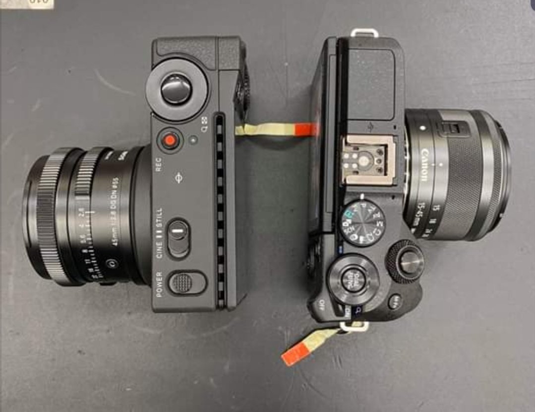

ntblowz Posted October 25, 2019 Share Posted October 25, 2019 Fp is about the same size as m6ii Link to comment Share on other sites More sharing options...
