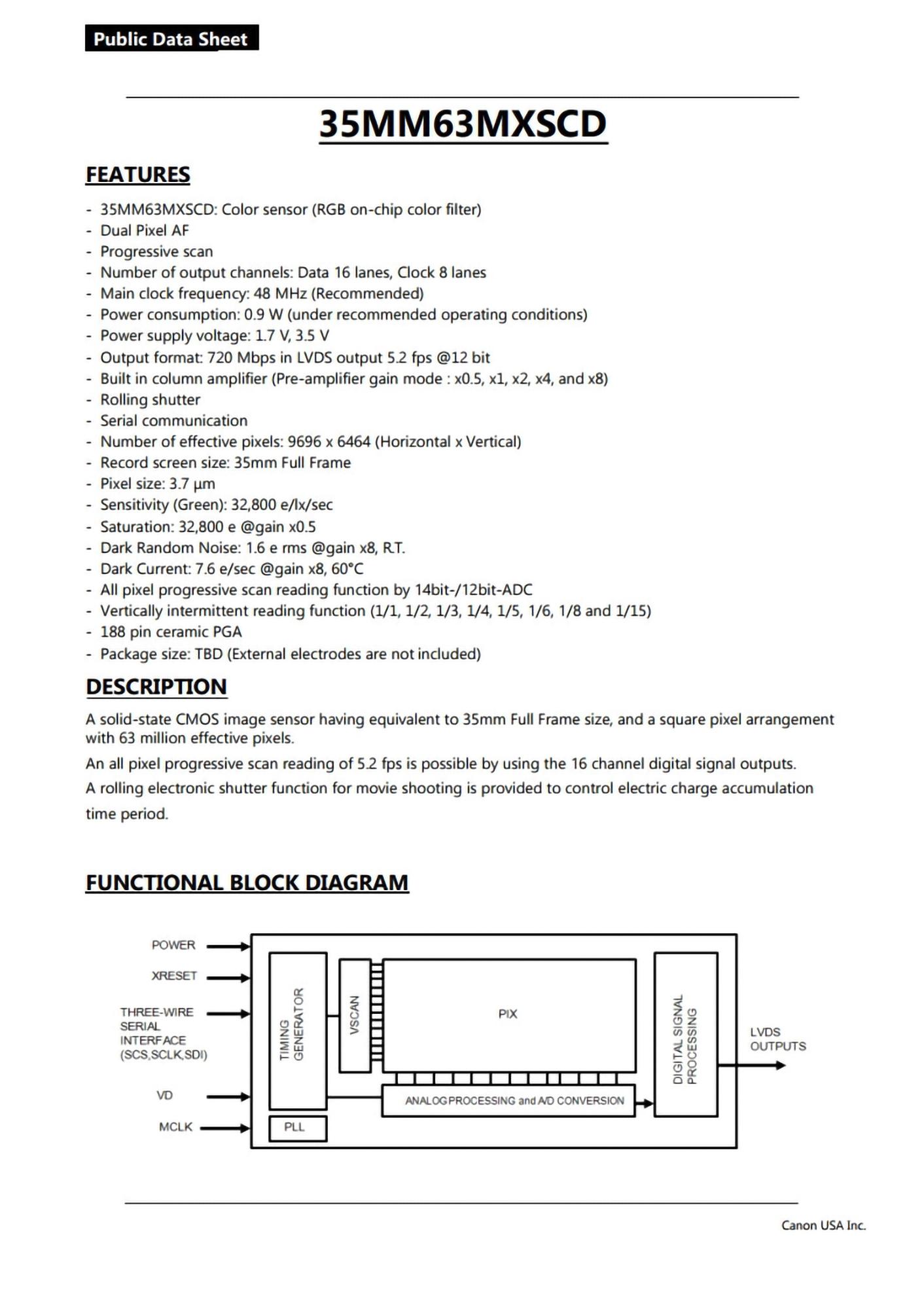

androidlad 62 Posted April 14, 2019 Share Posted April 14, 2019 This 63MP FF sensor from Canon (35MM63MXSCD, FSI with 300nm process) is a response to Sony's 61MP IMX455 (BSI & DTI with 90nm process), which recently entered mass production and will be sold to Nikon and Pentax. Quote Link to post Share on other sites

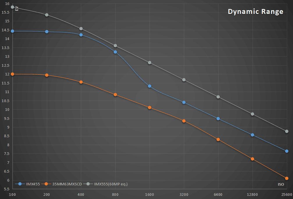

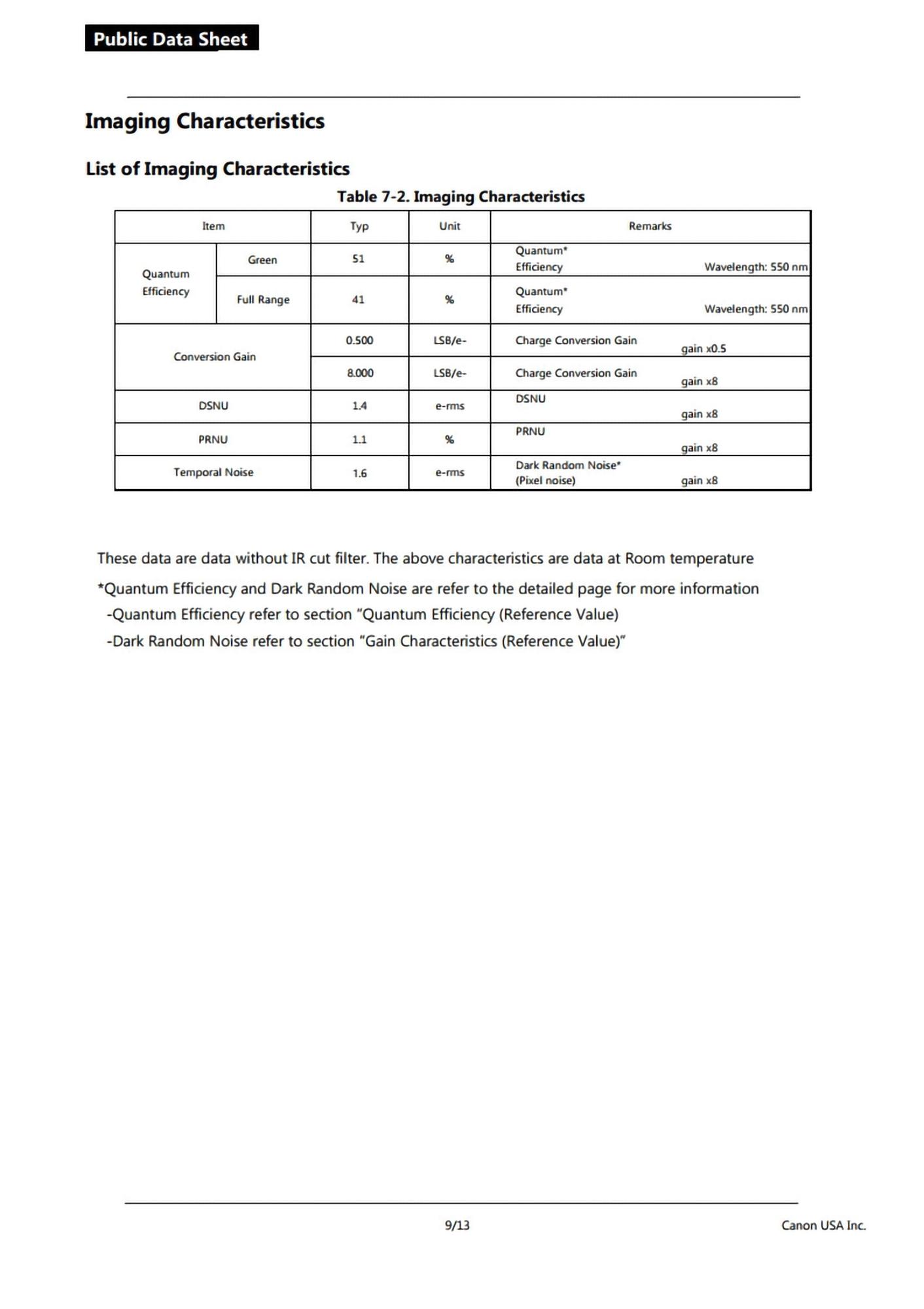

androidlad 62 Posted April 14, 2019 Author Share Posted April 14, 2019 26 minutes ago, Danyyyel said: I think the difference is that most of the electronics can be much smaller, thus leaving more space to the actual photo sensitive cells. 23 minutes ago, webrunner5 said: Yeah you can only cram so much stuff on a sensor. The smaller the stuff the more you can do. No, the lithography node (300nm, 90nm) refers to ADC circuitry, it has nothing to do with the photodiode and does not affect photosensitive area no matter how big or small the number is. It's the reason why Sony has achieved 16bit ADC on recent generation sensors. 12 minutes ago, Snowbro said: I am betting it will have around 13 stops of DR The datasheet actually tells you how much DR it has. Using the formula 20/6 x Log10(FWC/RMS) We can calculate that at ISO100 it has a pixel-level EDR of 12EV. Quote Link to post Share on other sites

sanveer 838 Posted April 15, 2019 Share Posted April 15, 2019 7 hours ago, androidlad said: We can calculate that at ISO100 it has a pixel-level EDR of 12EV. Not really earth shattering Dynamic Range for a Full Frame Sensor, especially considering that the ISO performance is also rather mediocre. Is this sensor like 2 generations behind Sony? Quote Link to post Share on other sites
androidlad 62 Posted April 15, 2019 Author Share Posted April 15, 2019 1 hour ago, sanveer said: Not really earth shattering Dynamic Range for a Full Frame Sensor, especially considering that the ISO performance is also rather mediocre. Is this sensor like 2 generations behind Sony? Quote Link to post Share on other sites
webrunner5 2,464 Posted April 15, 2019 Share Posted April 15, 2019 Wow that is just embarrassing to be honest. How can you be that bad in this day and age? Quote Link to post Share on other sites
Eric Calabros 227 Posted April 15, 2019 Share Posted April 15, 2019 5fps at 12bit is disappointing. Quote Link to post Share on other sites
Mokara 0 Posted April 15, 2019 Share Posted April 15, 2019 15 hours ago, androidlad said: For a 36x24mm FF sensor, 300nm vs 90nm process really make very little if any difference to image quality. There are more important contributors. CMOS sensors are not CPU, there's no constant need to shrink the die. There is if you want to add supporting logic. 5 hours ago, androidlad said: So, if EV 10 represents a minimum acceptable dynamic range, the Canon can go to ISO 1600 while the IMX455 can go to ISO 6400 and the IMX555 to ISO ~12000? Quote Link to post Share on other sites
sanveer 838 Posted April 15, 2019 Share Posted April 15, 2019 7 hours ago, androidlad said: Hahahahahahahahahahahahahahahahahaha. It IS 2 generations behind Sony (or 4). Maybe Canon should just put aside their ego, and just pick up Sony sensors. The difference 12 and 15.5 Stops is HUGE. Plus that 16-bit advantage would help push shadows and highlights like nothing else around. Plus this sensor would easily outperform most (or all current) Medium Format sensors (atleast in that 60MP resolution equivalent chart). webrunner5 1 Quote Link to post Share on other sites
