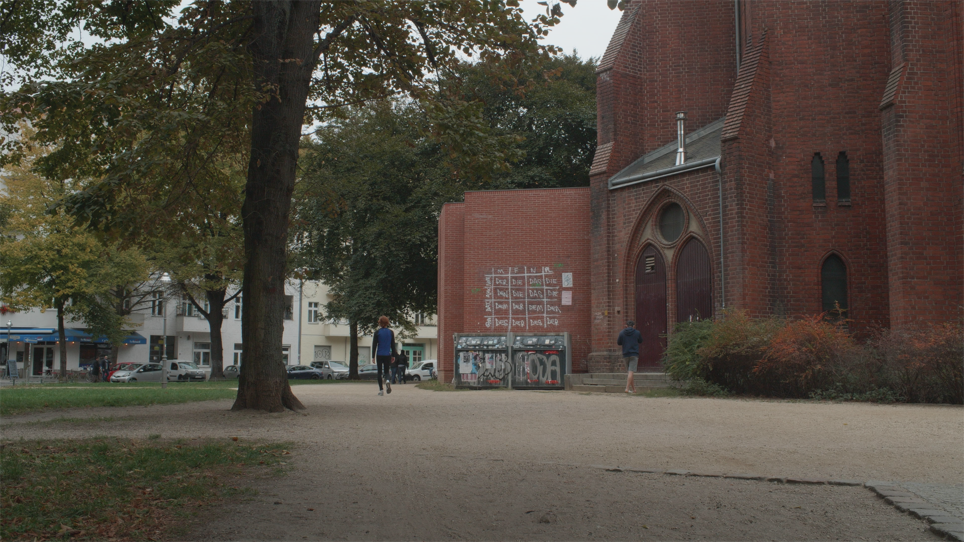

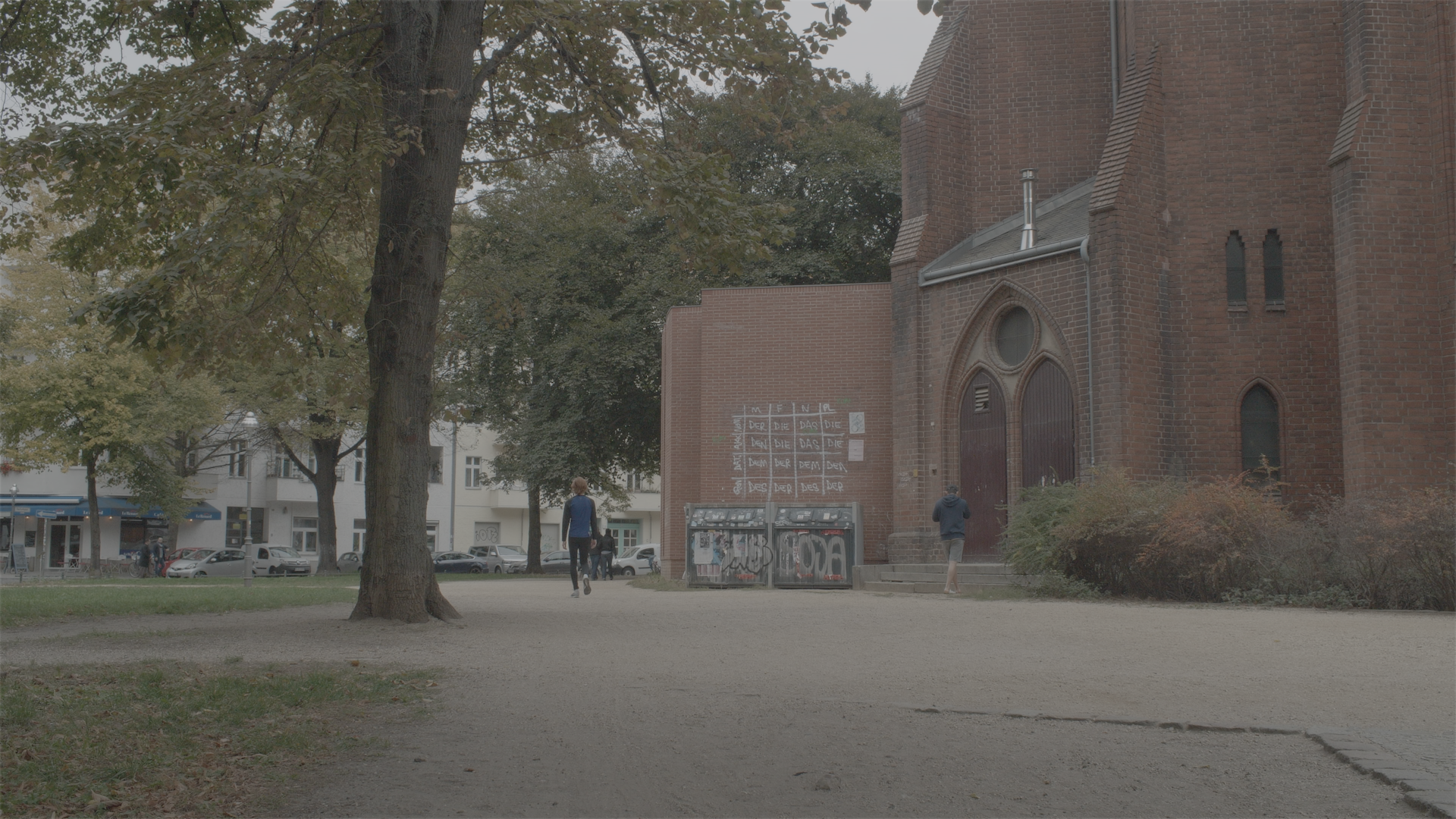

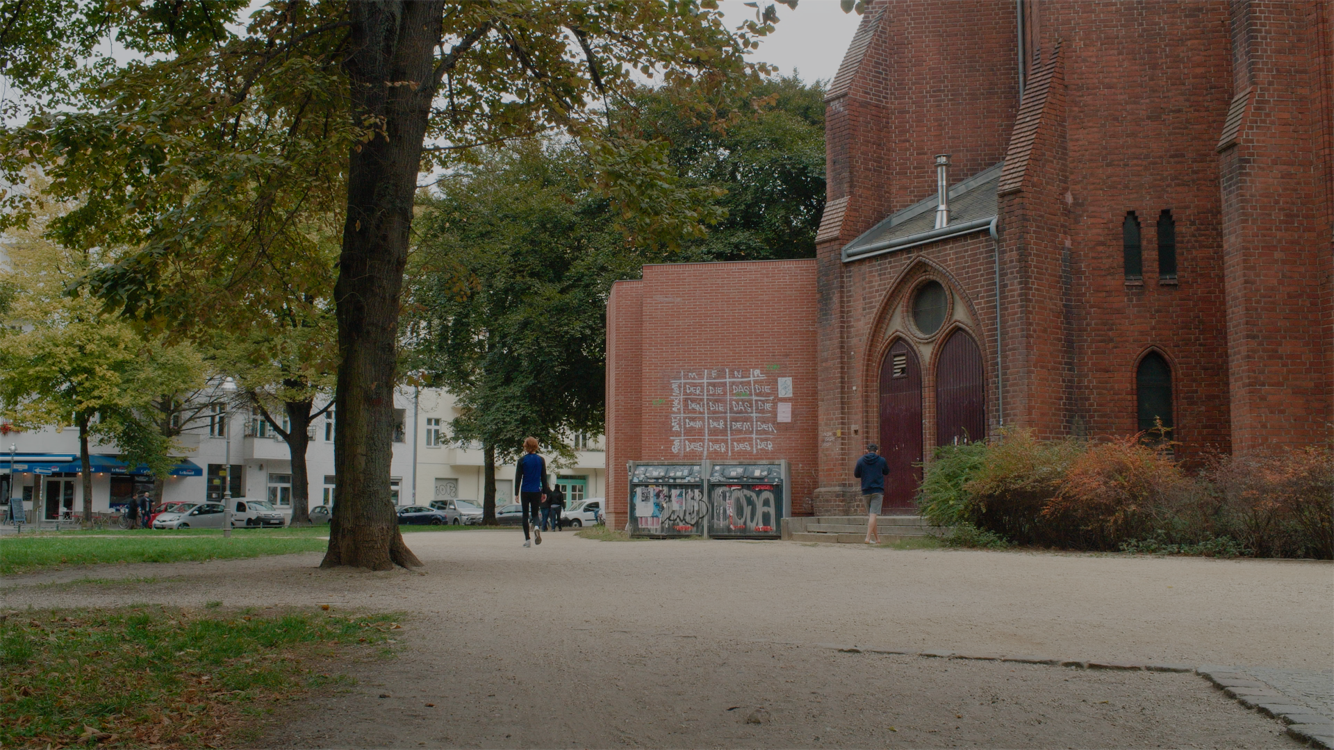

hypp Posted October 7, 2018 Share Posted October 7, 2018 Someone just uploaded some footage comparing the BMPCC 2K, 4K and GH5s and I would like to see how GH5s footage using this lut compares to BM. Could someone test grade this using this lut? Filename: P1034641.mov Much appreciated! Link to comment Share on other sites More sharing options...
Sage Posted October 7, 2018 Author Share Posted October 7, 2018 3 hours ago, hypp said: Someone just uploaded some footage comparing the BMPCC 2K, 4K and GH5s and I would like to see how GH5s footage using this lut compares to BM. Could someone test grade this using this lut? Filename: P1034641.mov Much appreciated! Sure, here you go - these are the raw conversions (last is the default V35 look-up for reference) LogC Soft Main Linear Varicam webrunner5, hypp, TurboRat and 2 others 4 1 Link to comment Share on other sites More sharing options...
